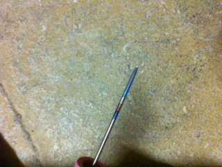

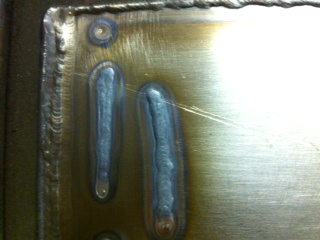

Thanks for the replys! Sorry its taken me a while to answer, busy weekend! Here is a pic of the welds, there is one spot test weld on the right then a weld with no filler wire at the top and the one at the bottom with filler. I think the gas is flowing fine. I put a new tungsten in before doing those welds, i didn't touch down and it turned out like that. Its all a bit strange! ( i know the welds are a bit wobbly, did it in a hurry lol)
Unless some joker has swapped your bottle of argon for a bottle of argon/CO2 i'd start looking for a gas leak... leak draws in air when the gas is flowing, the tungsten gets oxidised as result and spits bits of itself into the weld.
Favorites include a dodgy back cap O-ring, a torch assembled ass about face or a leak in one of the hoses (hose clip cut through the line/pinhole somewhere/loose connection to the gas solenoid etc).
I will check it all tomorrow (not sure how tho!) when I get home. So it that the only thing that will make the tungsten look like that? There is defo gas coming out, have it set at 6-7lpm on the flow meter & have 6second post flow & tungsten stick out of about 3-4mm. What is the best way to check for a leek? Thanks for your replys!
Pretty much, heat metals in air and they oxidise. Tungsten goes through pretty similar 'heat tint' colours as steel/stainless- grey and scaly follows blues. Contaminating 'em with whatever's being welded will also discolour 'em but typically only the very tip and turn it the colour of the metal being welded like these obvious blobs of stainless... http://www.mig-welding.co.uk/tig-technique/contaminated-tungstens-large.jpg

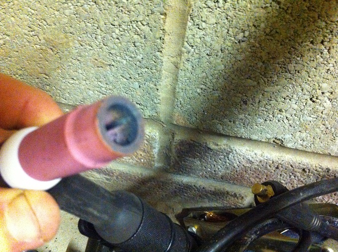

Start with the O-ring on the back cap- look for damage and/or replace. Assuming the torch is correctly assembled check the insulator for damage- the white spacer between ceramic and torch. Can use a leak detector solution (or soapy water a small paint brush) to check the hoses. A leak between the reg and welder will prevent the system from holding pressure* with the cylinder valve closed. Visual inspection aside obviously the machine needs to be powered up to check the torch lead so worth turning off the HF (to avoid getting a tickle) and unplugging the return lead. If none of that fixes it then post again as it'll be covers off to check the internal gas connections- simple enough but you still need to be careful of what you poke even with the machine switched off

So, i have checked over everything and cant find any leak, however where the hose goes into the back of the machine the case is very cold, not sure if its just because its next to the fan or wheather the leak maybe just inside the machine, so i will open it up at the weekend to check!

A leak still seems to be the most likely cause, where are you measuring your 5lpm, you need to check what you are actually getting at the torch, a pea shooter like this is worth having clickme. lenses wont cure basic problems, in fact for most DC work I rarely use one, pull the side off the machine and check out the connections to the solenoid and the back of the connector where it exits to the torch connector.
