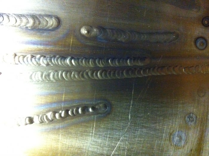

The only cause is oxidation.Just out of interest what could be the other possible cause of grey welds and a heat tinted tungsten?
Lots of things can result in that happening to welds as the torch is moving so the hot weld is only under argon for a little while. Stainless turns golden/straw at around 280C, as the temp goes up it gets darker through browns, mottled purple/brown, purple then blues at around 600C and then grey. If heat and speed aren't balanced (too hot/too slow), arc length is too long (heat input goes up) then you get grey welds. As long as there's enough postflow* and no leaks etc then the tungsten will remain clean and shiney
As Paul, a gas lens won't fix this. They provide better shielding but only tend to fix problems when lots of stick out is needed or weld geometry creates vortexes that pull air in messing with shielding (in the later case it typically effects only the work, not the tungsten)
* 1 sec/10 amps is a very rough guide for postflow (watercooled torches need less than air cooled typically from the tungstens POV). You can see the tungsten oxidise if you're watching it and counting out the post flow
Oh, random thought... not something daft like welding in the 'firing line' of the welders fan or any other breeze/draft etc?
