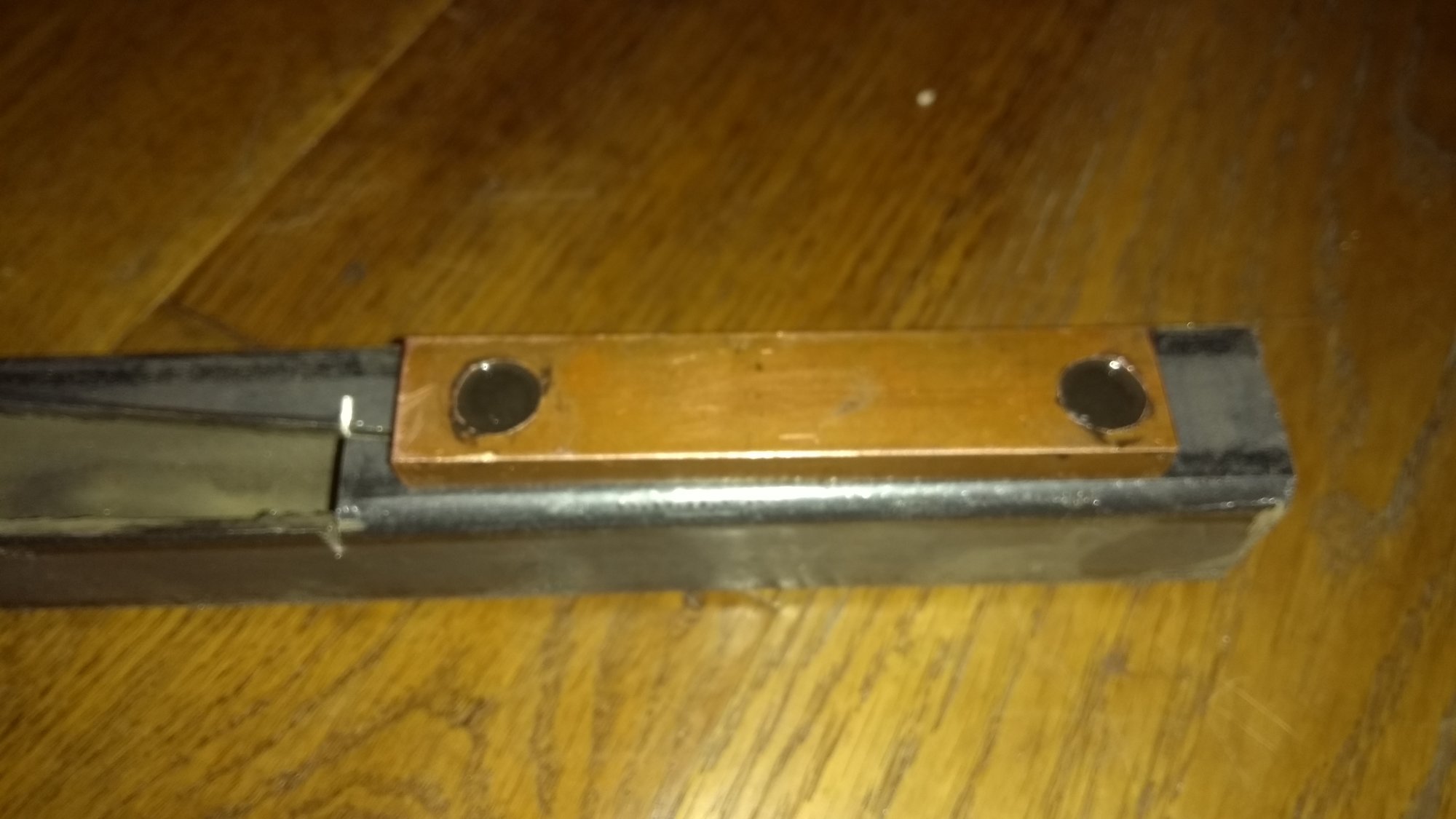

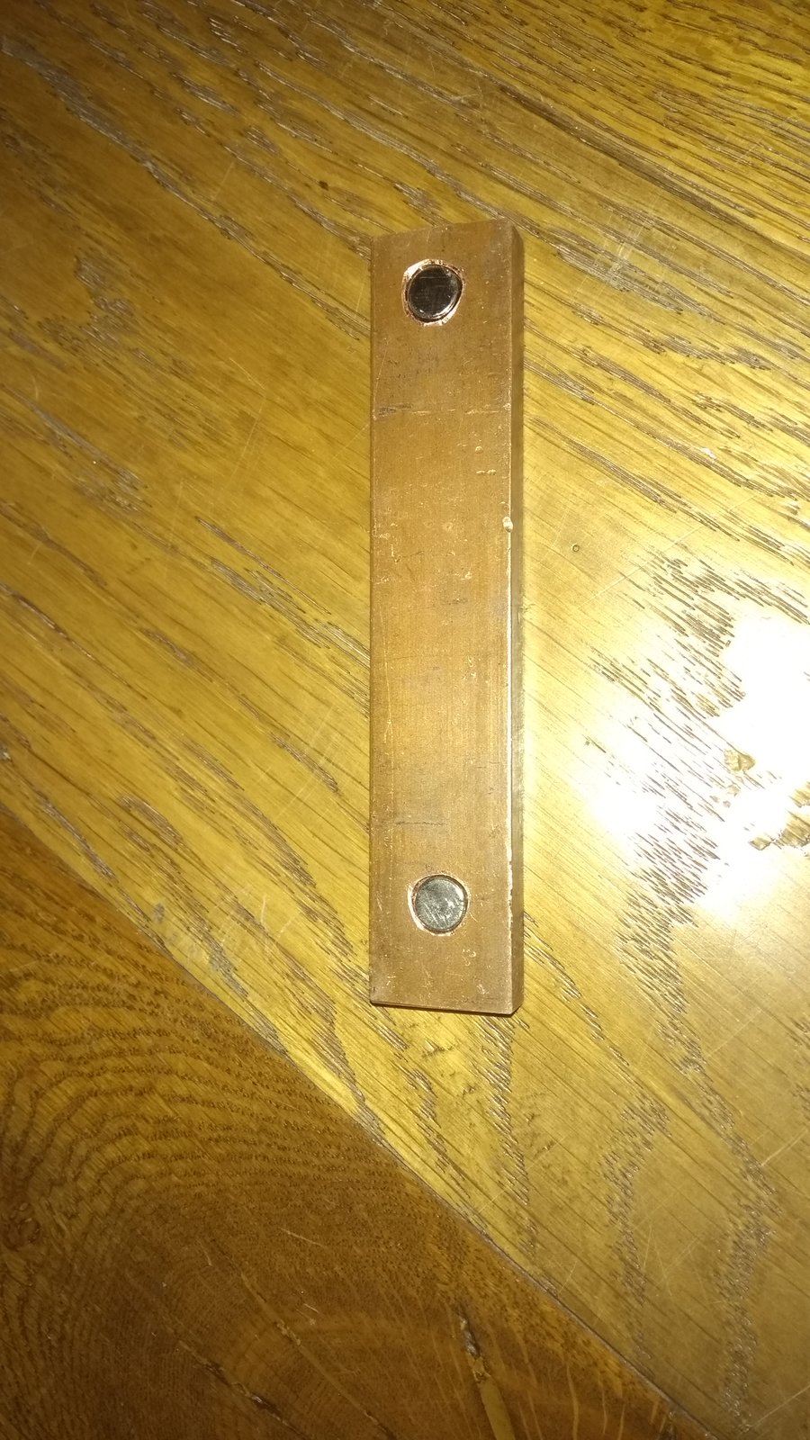

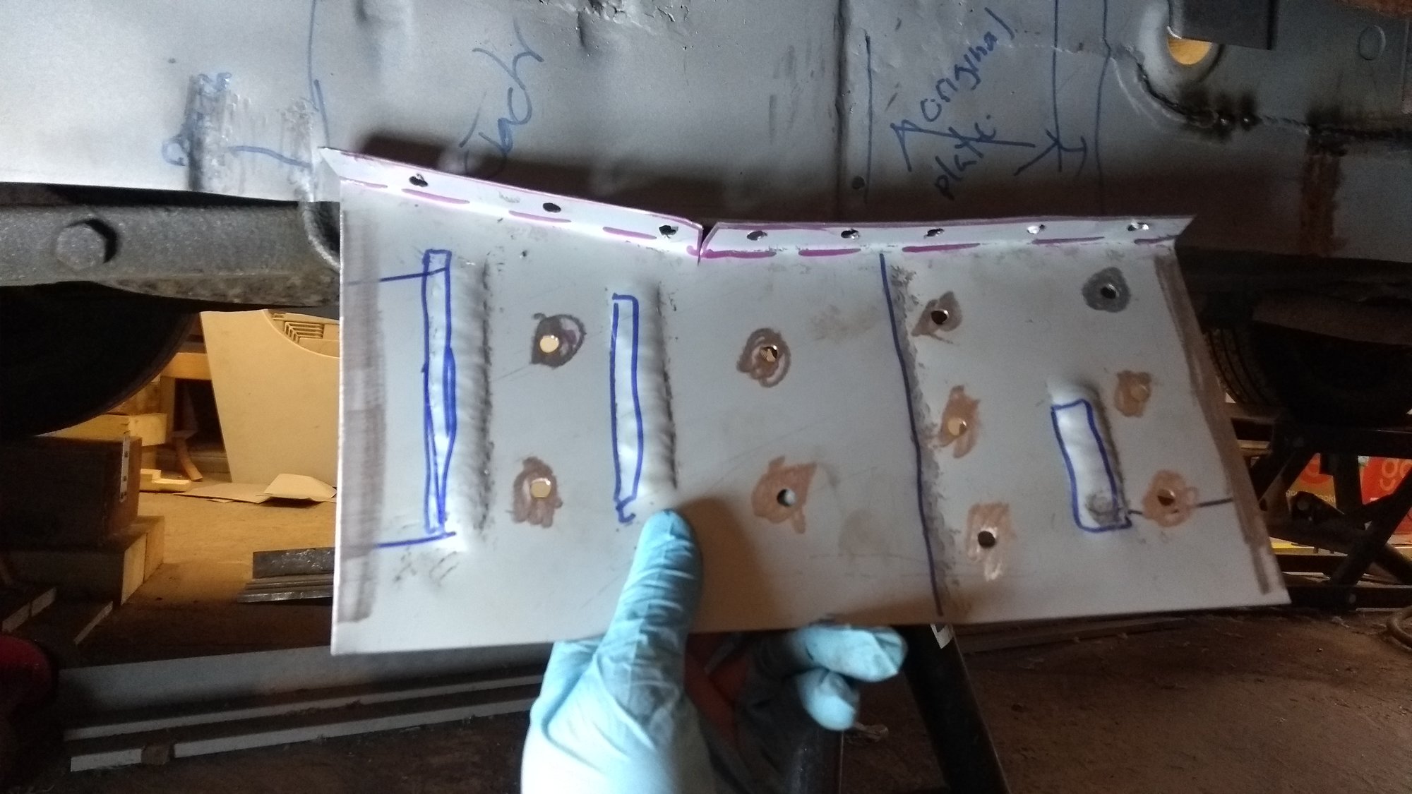

In the mean time I've got on with something I've wanted to try for some time. Doing butt welds on floors is difficult as sometimes you need the help of a copper plate but there isn't any way of clamping the plate....half the time I just make do...the other half I hold it in the other hand which isn't ideal.
This is a prototype...it's a copper bar with 2 top hat shaped strong magnets. The back is just epoxy glue to stop them falling out the back. The steel is to ensure the magnets make good contact while the glue sets.
Will post how useful it is....problems I can foresee are...the glue and or the magnets getting destroyed by the heat. Or the magnets being so strong they interfere with the mig...steel plasma....magnets...hmm. I'm hoping that if I keep the active weld in the middle of the bar it will still be of use. Only one way to find out I guess!
I picked the weakest magnets I could find which would hold the copper bar on...
