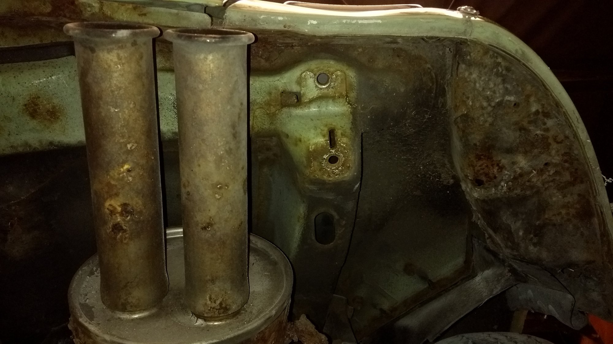

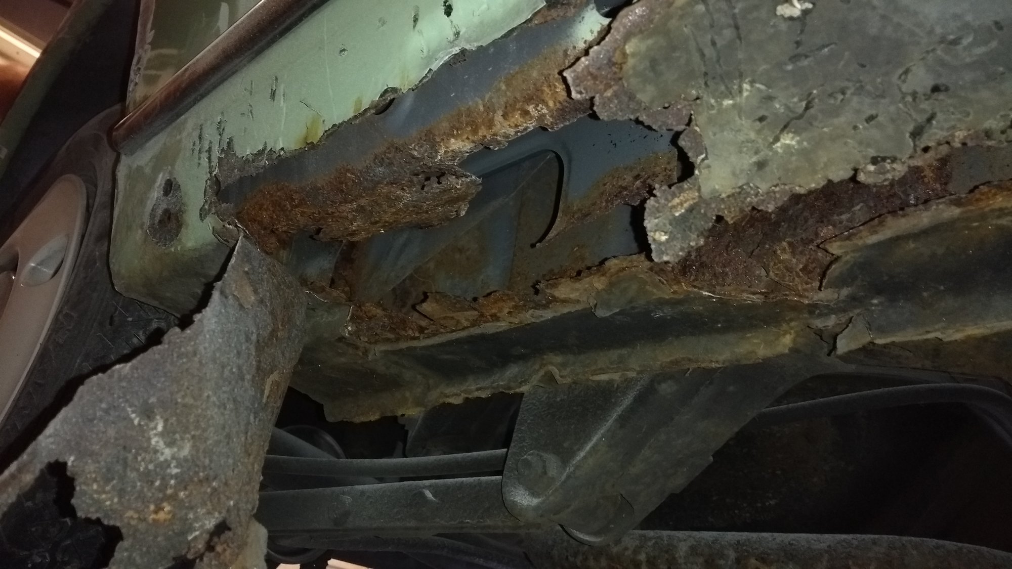

I could only see one weld repair underneath....if this is how he welds then perhaps it was best to stick with filler. I think it's mig but it could easily be stick welding! The weld it to the right of the pic with a patch behind the rear arch.

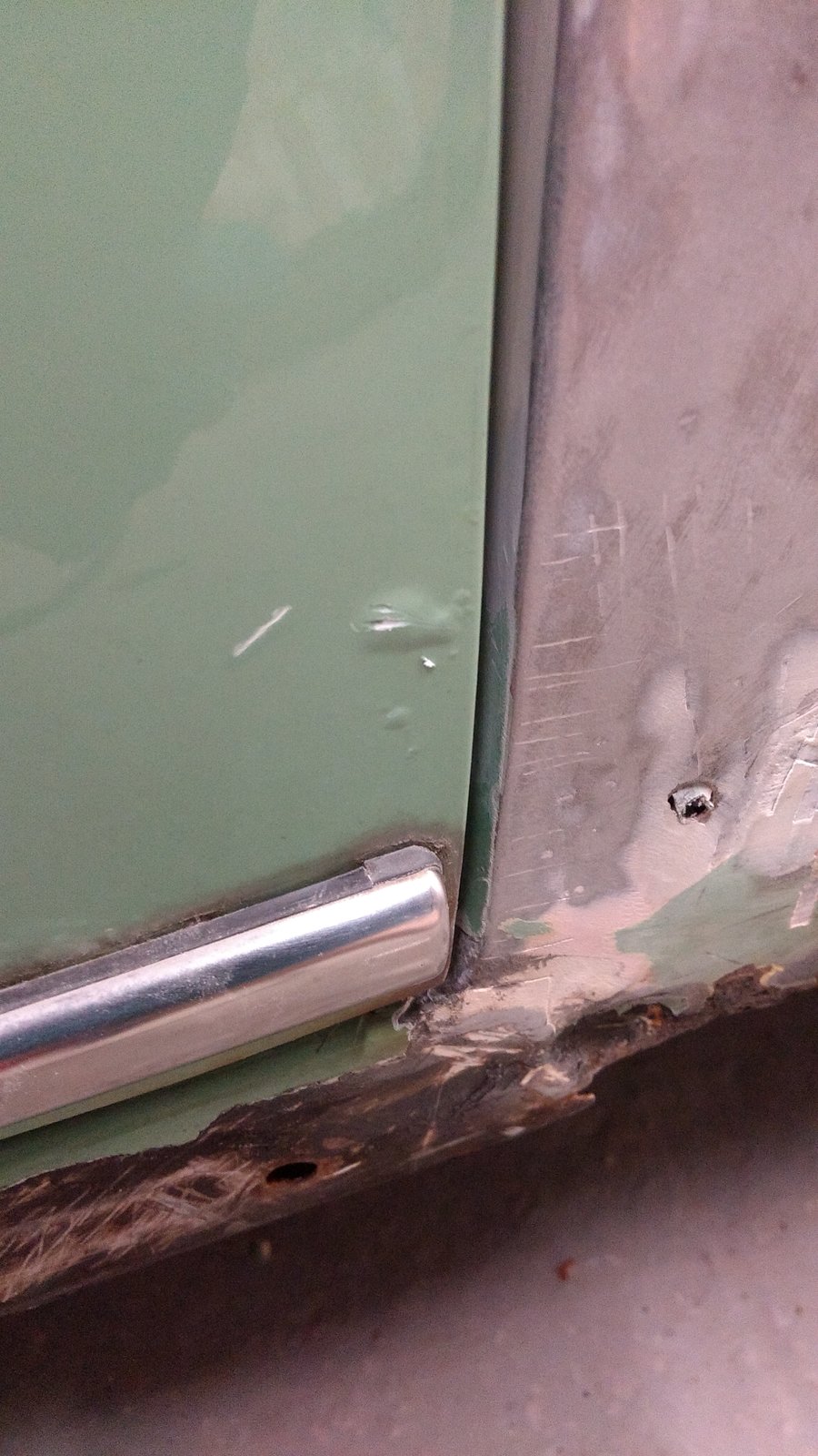

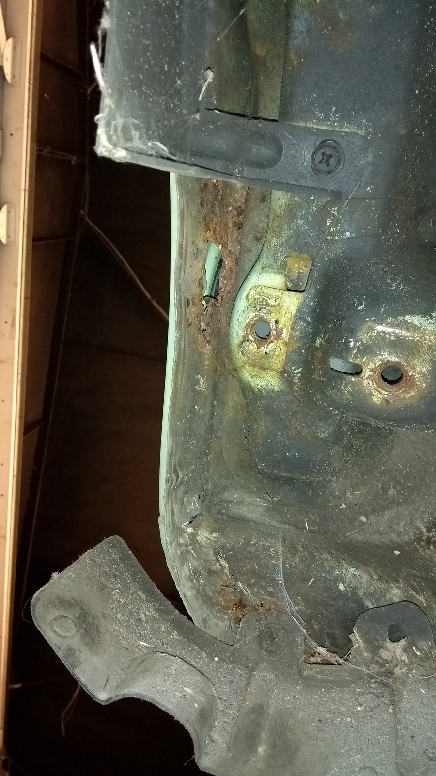

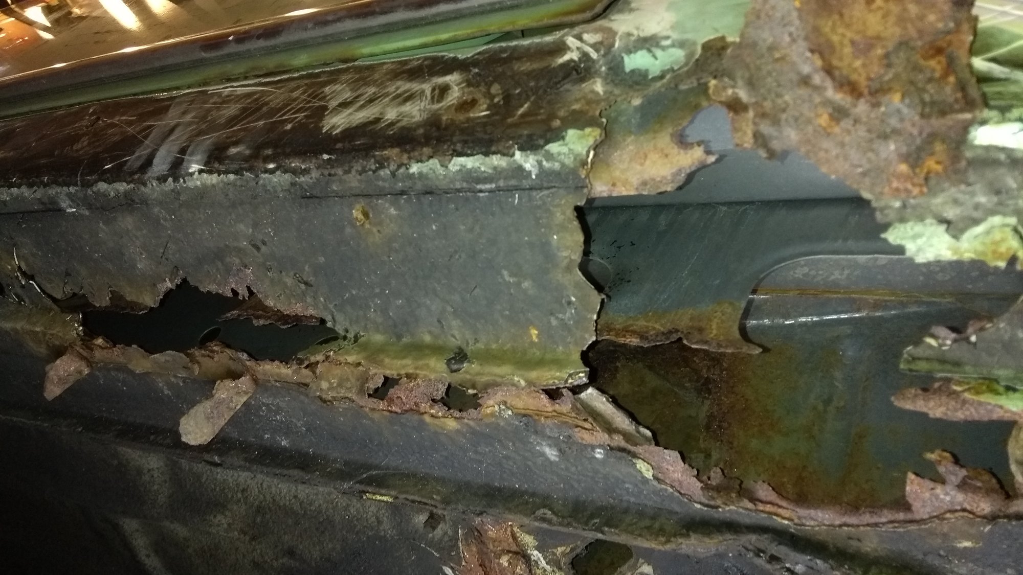

The sills look pretty terrible but I can see good metal underneath the rust so maybe there is some hope...I could see some evidence of welding/repair....will find out more I guess If/when I start cutting.

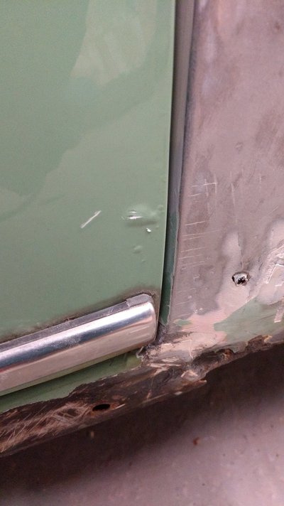

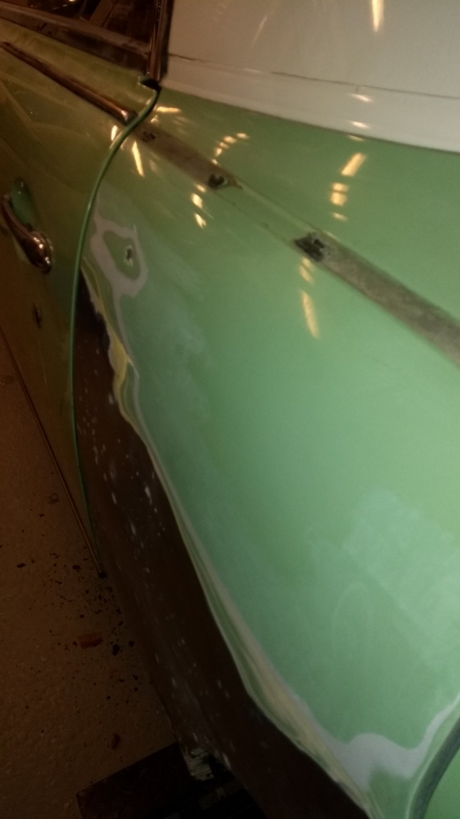

Almost forgot...What's this strange lump on the passenger door. Yep you've guessed....it's full of filler too! It looks like this panel had a bash at some point which might explain why the door gap is a bit funky....I think that the rear quarter door edge was probably crushed. I imagine I'll find some filler in there too somewhere.

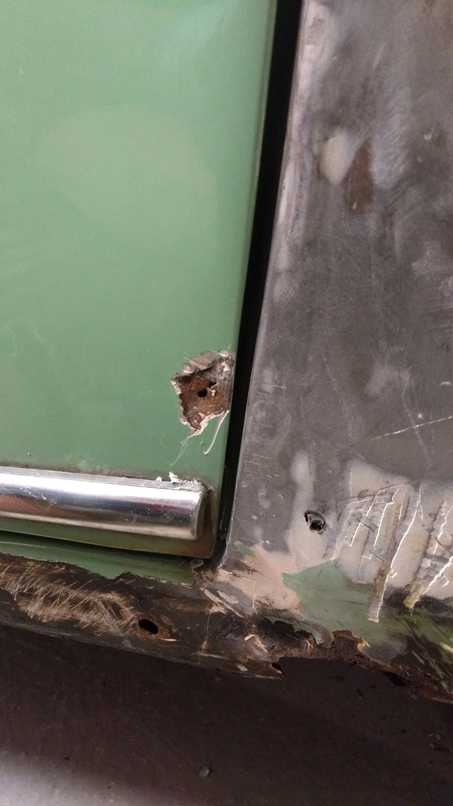

After dinner I went down to the garage and tweaked the door closer (door strike...that thingy on the inside!)...the fit is now very good at the top and out at the bottom where the original dent was. Think I'm happy with it....I'll sand the filler off the door to see where it ends up but I reckon most of the problem here is that the lower part of the panel has been straightened very badly.

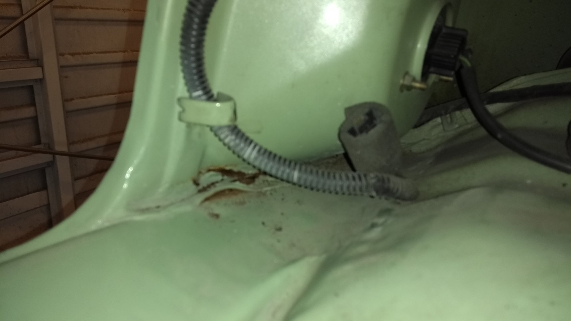

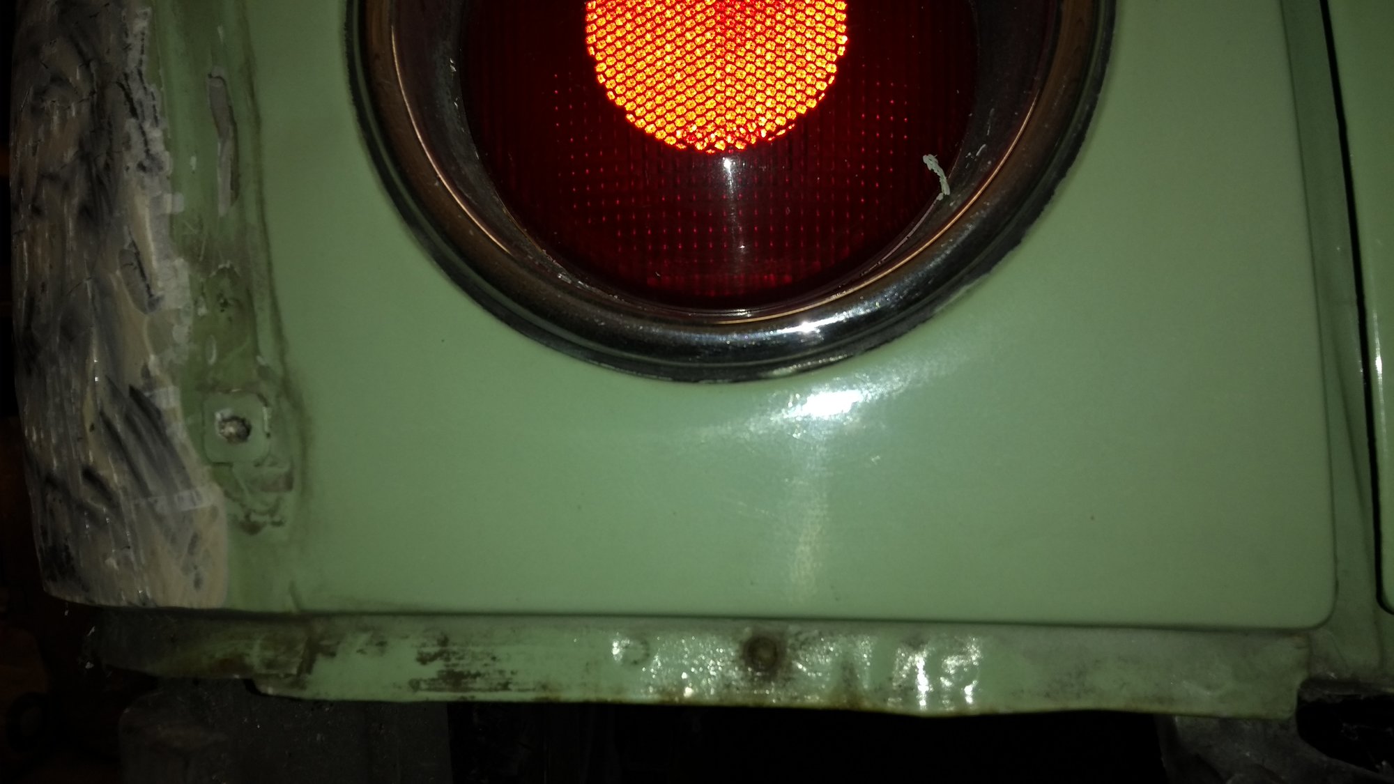

Came across this small hole in the rear floor area. The problem is there isn't any access ....other than cutting a hole in the front. But the lights have an inner skin too. Going to be tough to fix this properly I think.
Looking and thinking about it I think it's a triple layered joint where the outer panel, the floor panel and the light surround all come together along that lower flange....gulp!

Just a small smear of tiger seal and the problem would be hidden from view for at least 2 years
