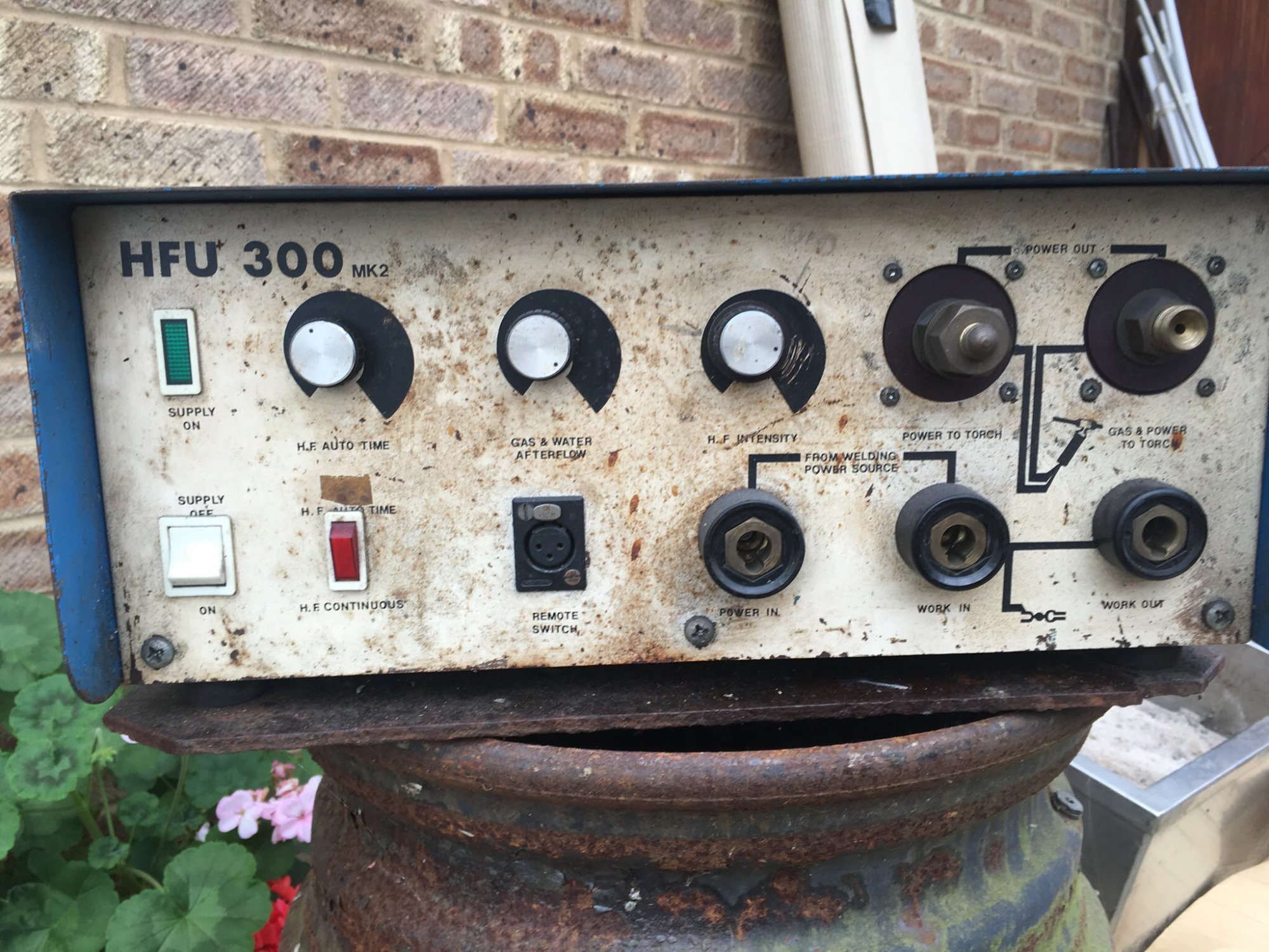

Having acquired the High Frequency unit from a member here the mission is now underway to build myself a AC DC TIG machine. I will qualify at the get go that I'm not a proffesionionl welder, Infact im not even a good welder but I can stick metal together.

Well on with the HFU

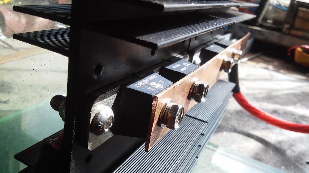

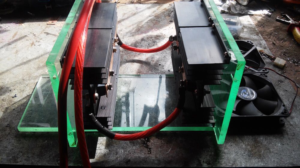

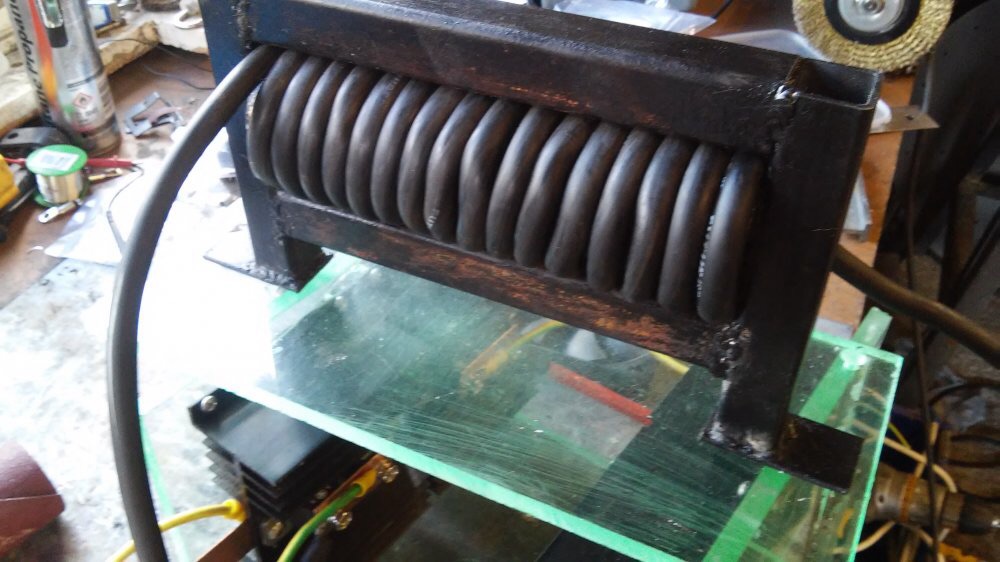

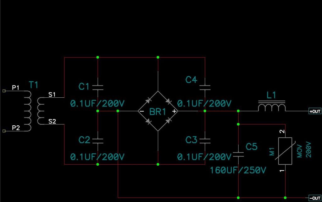

Need a DC source for welding steel and SS, so been very busy reading about this, had a consultation with an electronics engineer mate, not on this forum and ordered the bits to make a full wave rectifier p
