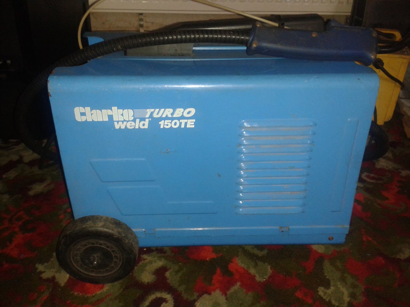

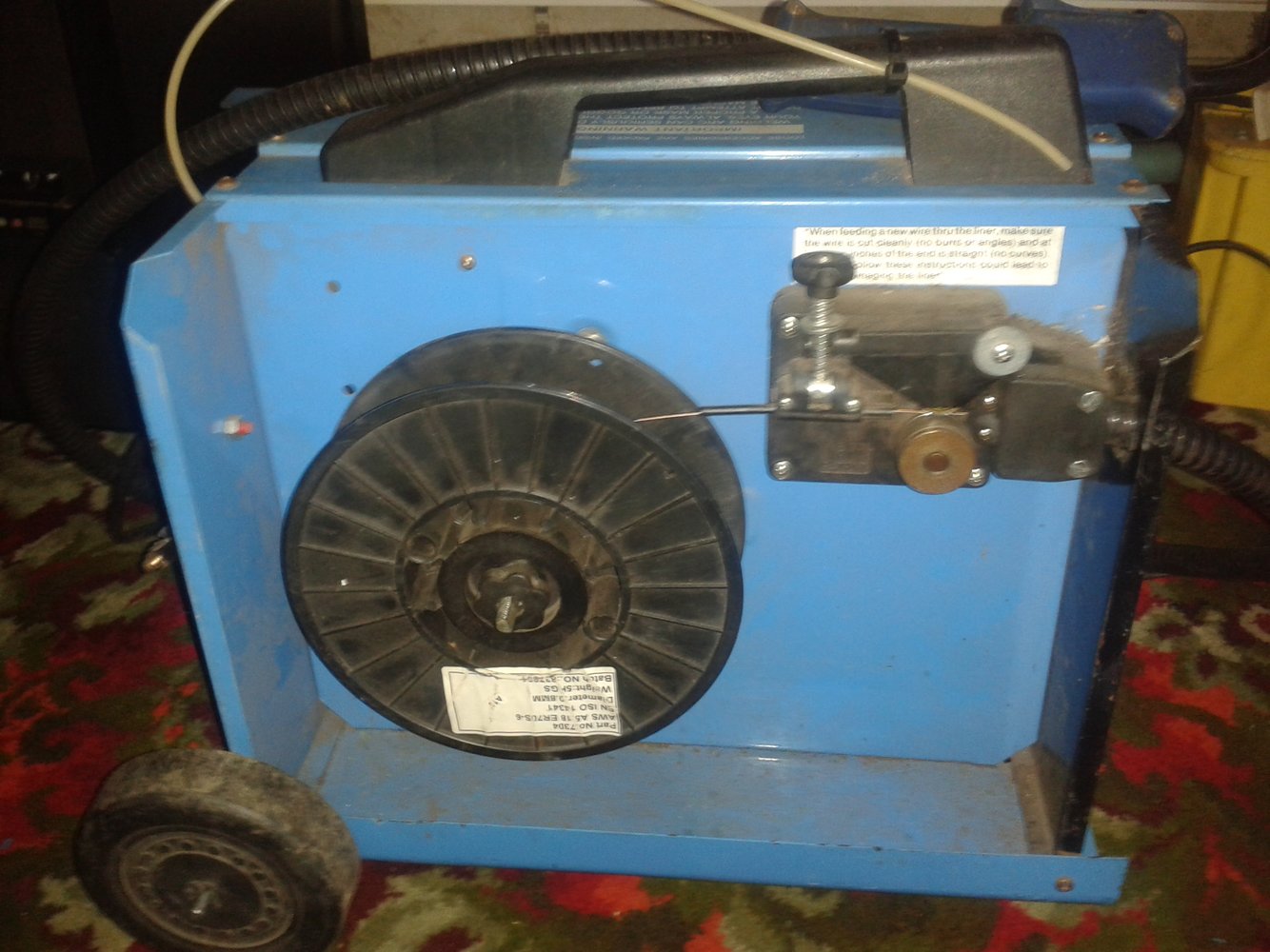

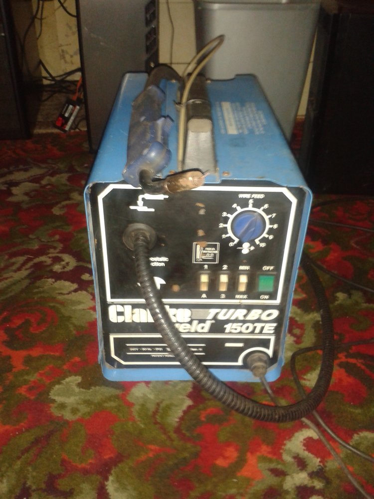

Even with my cheapie Clarke Gasless I was always concerned with storing it so it was protected from Damp and damage. More so now I've invested in a new Inverter MiG.
My shed/workshop is basically dry/good - but in the Welsh Winter (any season) weather, humidity/damp air is pretty much a constant, and I want to look after the kit.
What I do atm is the welder resides on the homemade trolley with Gas Bottle to rear. I've made a thin ply drop-over box that fits over the welder (a bit like a sewing machine idea where the box gets lifted off the base for use, but with a separate opening on the front so I can stow the Earth Cable & my welding gloves inside after placement).
Inside the box, I place my homemade "Dessicant Pack" - which is just a section of the Missus' (honest!) Tights, filled with Cat Litter/Oil Dry and tied closed.
I'm wondering if anyone has any better ideas (short of keeping the welder in the house, when my welding wire already resides in the Airing Cupboard
I could add a small vivarium type heater mat or panel heater if that's thought to be a worthwhile modification
