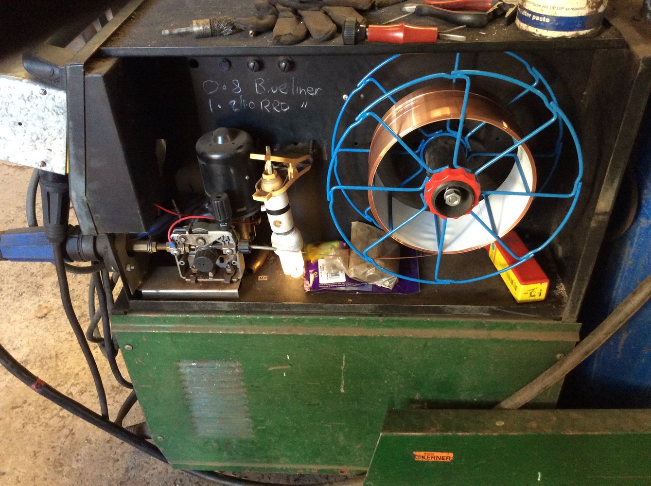

We fit anti-condensation heater mats in the alternators of some standby gensets in work, so i thought about using one of those under the wire reel as they are nice and flat.on my MIG I fitted a protected bulb holder and used a 11w spiral flu bulb...left it on 24/7......
got sick of thowing away rolls of rusty MIG wire.....my workshop was always damp due to being a converted water mill....
worked for me........including the same for all my machines..........

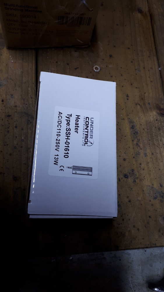

50w 230vac - so might be just the kiddie?
