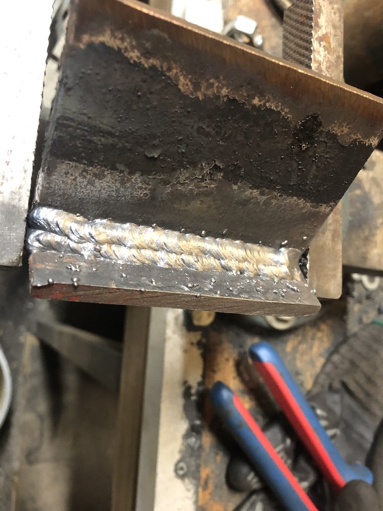

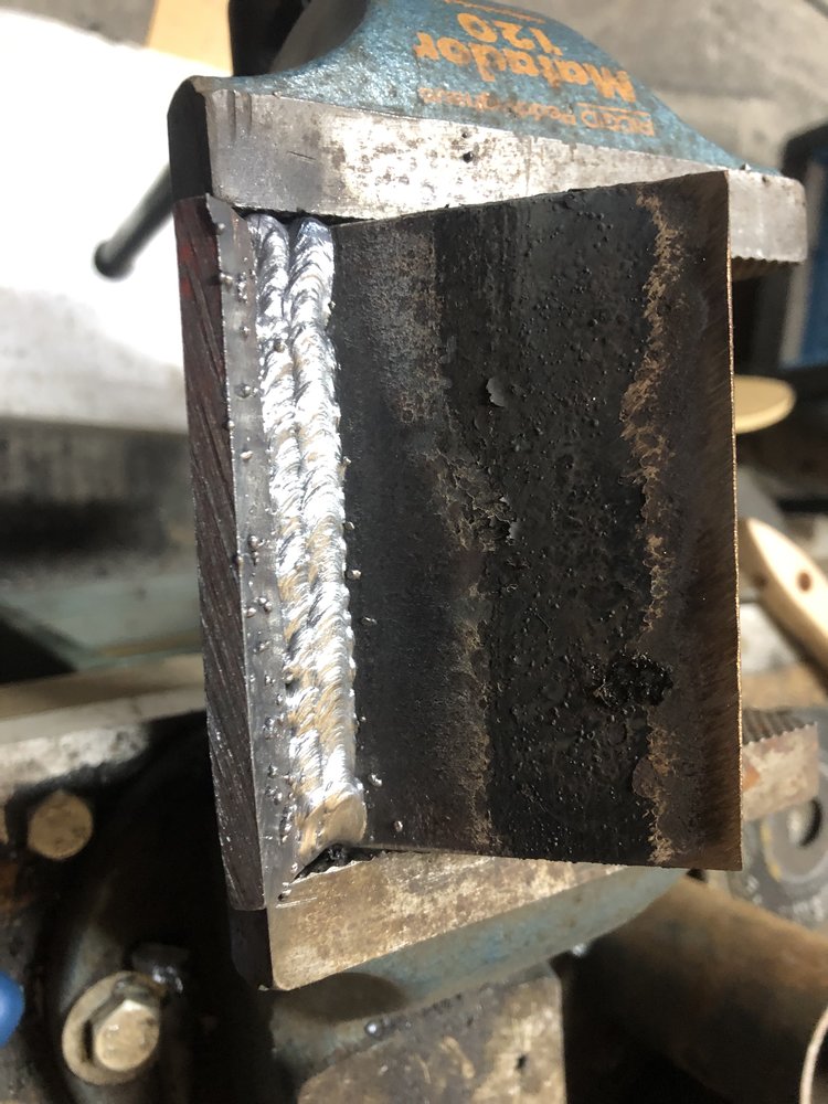

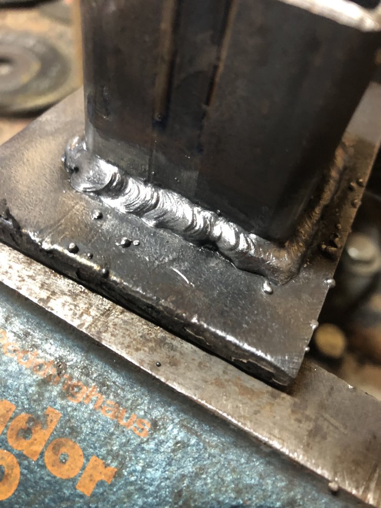

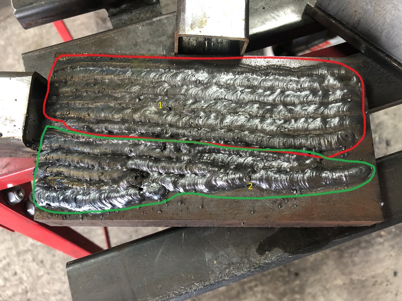

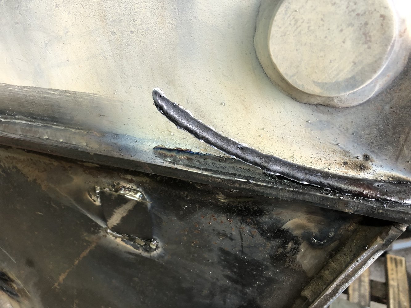

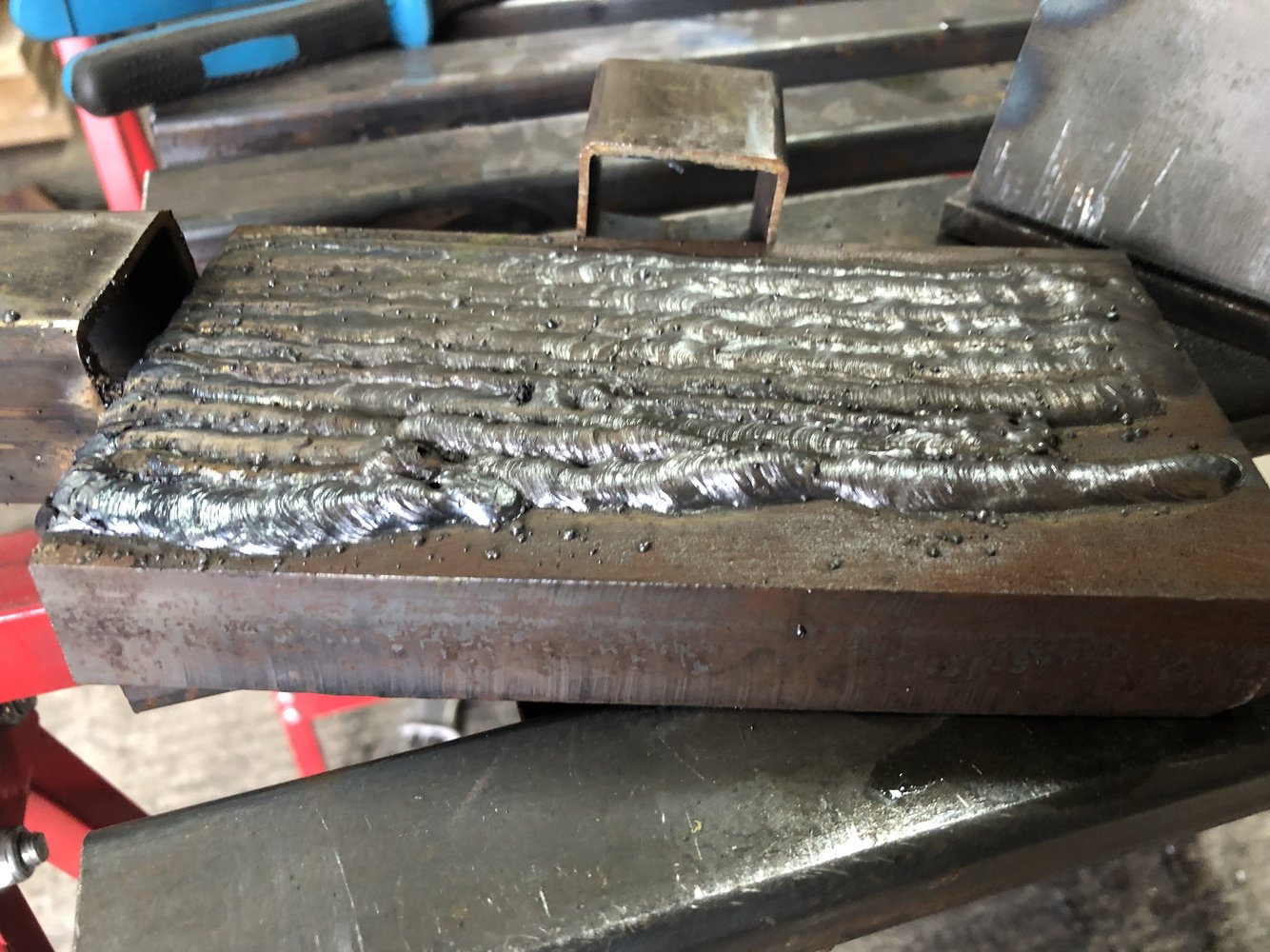

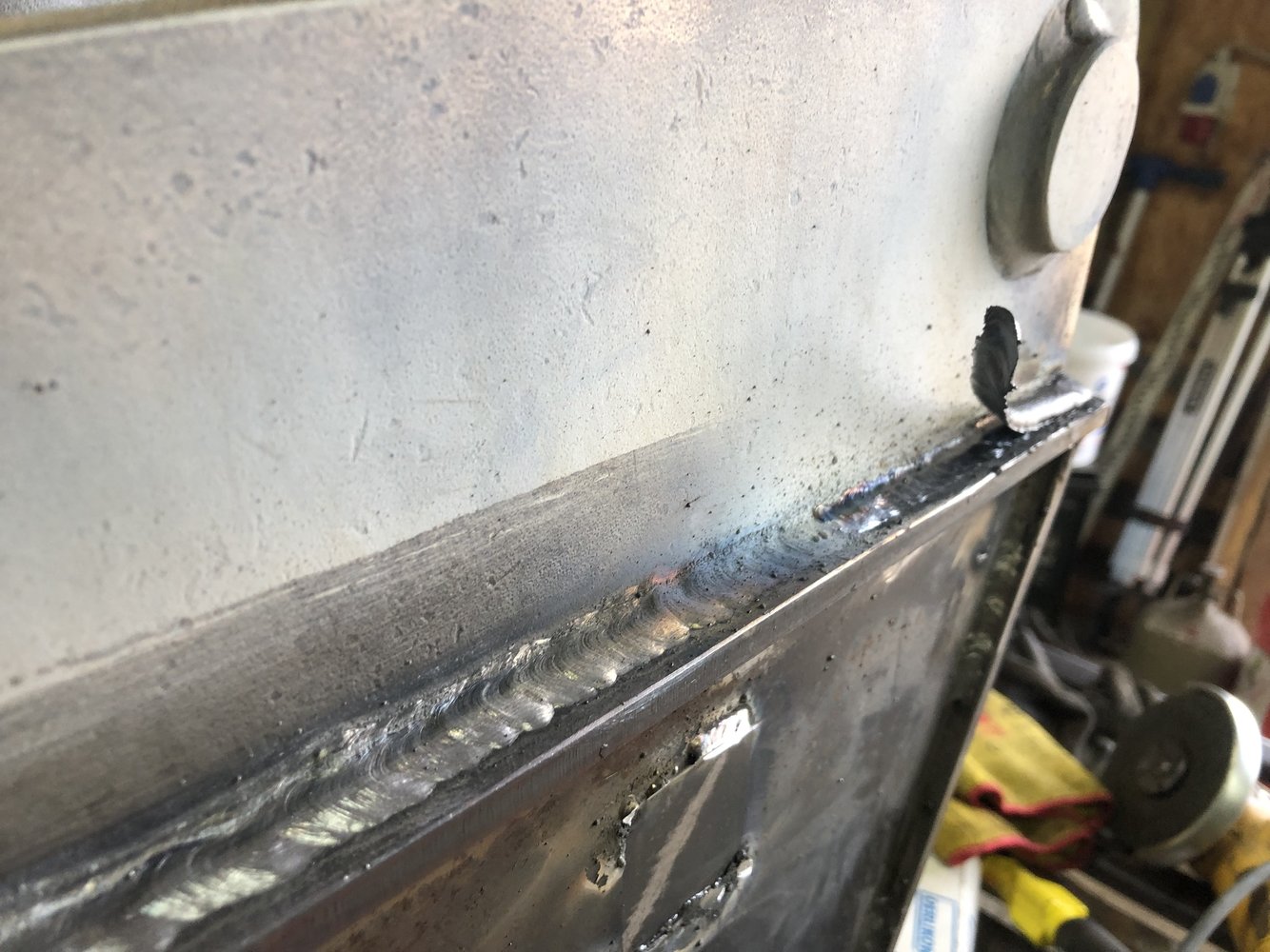

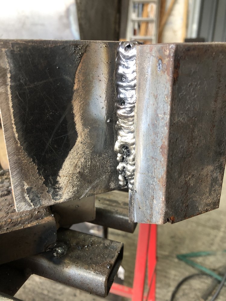

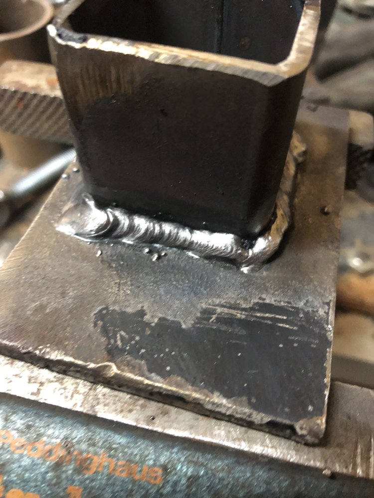

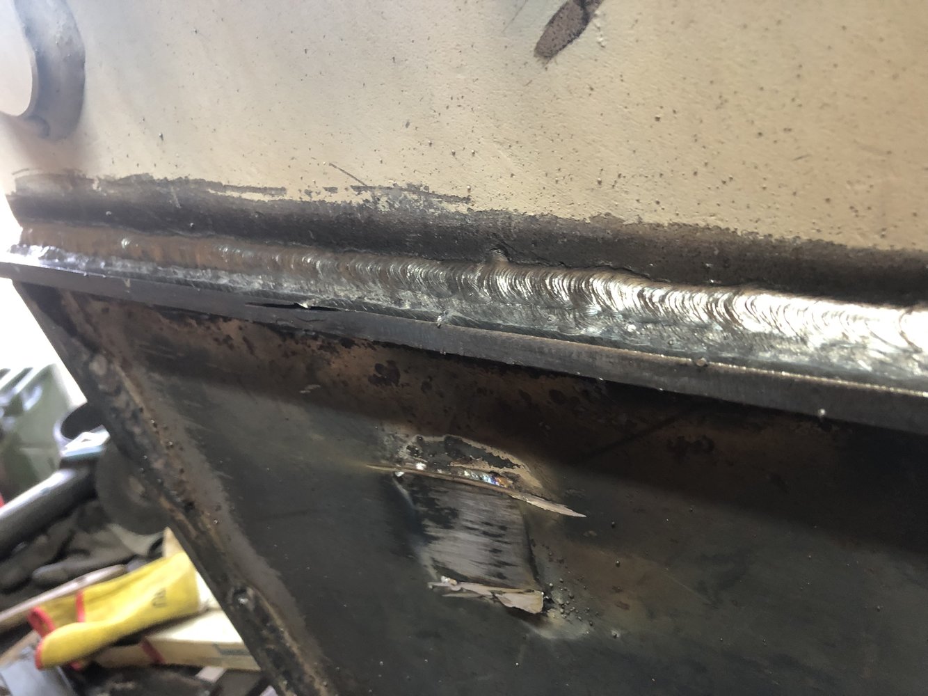

Here are some pics of my testing material. One plate of about 20mm thickness and 2 scrap pieces of 8mm.
On the plate i began with esab es 43.32 3,2mmx400mm (6013) on DCEP as label says. running at about 120 amps +/- Fig 1

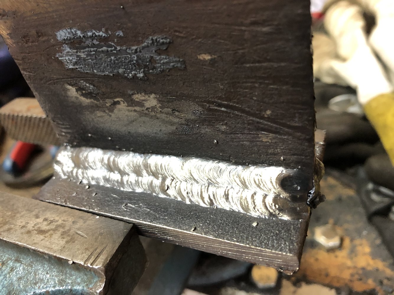

In Fig 2 i tried to do the same with my 2.5mm rods. Also 6013.
So i switched polarity and off it went.

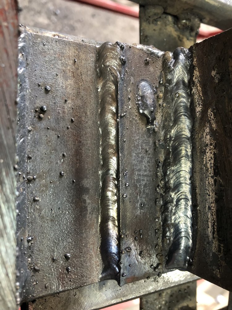

I used Oerlikon Overcord and Böhler Phönix blau.
With the esab rods the slag was self peeling
I ran the 2.5s with +/- 80-90 amps
I tried to work on my rod position and played with arc length.
Now i am curious what you think...
