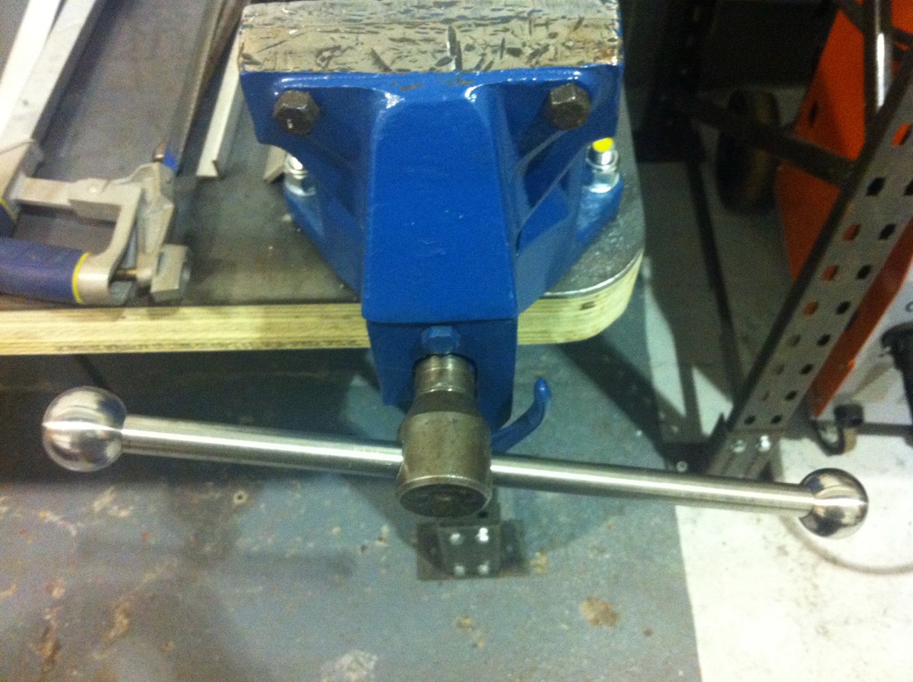

A piece of bright steel would be my choice. Abit tougher than mild, and dimensionally a lot truer.
The bar on mine was well past its best when I got it, so I used some 316 and got a couple of ball ends off eBay.
