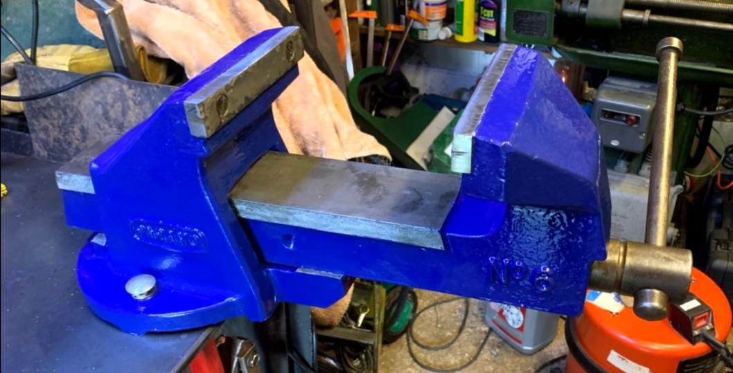

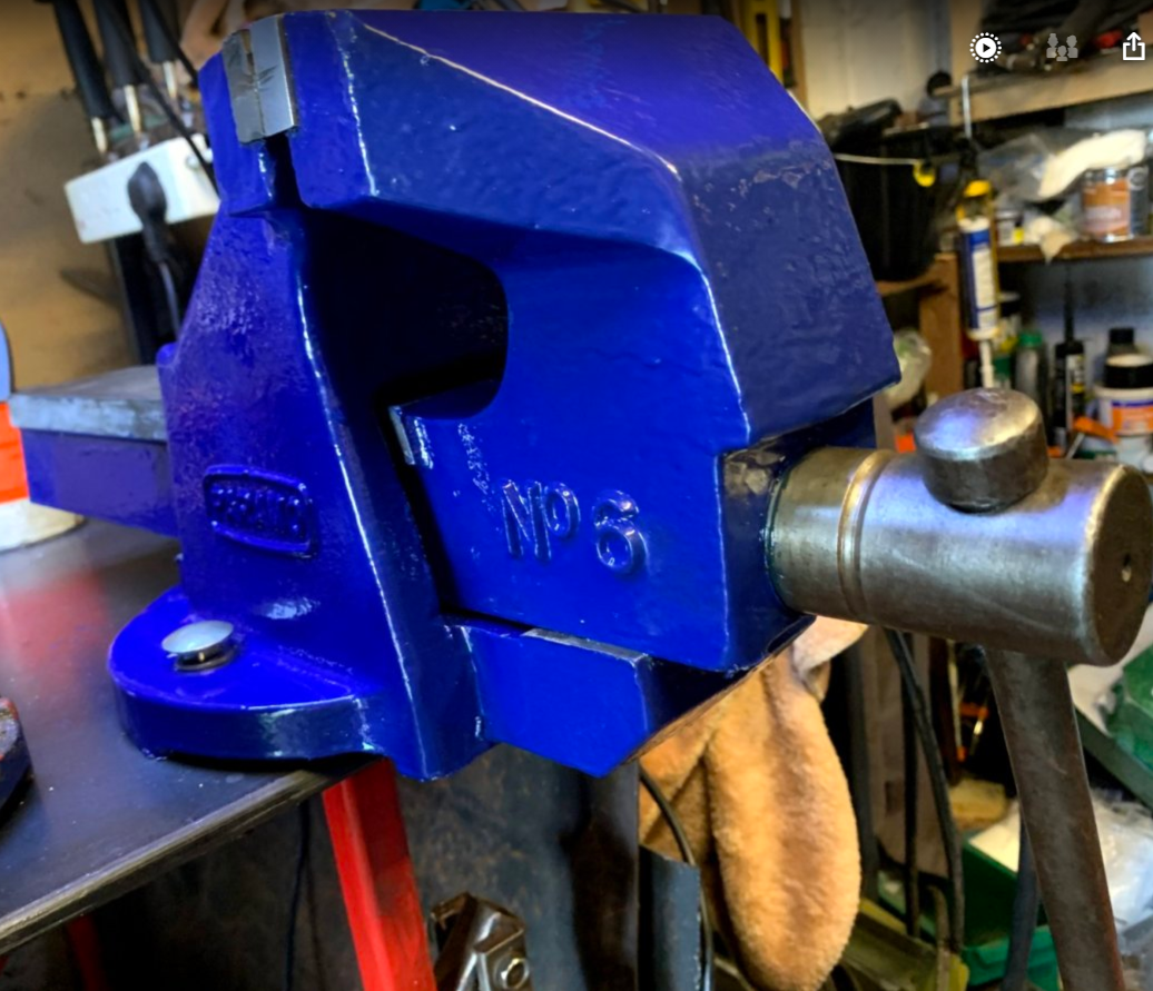

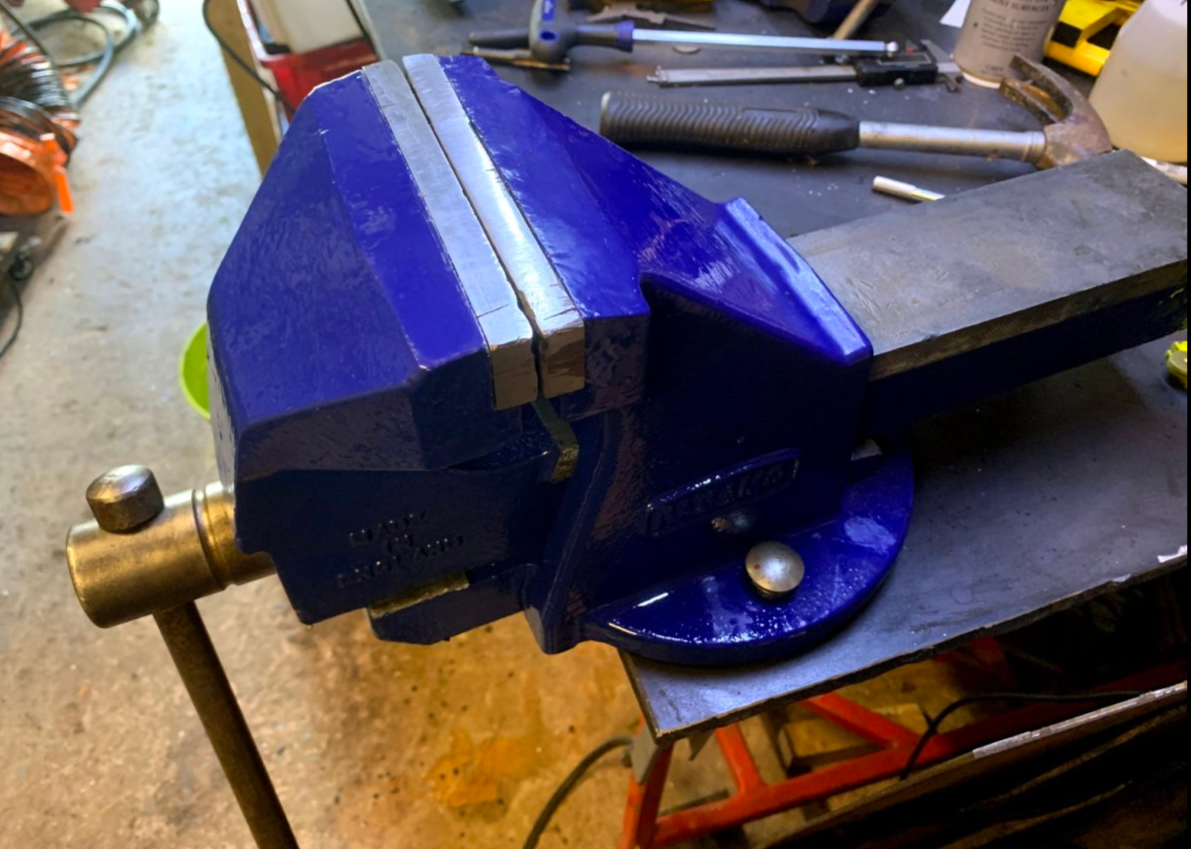

Hmmm.... looking at the pics from the comfort of my kitchen that looks like too much of an overhang - I'll likely move it back three inches or so...

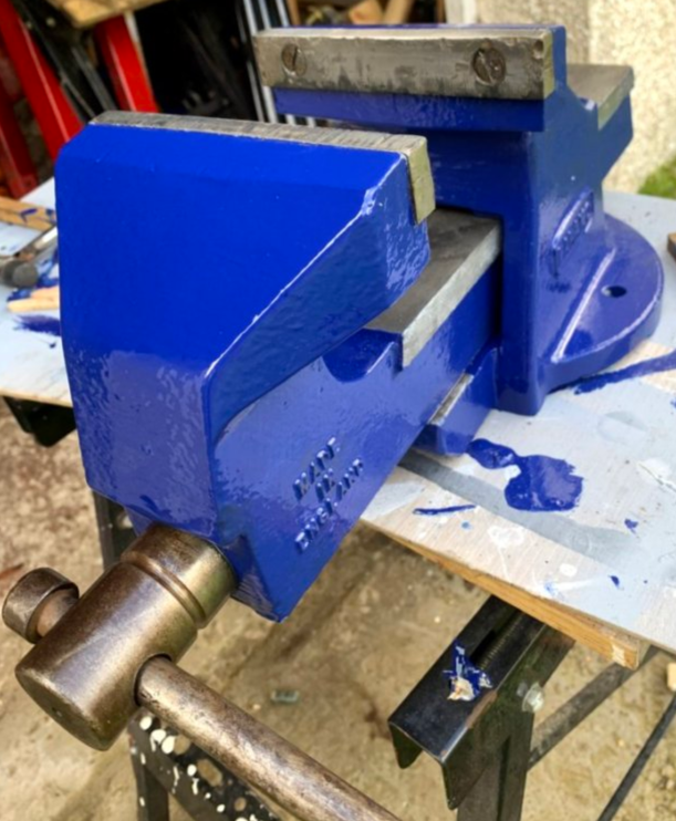

Ah - good point.But if you look at pic 3 in post #22, the rear jaw wouldn't be clear of the bench front then, for working with perpendicular work pieces.
And get some real fixings, those look awfulBest way to gauge mounting position is to clamp a long rod vertically within the jaws, & site the vice so you just have a gnats clearance between the front of the bench & the back of the rod.
Oh, & line it up square with the bench whilst you're at it.
They're mounted on washers if that makes a difference
it does it spreads the loadIt doesn't.
Good idea - thanks Parm. Gonna have to now!You have a lathe, turn those squares round and the same bolts will do
if you don’t the sharpe edges may shatter the metal under tension
you have technology, it’s a quick simple fix
Right! Right! Jeez - I'll turn the flippin' bolts in the lathe on Sunday
