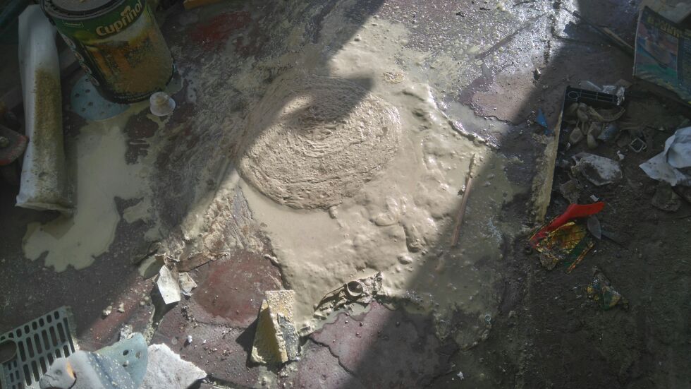

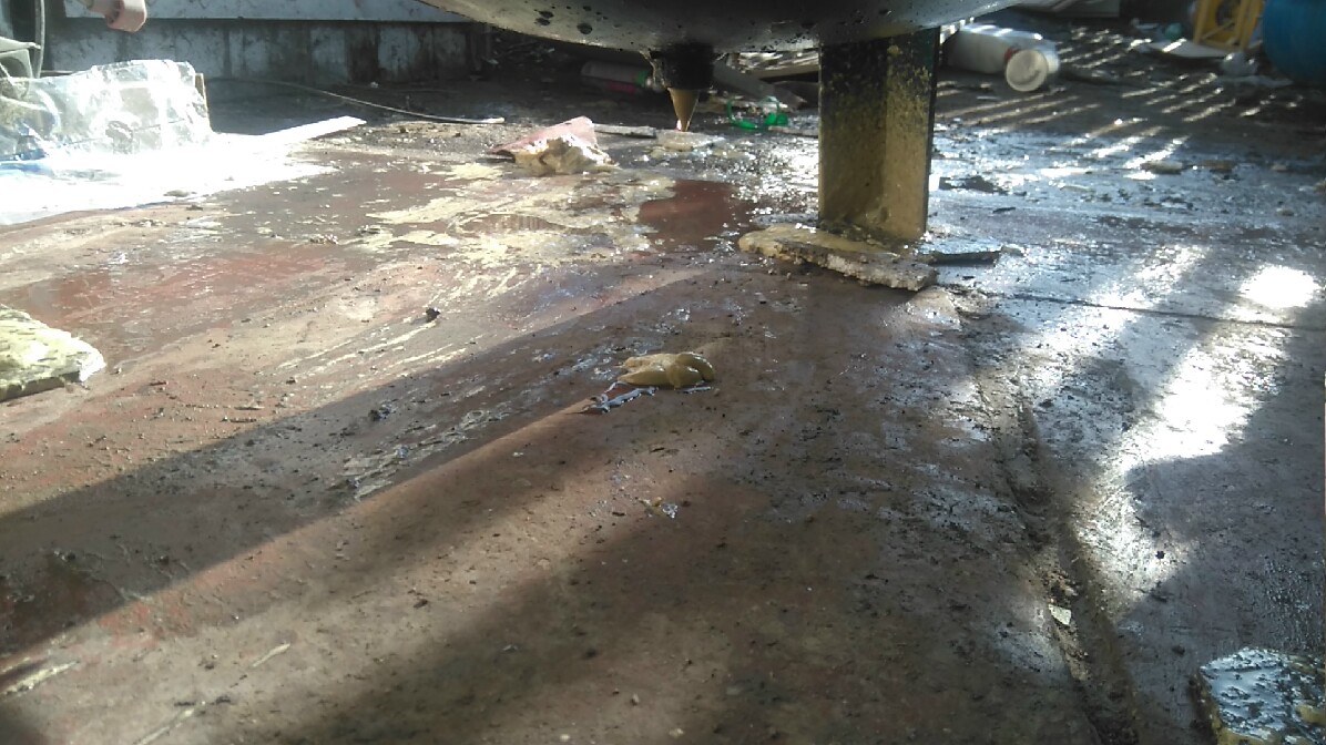

I worked at a boat factory once. Outside was a large ingersoll rand v twin with a 350 ltr tank. One day the lads were moaning about how knackered it was & there was never enough air for the tools. It started pumping water through the tools. I asked "When was it last drained down?" nobody knew so i went & turned the drain cock. It flooded the yard. The thing was literally full up with water. We had tons of air after that! I drain mine every day.
