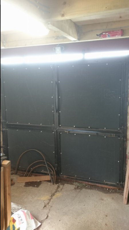

Might be a bit over the top but if security of important, build doors like on a Mobile Mini container (bottom right).
The important bit is the locking system:
The circular silver thing in the hole is the lock itself and attaches to a tab in the arm of the handle, preventing it from moving up. With it in the down position it has three big bolts that slide though the top, bottom and into the other door, moving the handle up once the lock has been removed retracts all the bolts. The only way to get in without the key is to take an angle grinder/plasma cutter/oxy-fuel to it.
