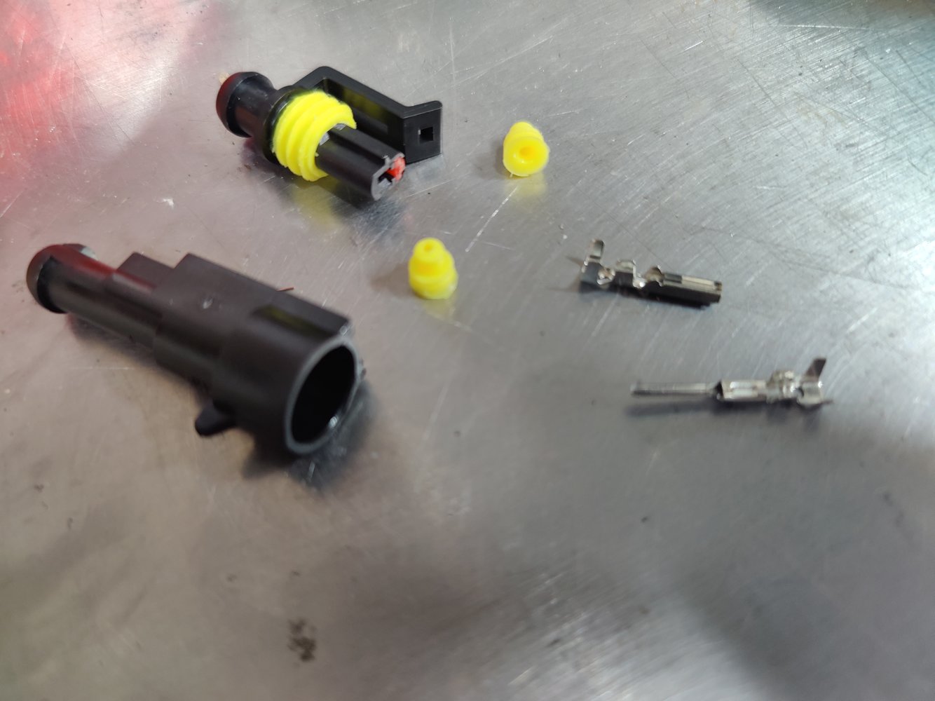

And these are the connectors and terminals

I don't think it will cover the Deutsch connectors. I think they are very much proprietary.

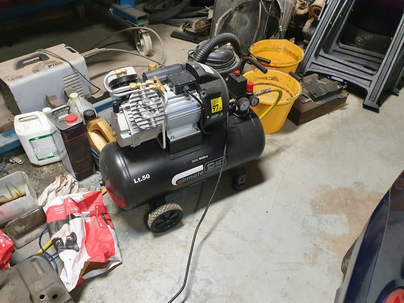

...Oh and this compressor. It's 50 ltr. I made a mistake. It's already up for sale and i'm going to get a 200 ltr. Better just bite the bullet now I guess. I didn't realise the tools I would be using are some of the most demanding (die grinder, sander).
I'll take a hit of a few quid, but will put it down as a lesson to do more thorough research in future. (I was too caught up with CFM figures).

Been there but should have known better, had a Clarke 150l, 14cfm compressor but was pushed for space, sold it and bought what you have in the picture and regretted it.

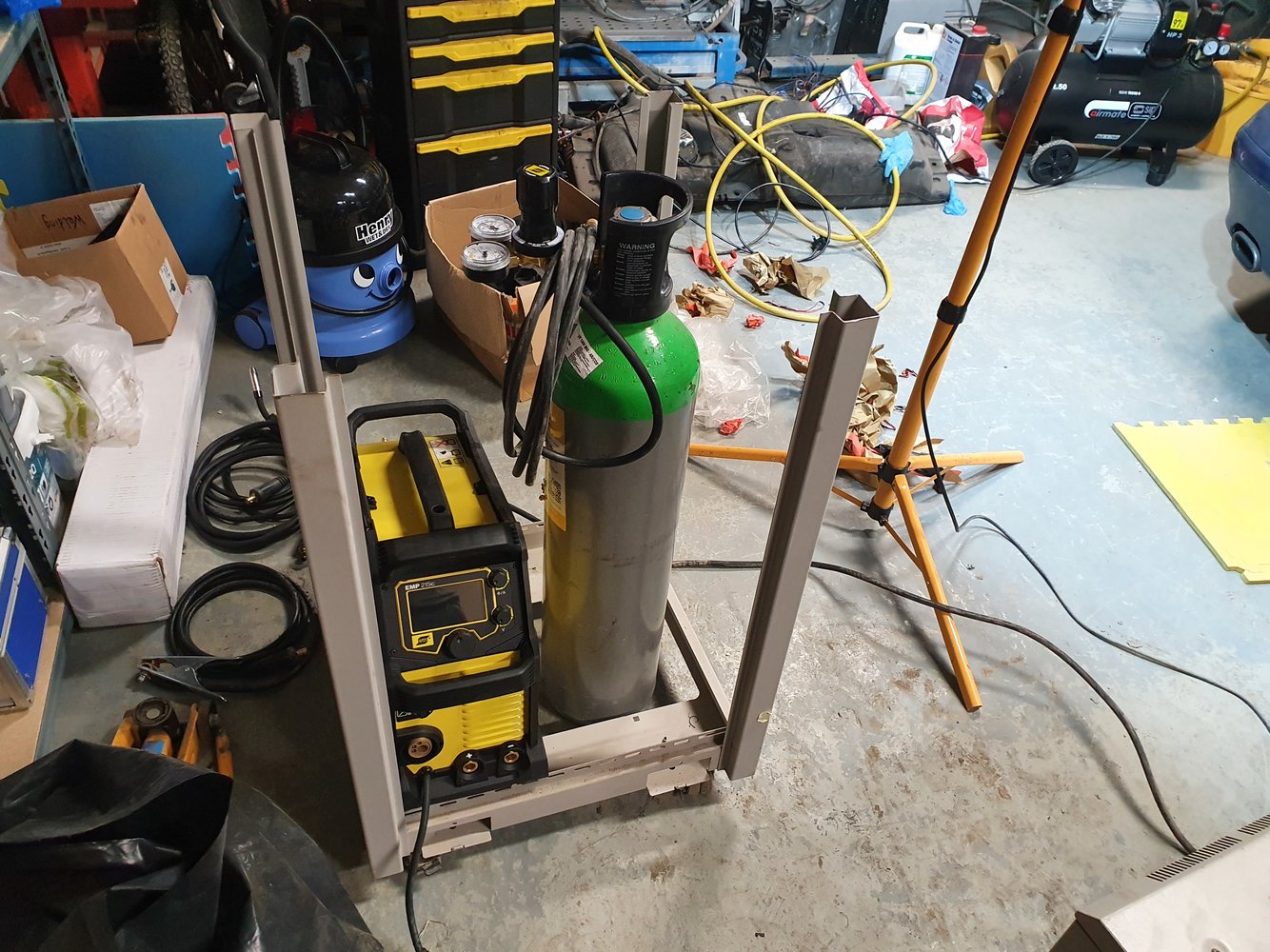

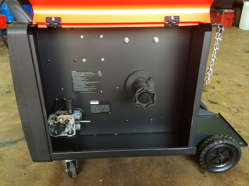

My Sealy has 2 wheels on the back and a small platform for the gas to sit on and then uses chain that wraps about 1/3 of the way up the bottle to keep it parallel to the welder and I have to say it works a tread even with the big bottle of gas.
I know you're looking at a different direction but by the time you lift up the table top to weld on above the bottle it's going to be pretty high. I kind of like to lean over and be able to maneuver whatever way I want around a part so reaching up onto the table would be off-putting. You could however put the bottle just on the inside edge of the cabinet you have there so the valve is accessible and then to help counterbalance come of the weight extend your welding table ledge to the opposite side.
