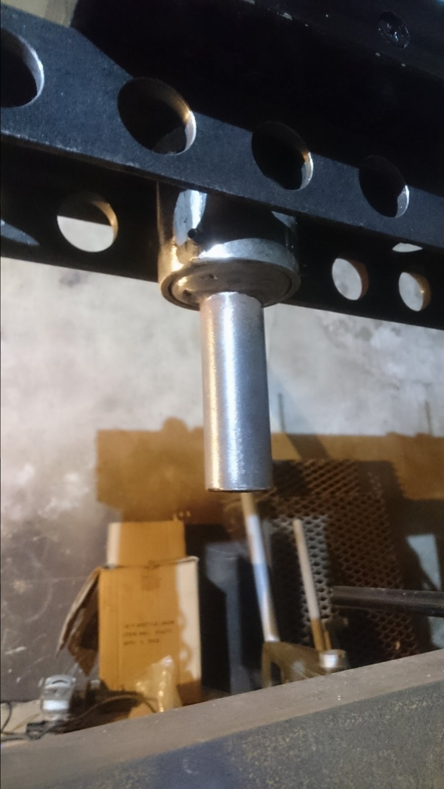

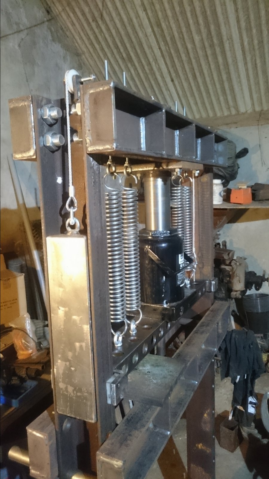

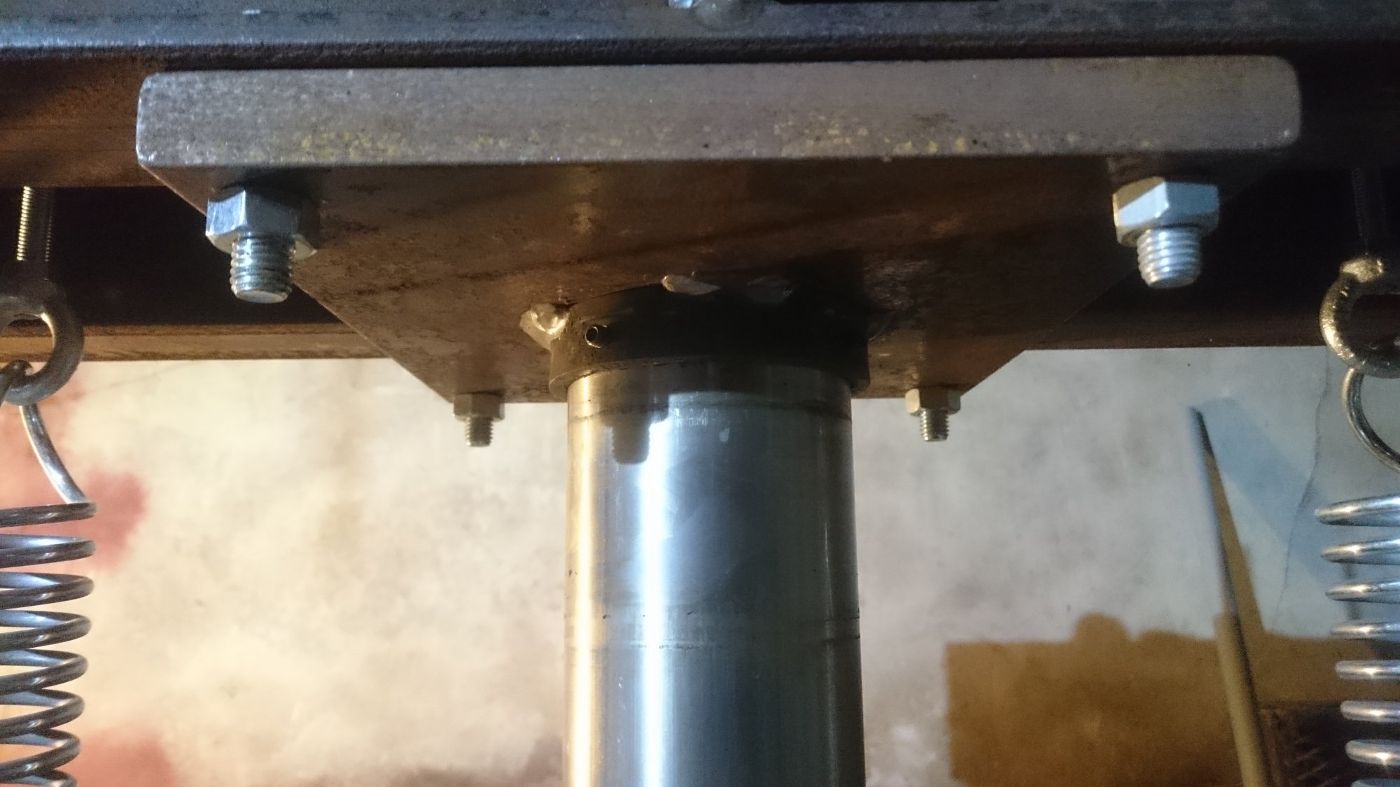

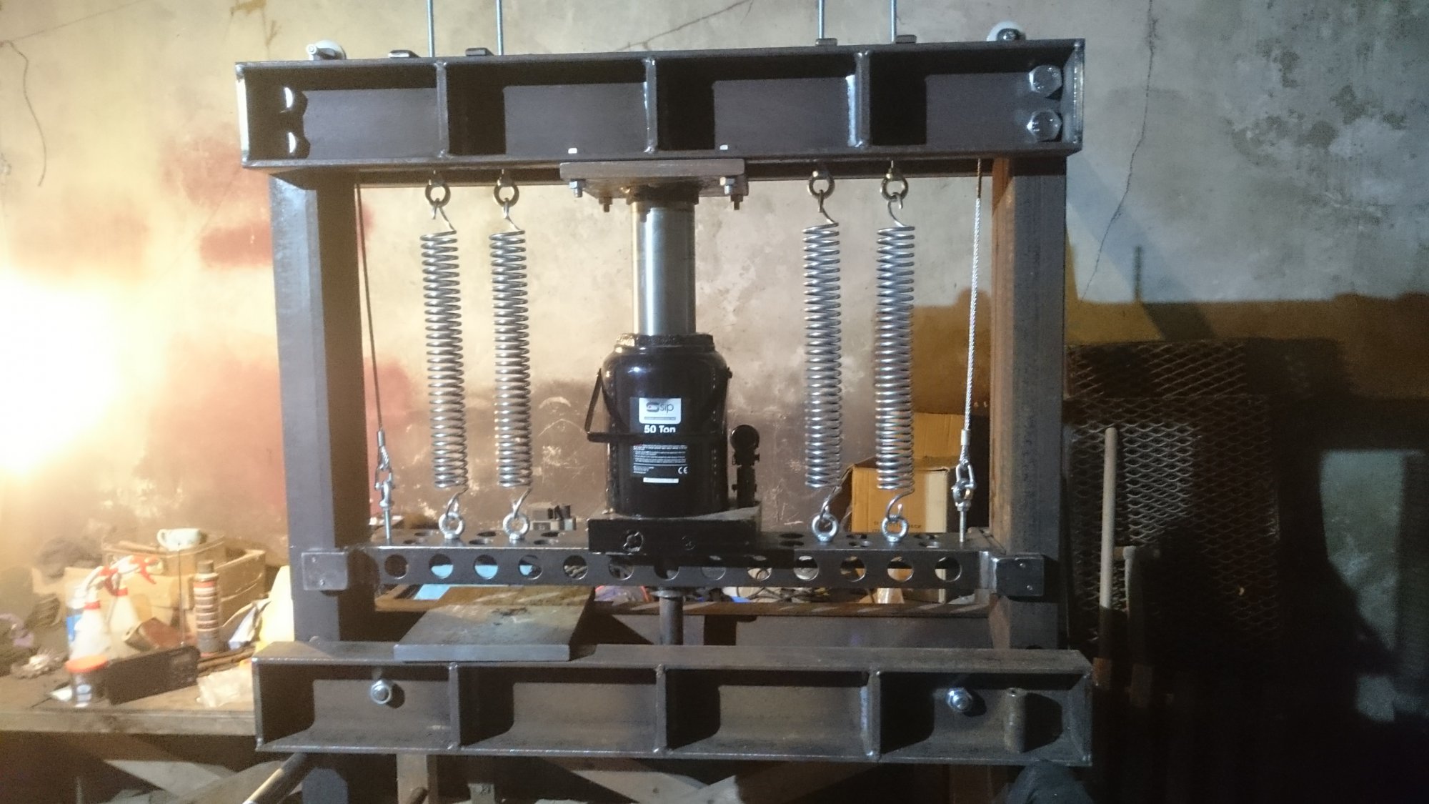

ive seen people make them with the jack mounted upside down on the top rail, if you did that you may have to alter the jack a little and fit a reservoir to enable the jack to work but then you wouldn't need to raise the weight of the jack
I did that with a 3 ton jack a good while back just to see if it would work and it was very tight.
To be honest I don't have a big enough stilson or wrench to dismantle it nor am I strong enough.
