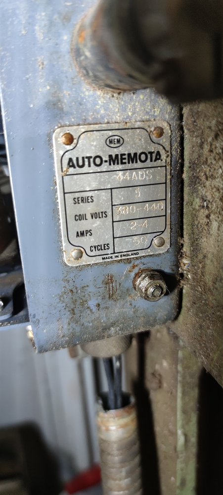

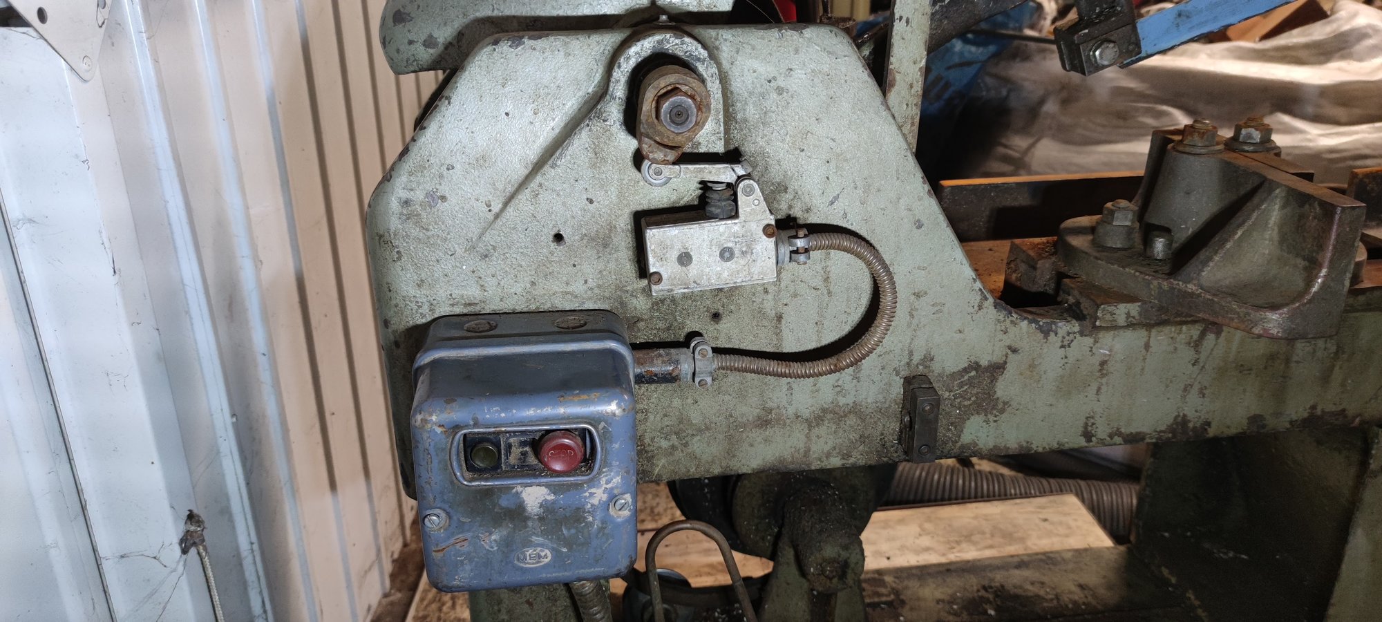

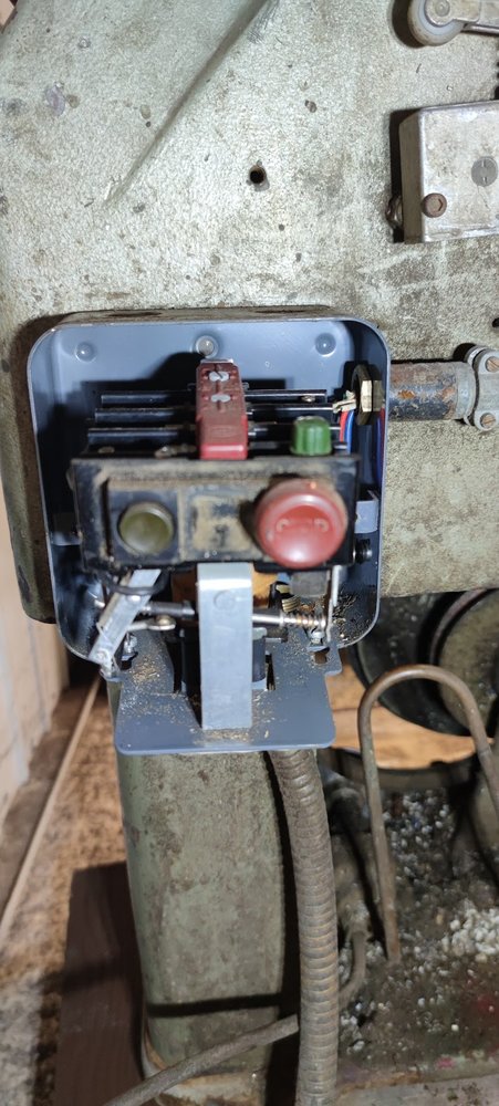

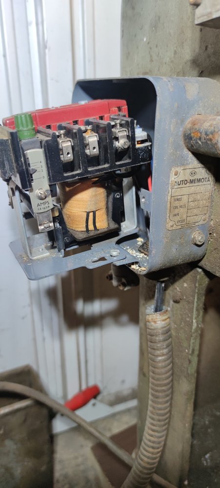

Here is the switch and also the 'cut off' switch witch is supposed to turn the saw off as soon as it has finished cutting. Remember it is called a donkey saw for a reason, you will get old standing there waiting for a cut to finish .
The coil in the switch is 380-440v, so it will not work with ~240v.
No
However if you PM me I can send you a 240v coil.
