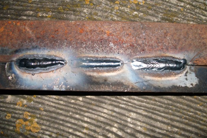

I've recently had a bit of a stooshie with George B about using 3.2 rods on wee 100A arc welders. I hold with my advice not to, still, but I made the mistake of saying a good weld wouldn't be had with 100A. Oops. One look at the pack of Oerlikon Fincord 3.2 6013s in the cupboard told me I was onto a loser, as the current range is 80-130A. That's me told then.

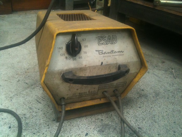

So I chopped up some 3mm x 25mm strip, and laid a couple of rods. Now before I show the pics, notice these were NOT done on a £30 100A max el-cheapo AC buzzbox, they were done on a very nice old 140A AC Esab Bantam set, a machine I seldom use but love dearly. It's been through many boxes of 2.5s, and not many 3.2s, at rather more amps than we're talking here.
Here it is

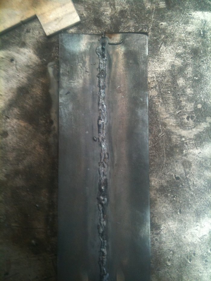

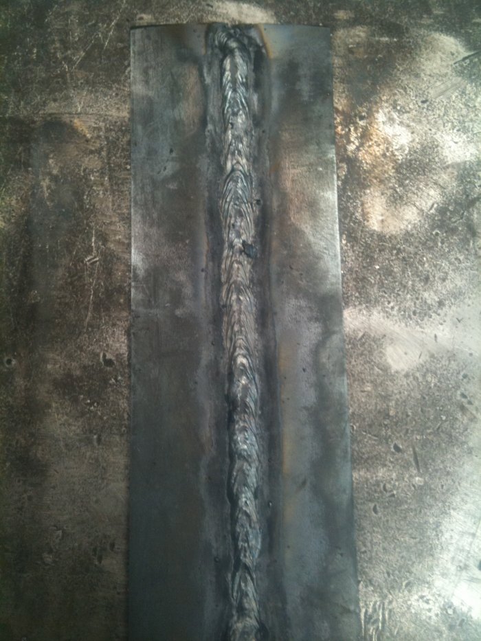

And here is a butt weld on 3mm strip, no prep ground, 2mm gap. 95 Amps. Not a weld to write home about, and no prizes for good looks, but given the size of rod, the size of material and the amps, it's no surprise it looks rubbish. Perfectly strong though, no inclusions, full pen.
Weld

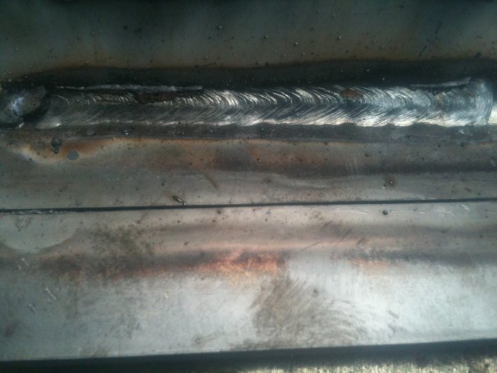

And here's the full pen on the back. Again, looks a but cruddy, but no major problems with integrity there (not perfect though).
And here's a fillet weld, reasonable, I was most surprised!
