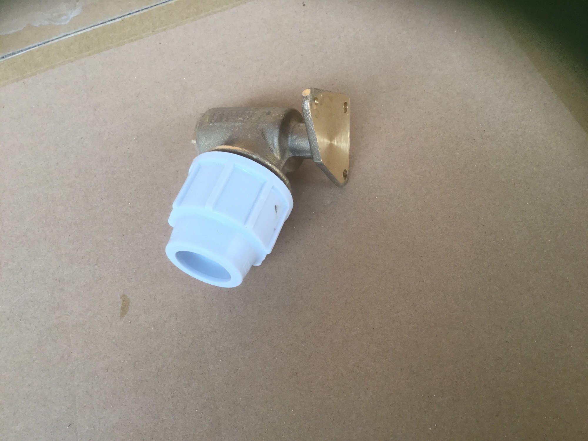

yes, they are very good. Screw it to the wall, screw the PCL fitting into it.I like the 1/2" back plate elbows, the 1/2" pcl`s screw straight into them without loads of other bushes, makes for a nice solid mount.

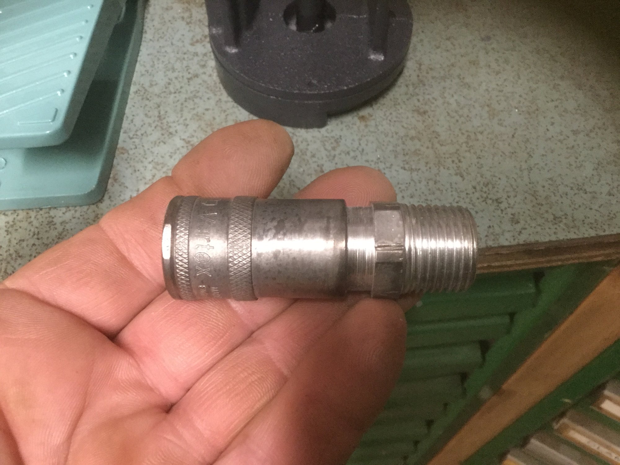

I'm totally confused about the threaded fittings and internal bore to suit certain tools, with BSP/NPT 1/4" , 1/2" etc etc.
I suppose my main query is the most fittings i see are actually 1/4" BSP. In theory does this make the flow advantage of running 1/2" pipe around the shop a waste of time? will 1/4" BSP fittings run say a die grinder or DA ? or do i need all 1/2" fittings??
Same with the regulator/drier at the compressor - most of them i see are actually 1/4" BSP fittings - again do i need to find a 1/2" reg to take advantage of my 1/2" supply piping?
Or, am i over thinking it and will 1/4" BSP run everything i require absoutly fine?

I think it will help to think of it in these terms.
The restriction to air flow is a function of the bore size and the length of pipe. If you have a narrow long pipe it is considerably more difficult to move a volume of fluid (air) through it.
It is obvious that a wider bore solves the problem, but what is less obvious is a shorter length also reduces the resistance.
A coupler might be 1/4" but it is only over a very short distance, so while it does act as a restriction it is far less so than say 50m of 1/4" bore pipe.
This is why it is a good idea to have the main long runs in a wider bore so that it doesn't act as a bottle neck. The drops are typically shorter so they can be in a smaller pipe.
So now it becomes a case of practicality and cost.
In an ideal world everything would be run a large bore all the way through, but the price and availability of fittings, regulators and sundries in those sizes might just not be cost effective for the application.
If there is only a marginal performance drop in using a smaller fitting it often makes sense to do so.
Quick connect couplers are typically narrower than the BSP fittings, although the XF ones are much better.
So to answer the question, no it isn't a waste of time to run 1/2 pipe - in fact for my main line I ran 3/4 with 1/2 drops that then either fit straight into the regulators or quick connects or adapt into 1/4 first.
That way any bottlenecks are kept to a minimum. My hoses are 10mm bore which runs most tools adequately including DA and Die grinders, but I have the option of using a short 13mm bore hose with the large impact gun if I feel I need it.

Looks like they (and most other brass fittings) only come in 15mm and not 20mm .. is this normal ? Can't even get 20mm brass elbows strangely
