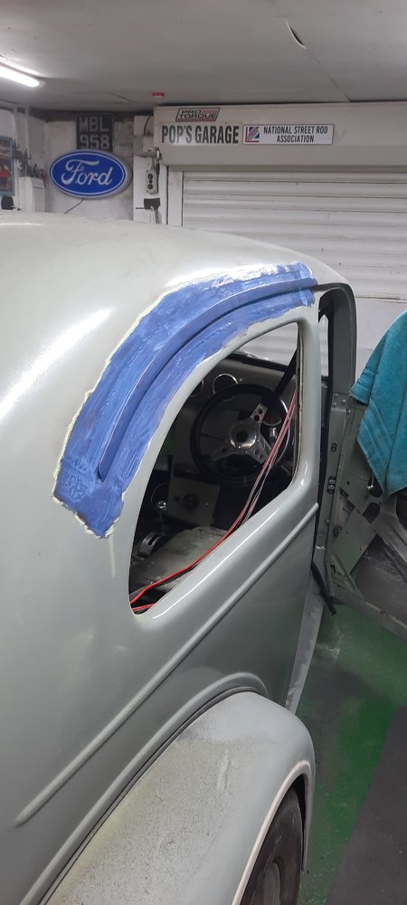

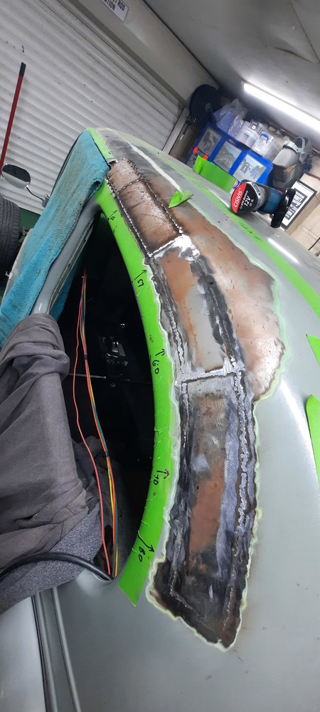

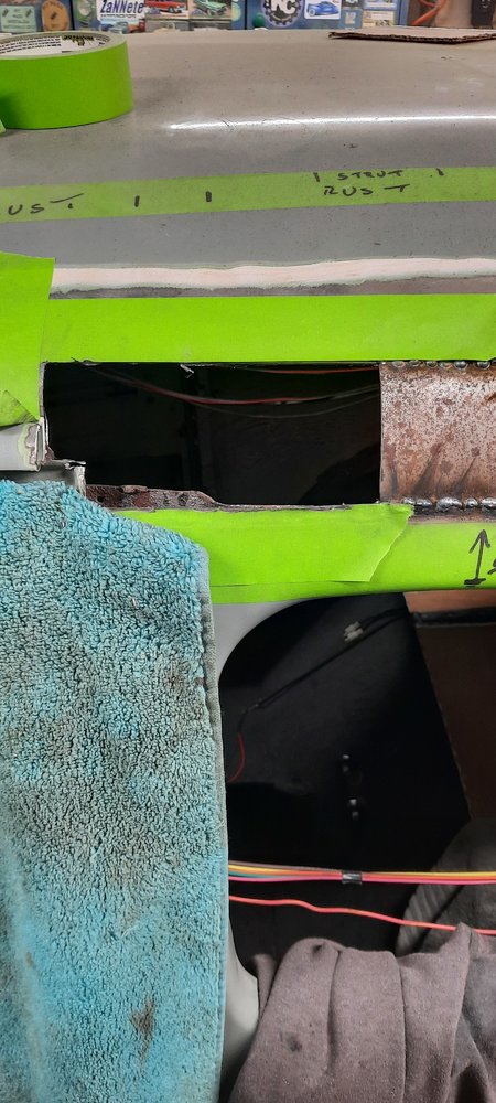

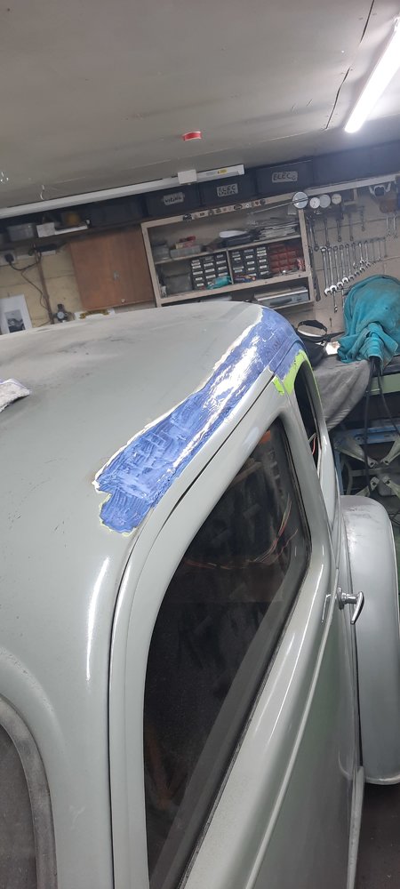

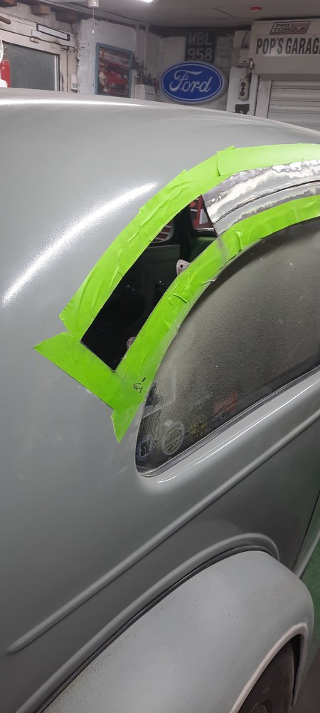

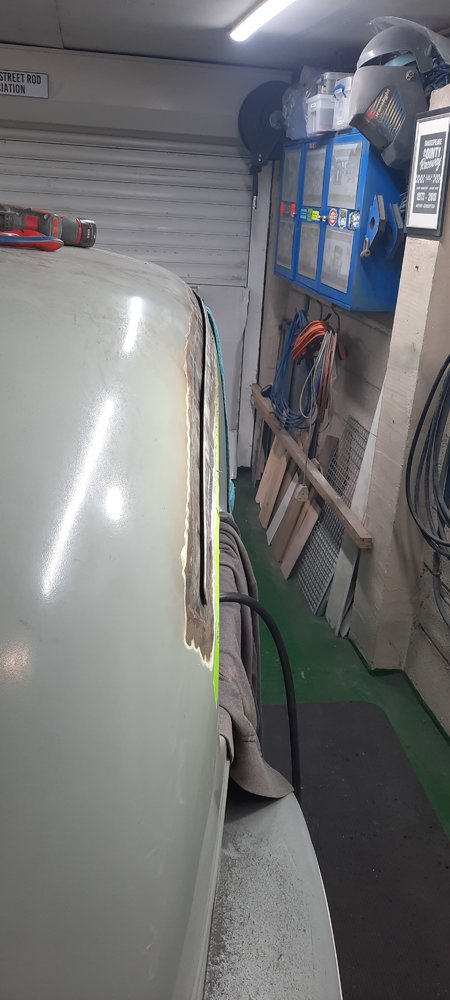

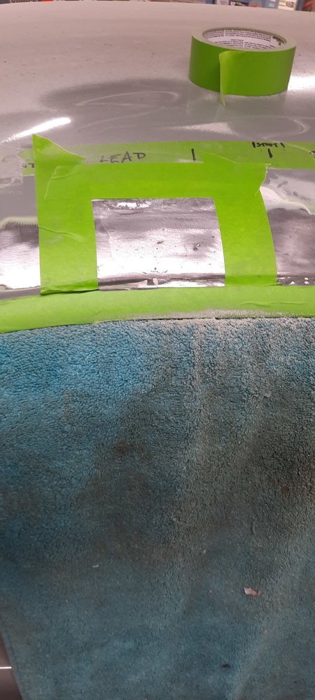

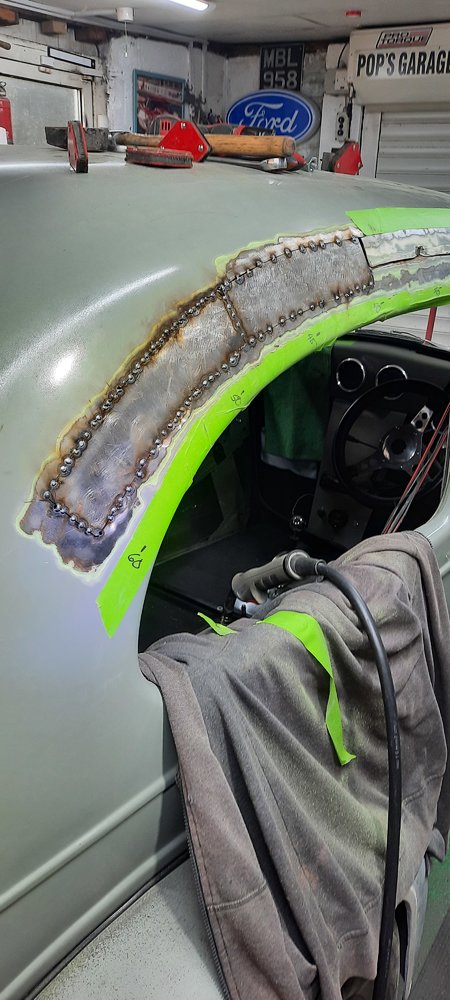

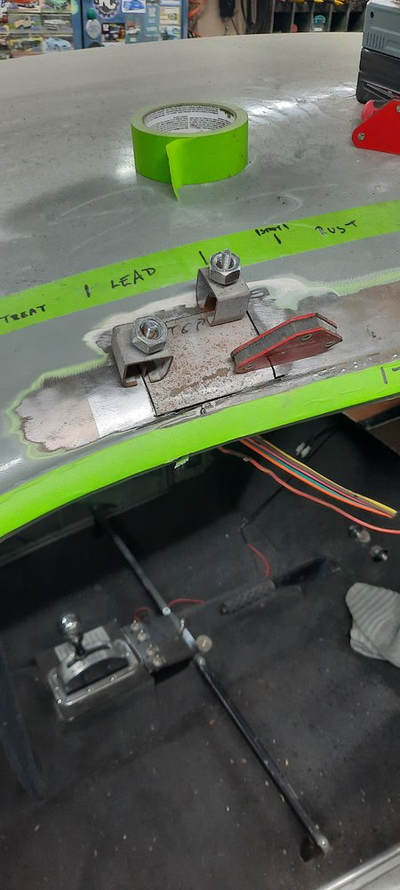

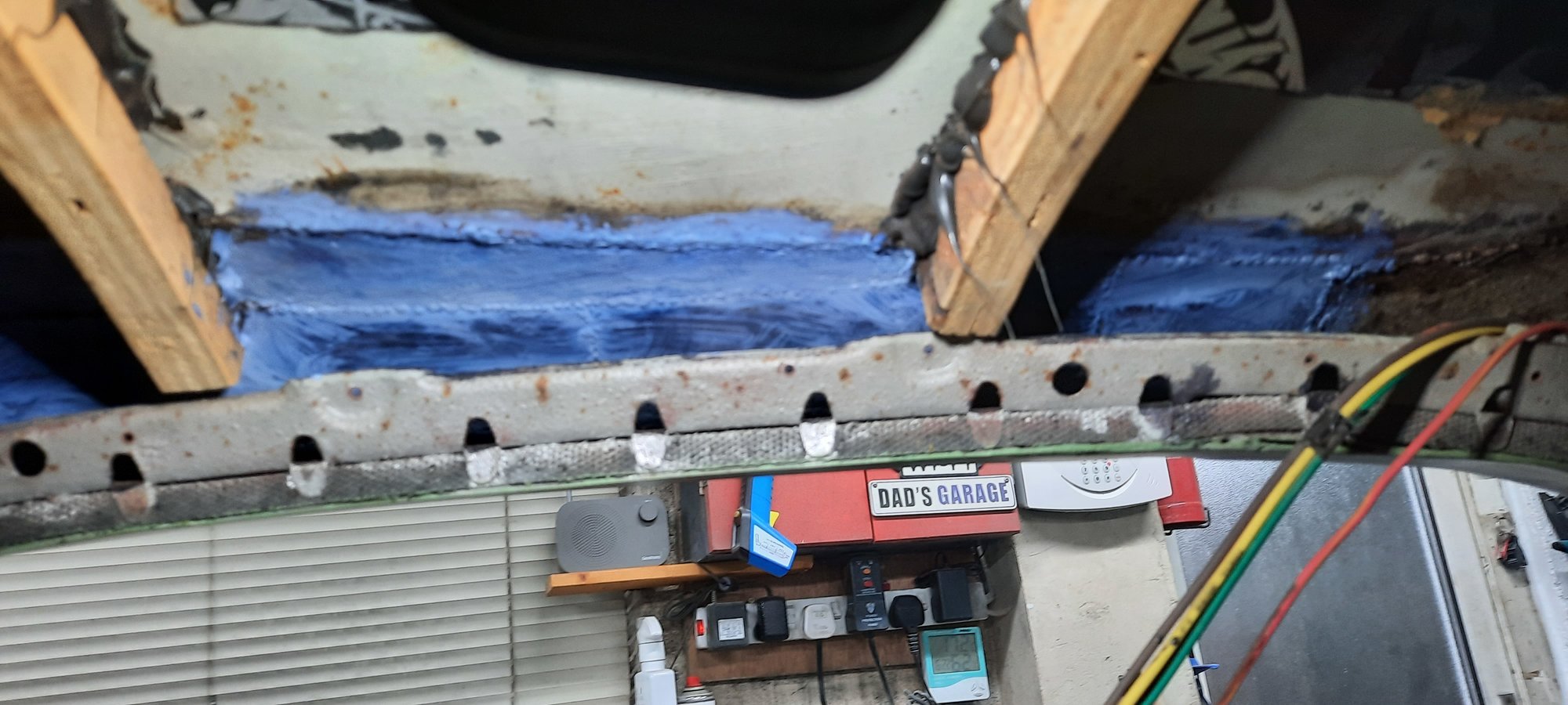

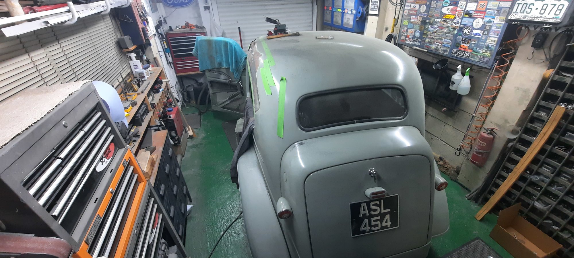

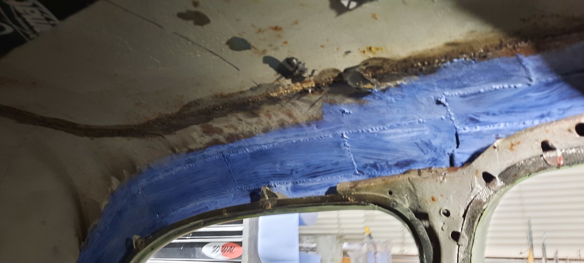

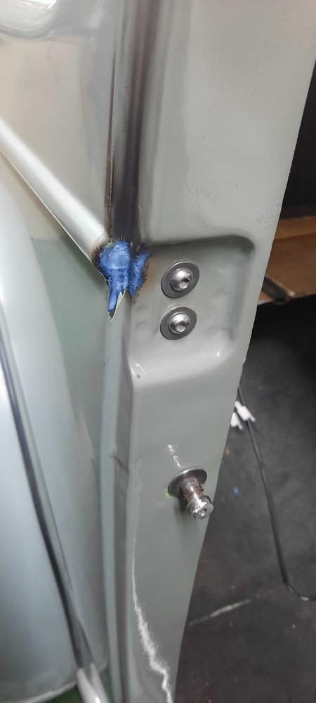

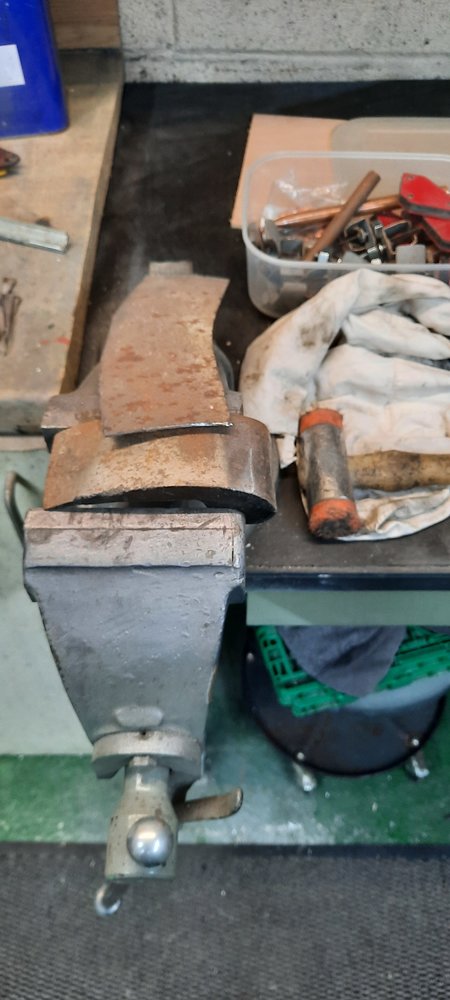

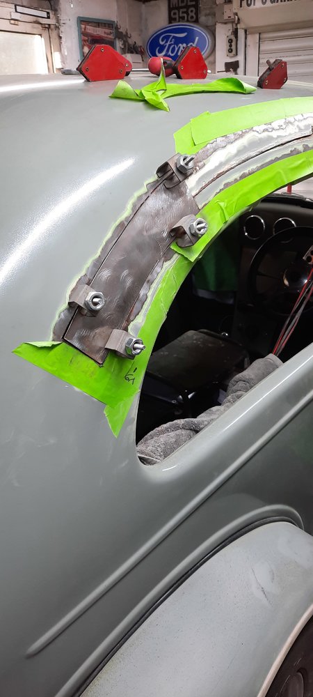

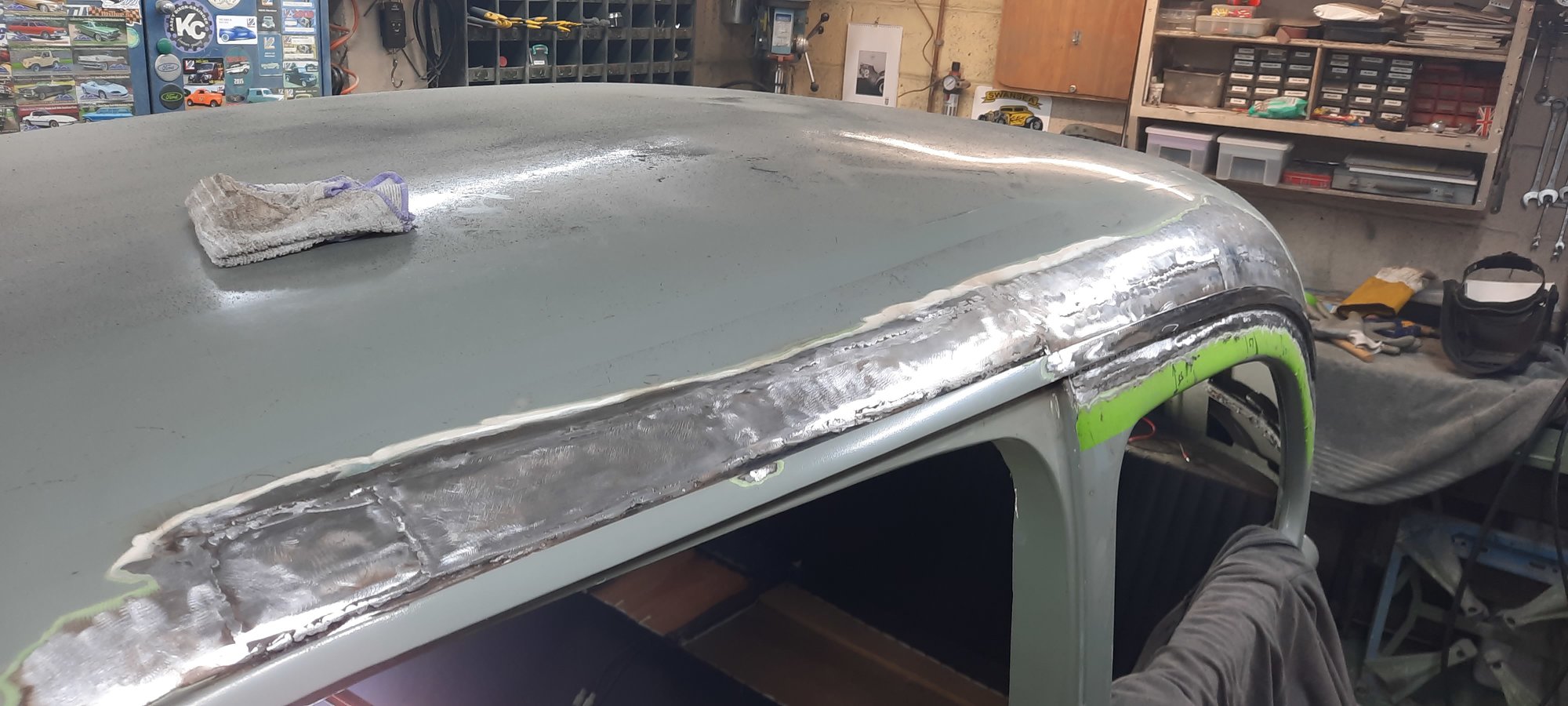

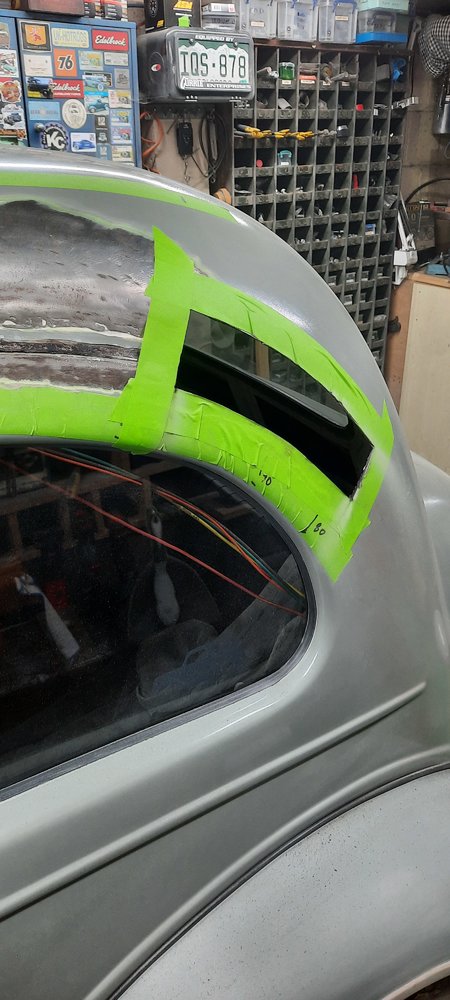

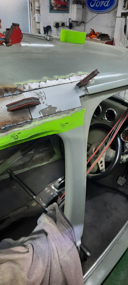

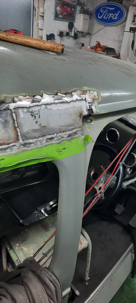

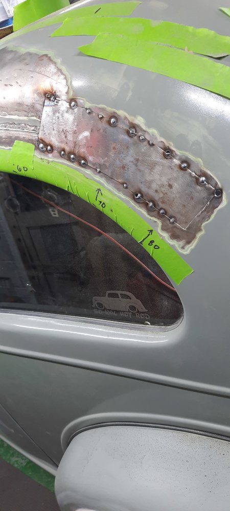

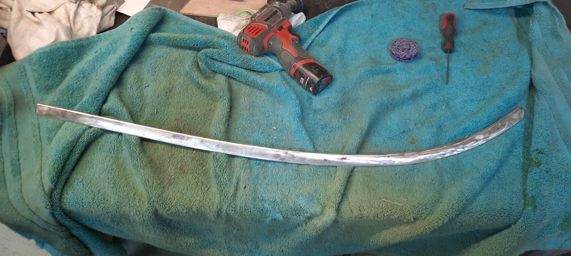

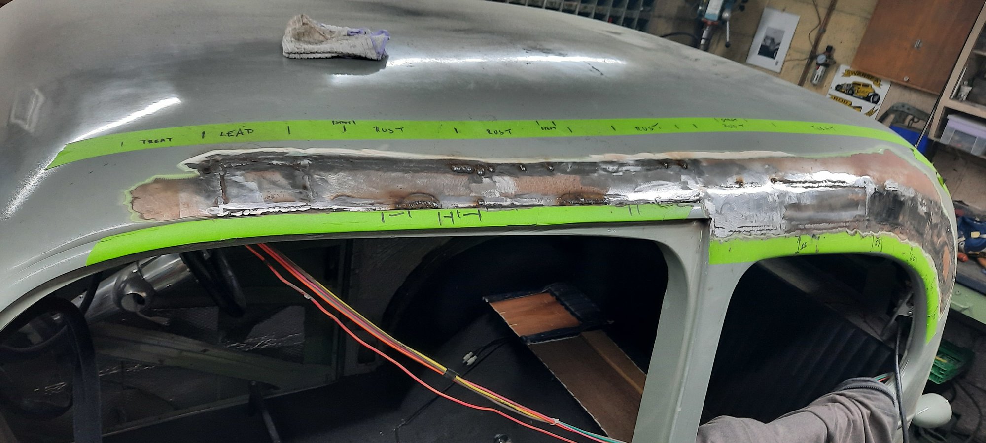

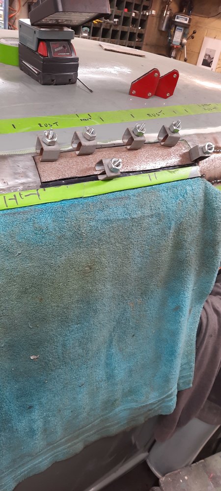

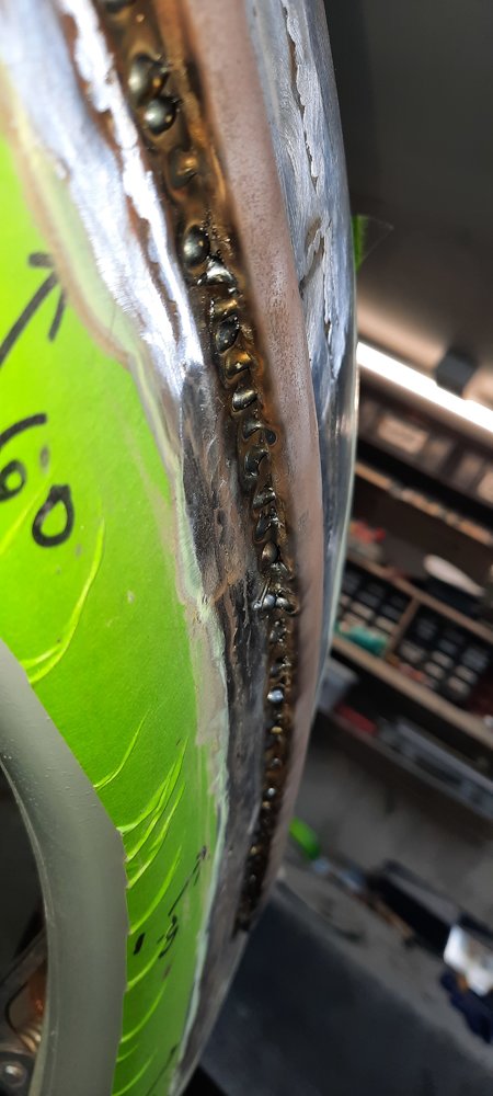

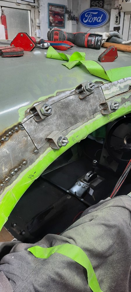

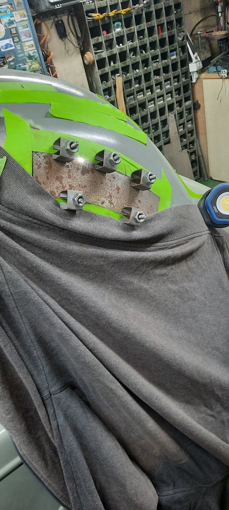

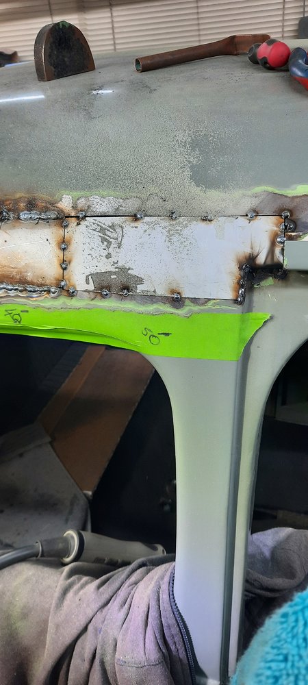

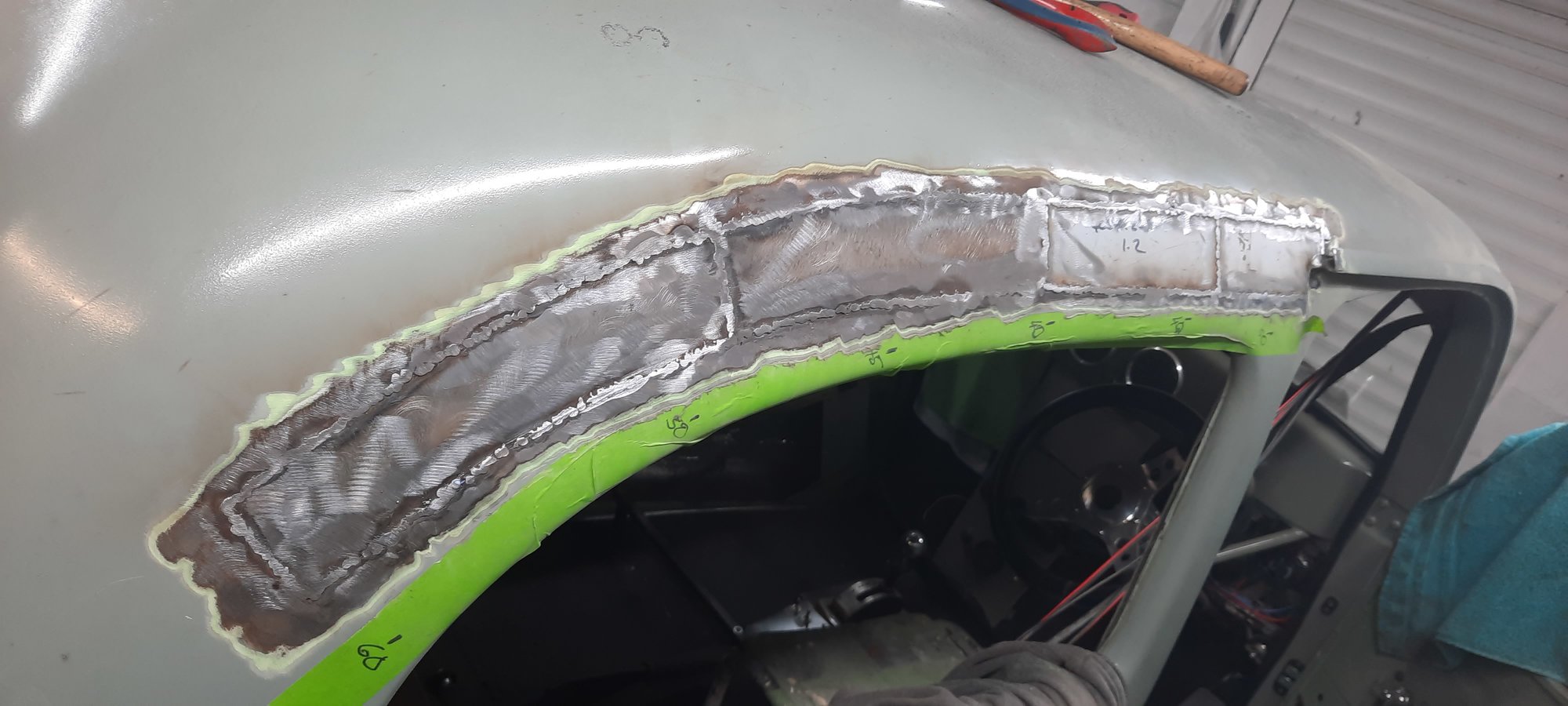

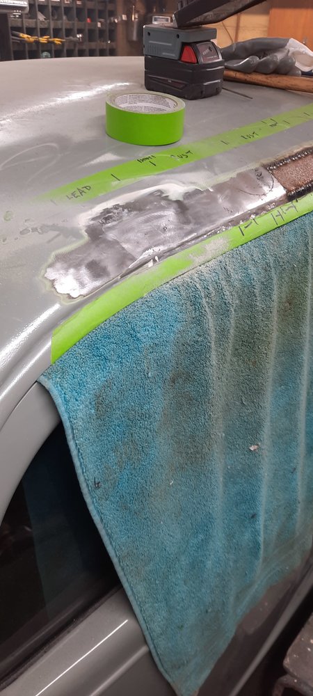

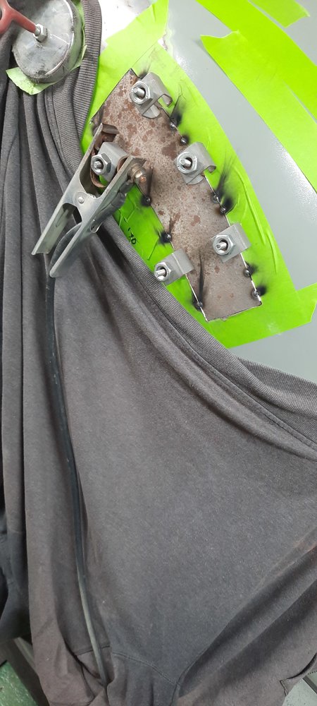

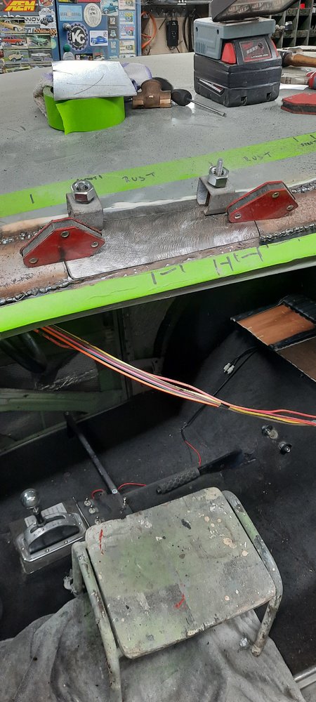

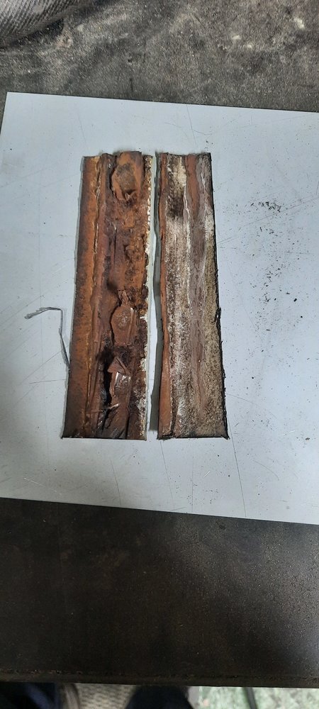

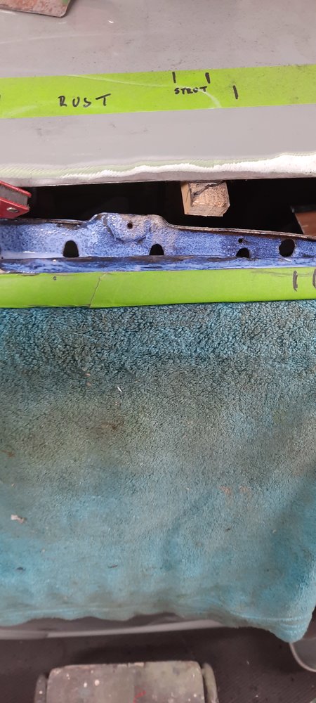

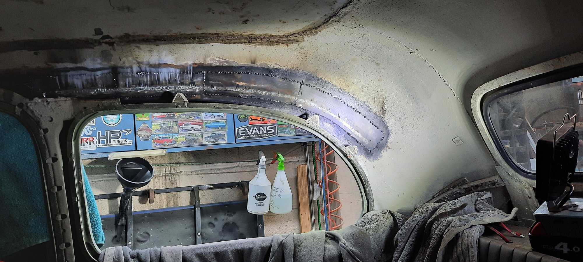

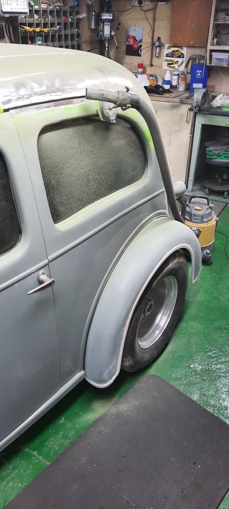

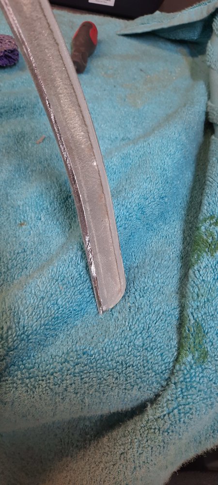

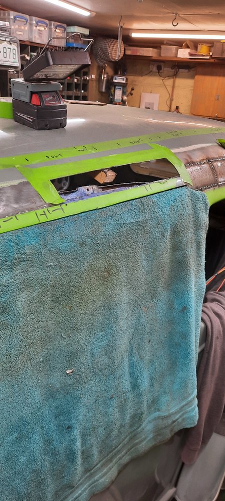

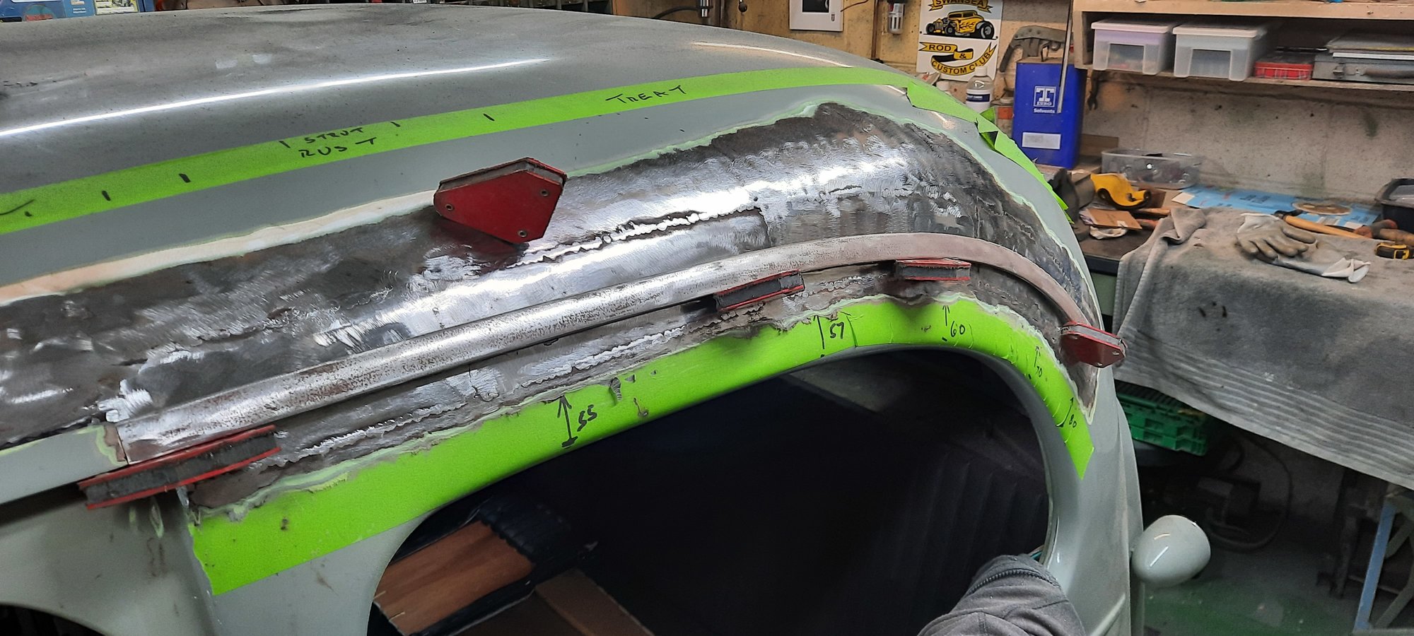

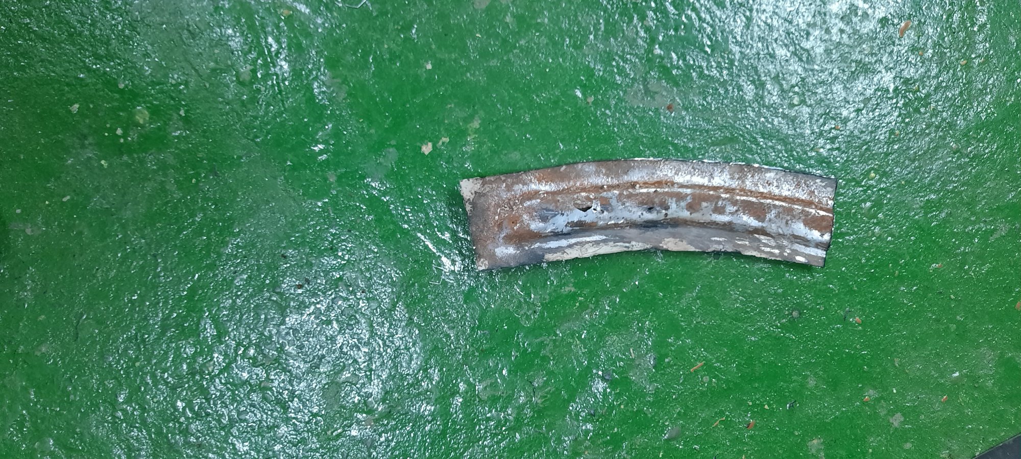

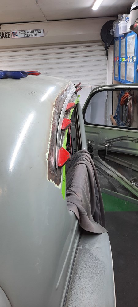

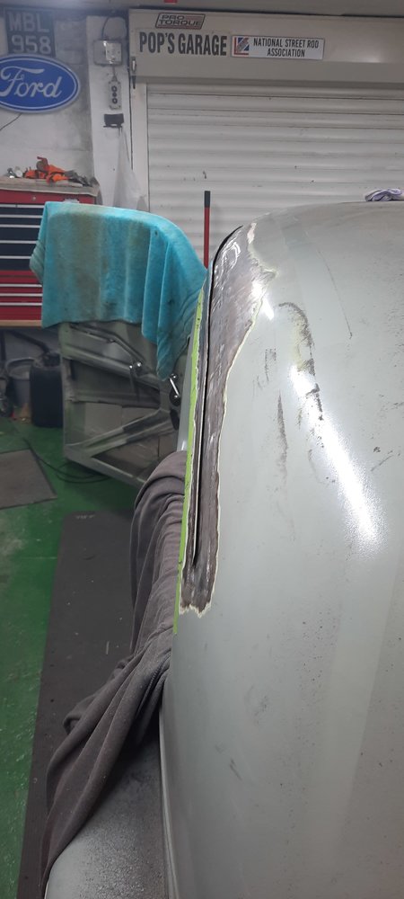

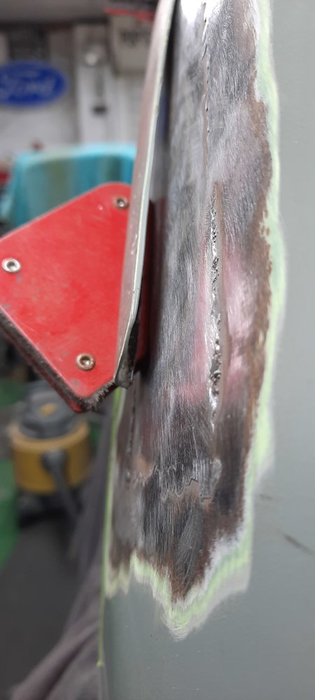

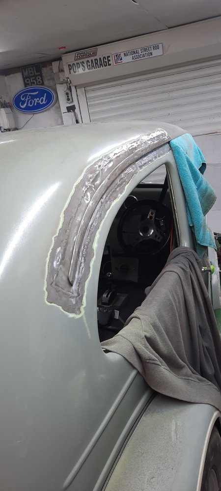

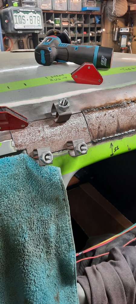

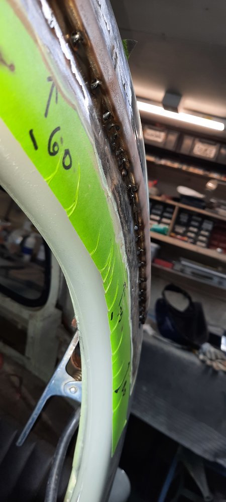

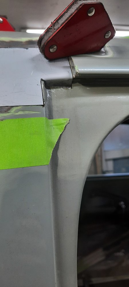

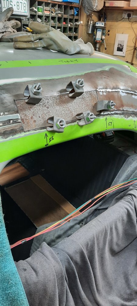

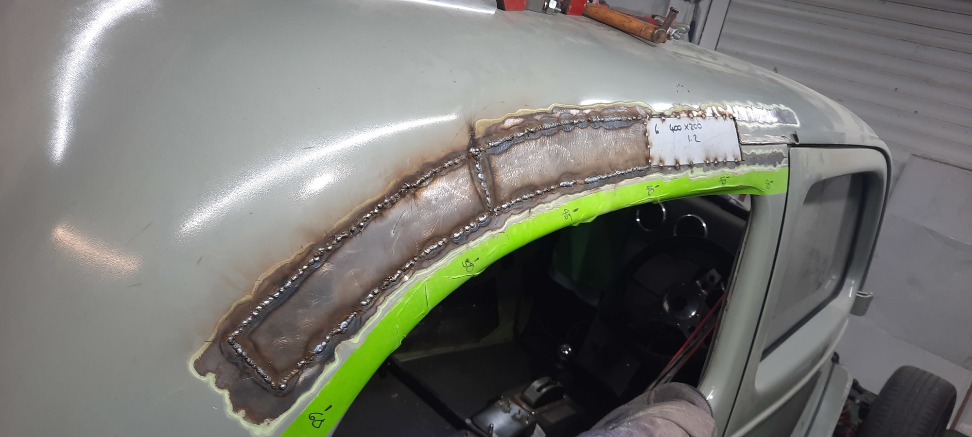

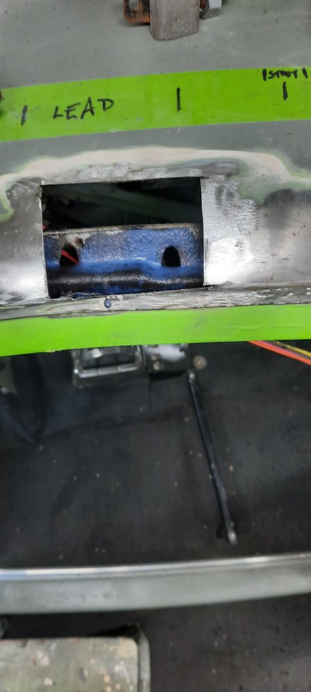

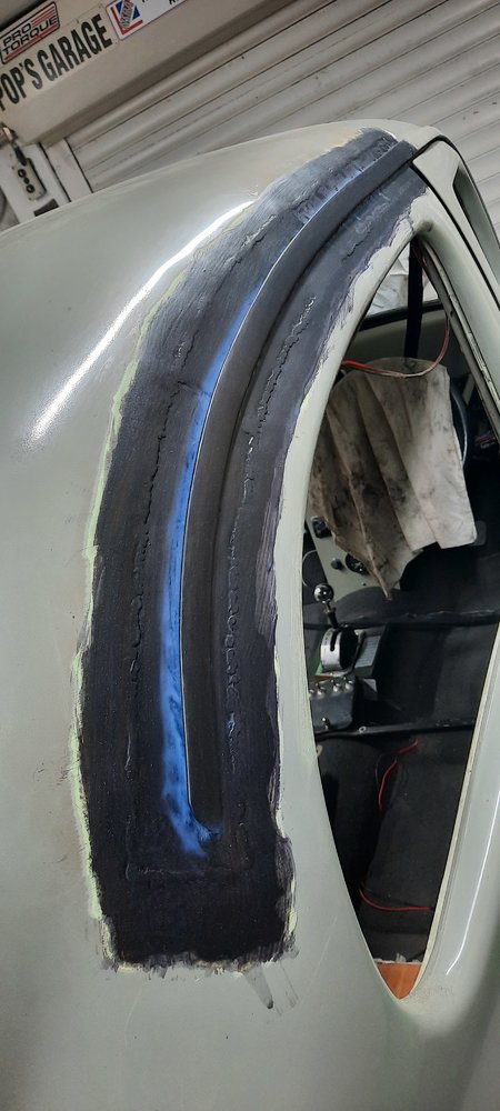

liking the dust extraction set up!Slightly out of sequence, but i jumped in with both feet, chopped off the gutter as close too the body as possible, it's in good nick. Chopped out the rear most section as i though tis would be the hardest, 2.1/2 hours later i have a piece in that looks ok. Just need a bit more time on the welder settings and big lump of brass or copper? to help with blow through..... only one smouldering towel so far

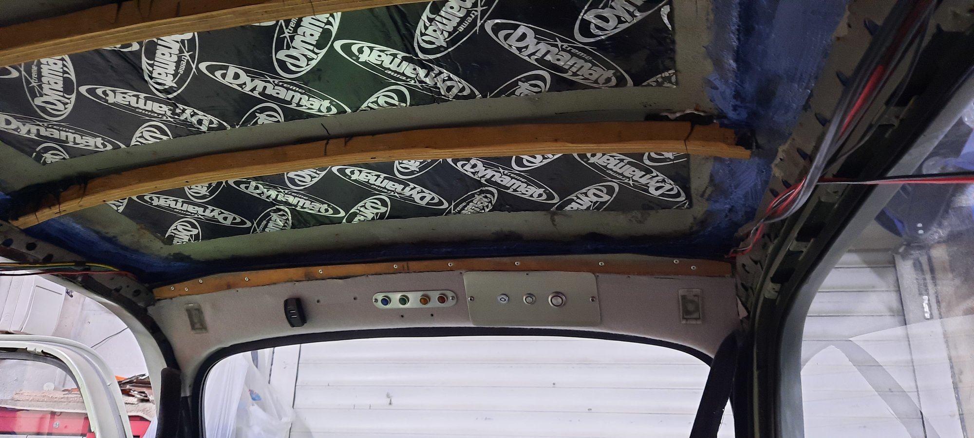

View attachment 481505View attachment 481506View attachment 481507View attachment 481508View attachment 481509View attachment 481510View attachment 481511View attachment 481512View attachment 481513

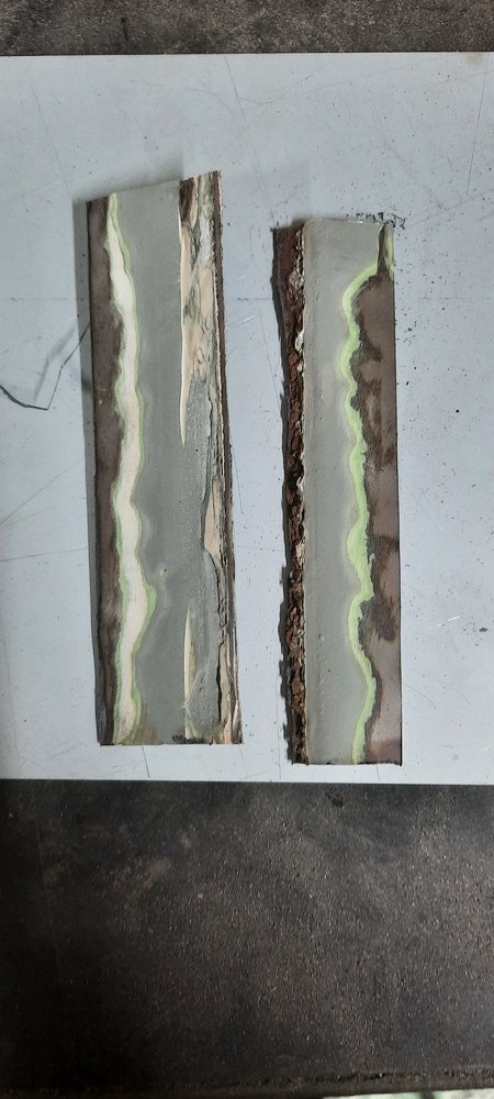

It's what i had in stock ....I like the fact you are keeping it original buy using pre rusted replacement panels ,cut to fit.![]()
