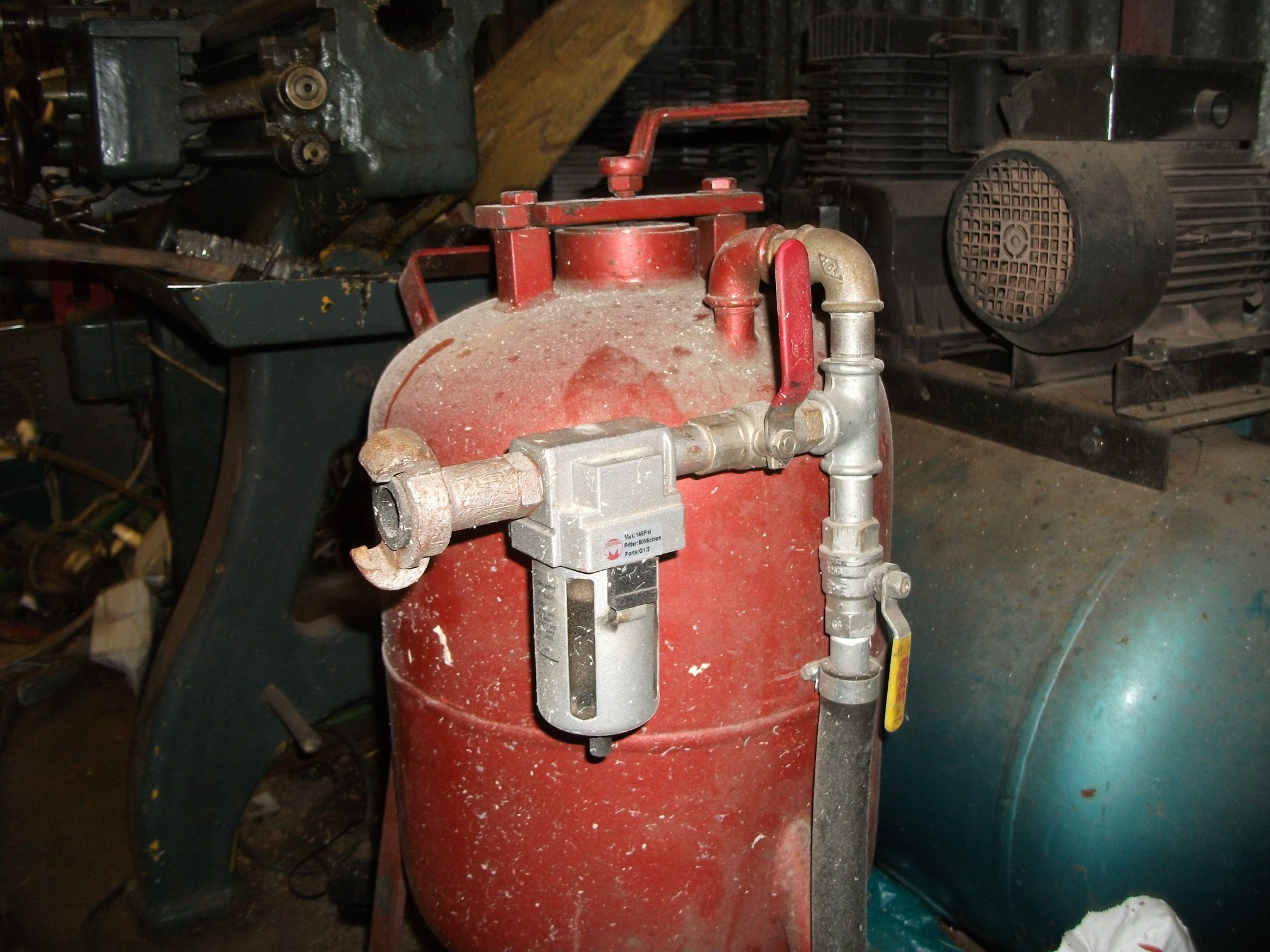

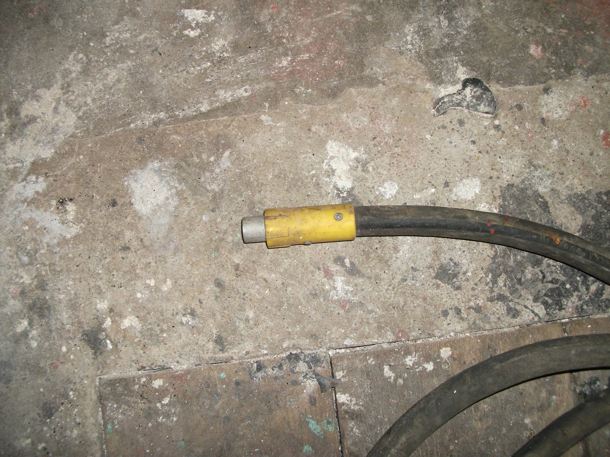

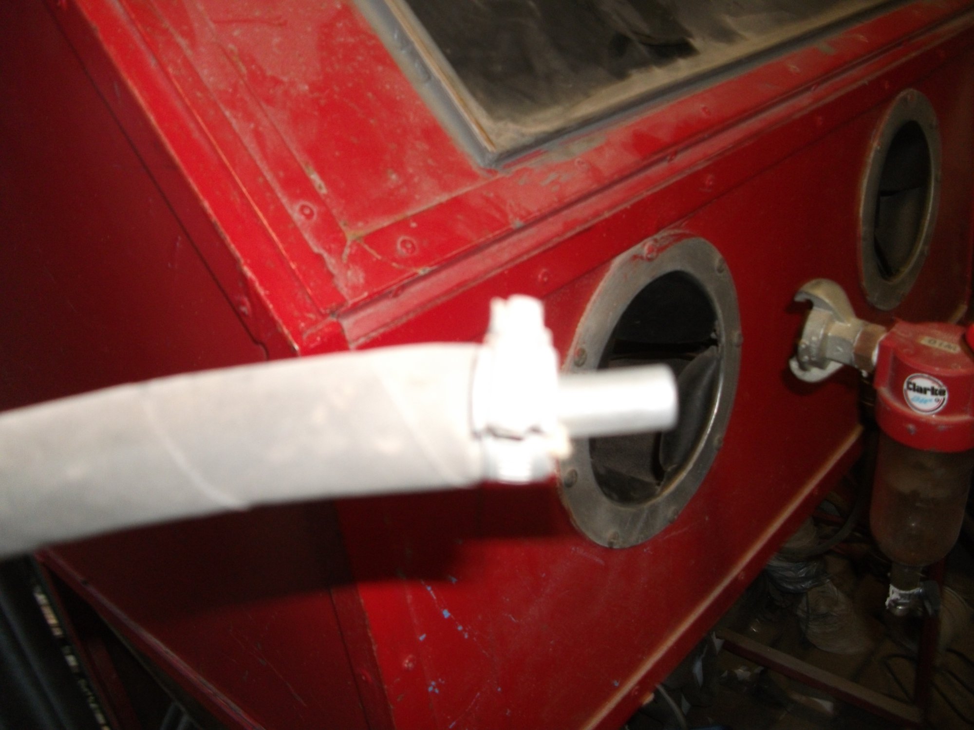

I am not looking for nozzles :P (but thank you for the tip) I am looking for something to reduce the diameter inside the ball valve to fit my 3mm nozzle like a rubber pieceI used to make them with cast iron window sash weights. Turn to the size you want drill hole you need down centre heat to cherry red then put compressed air down hole till cold enough to handle, don't water quench. These are harder than carbide and last longer. I had to do this when I forgot to order nozzles for a large industrial walk in shotblast unit. I only made them as a temporary fix till the carbide ones arrived but the cast ones lasted at least four times longer than the carbide ones.
MBB

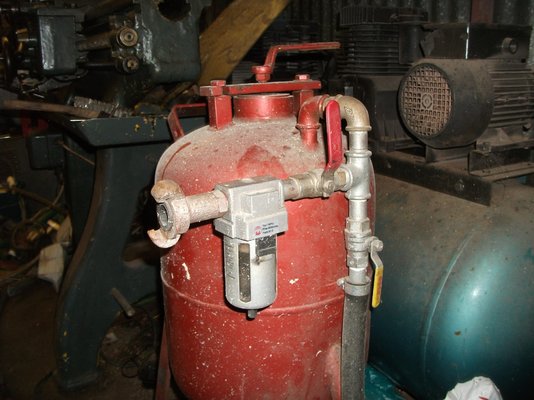

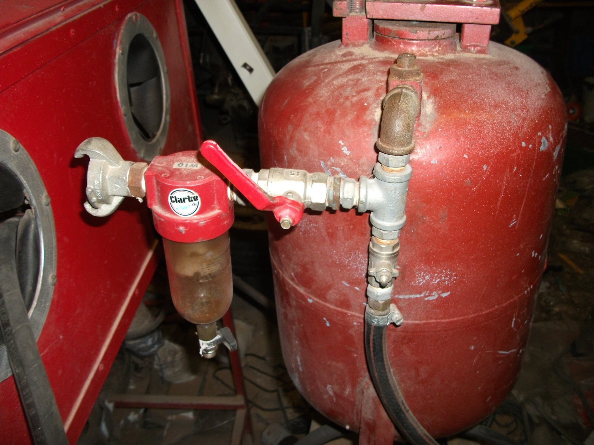

Ok so I would control it from like the quick connector valve/near the pressure regulator/water trap valve (in your case it is not a quick connector), right?here's both of mine I've been using them for 40 years no problem
yes I use c couplings on both mine with large bore hose but if your using a 3mm jet a 10mm bore pipe will be fine using slightly larger bore connectors than the standard pcl couplingsOk so I would control it from like the quick connector valve/near the pressure regulator/water trap valve (in your case it is not a quick connector), right?
Thank youyes I use c couplings on both mine with large bore hose but if your using a 3mm jet a 10mm bore pipe will be fine using slightly larger bore connectors than the standard pcl couplings
namely 90cfm I use oneyou need loads of cfm even for a 6mm nozzle
