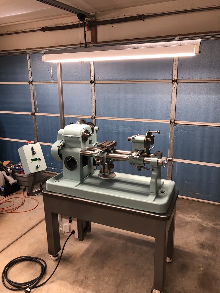

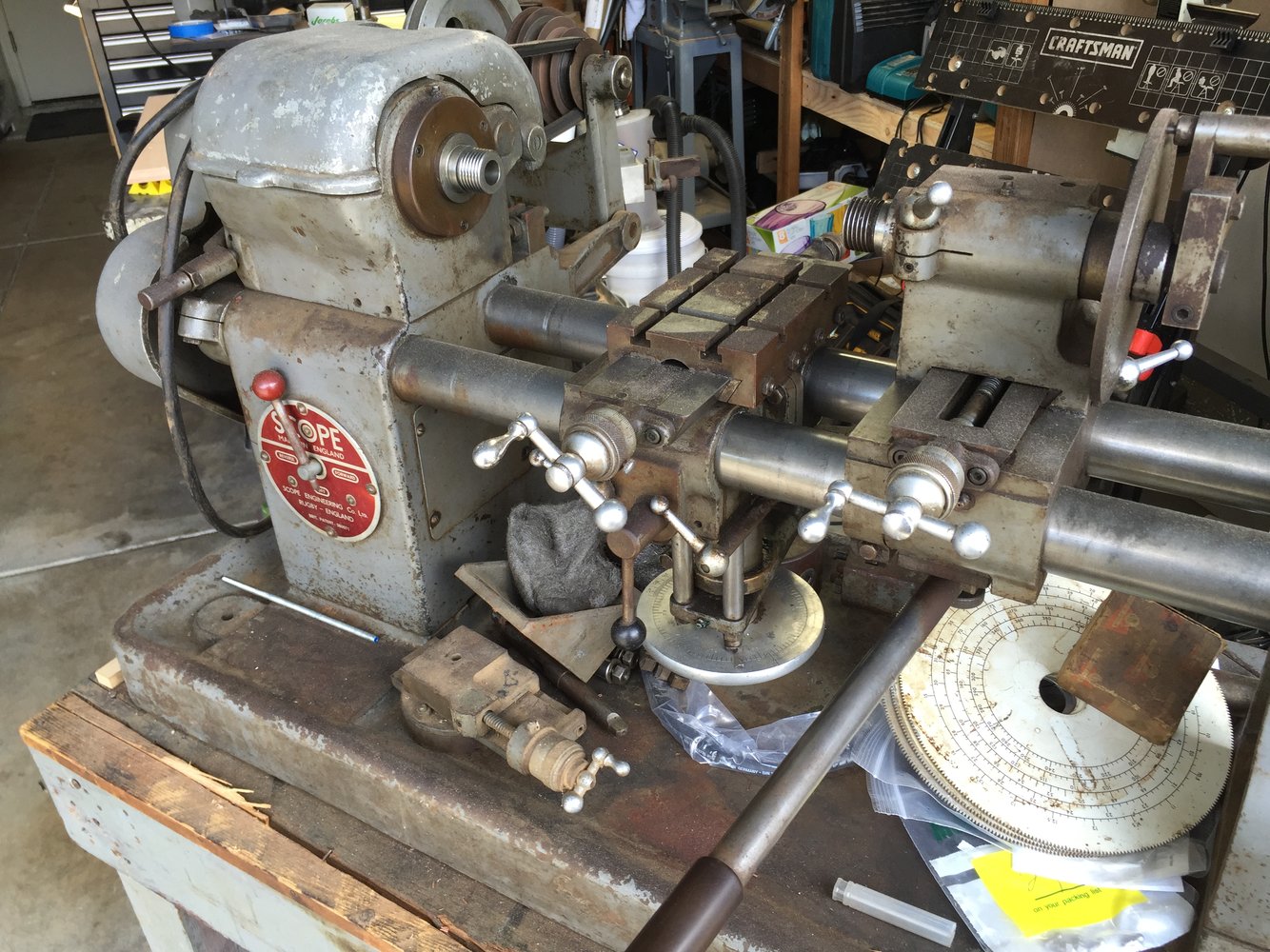

Very glad I've found this post, there's not much on the internet!Nice to see another Scope owner or two out there! Somehow one made it over to rural California and I was lucky enough to find her. Only missing bit is the cable mechanism that actuates the ratchet feed mechanism on the crossslide from the tailstock lever. Mine was in great shape and cleaned up real nice. A before and after of mineView attachment 423961View attachment 423962I’m happy to share other photos and whatnot, I’ve had mine completely disassembled, hit me up with a dm.

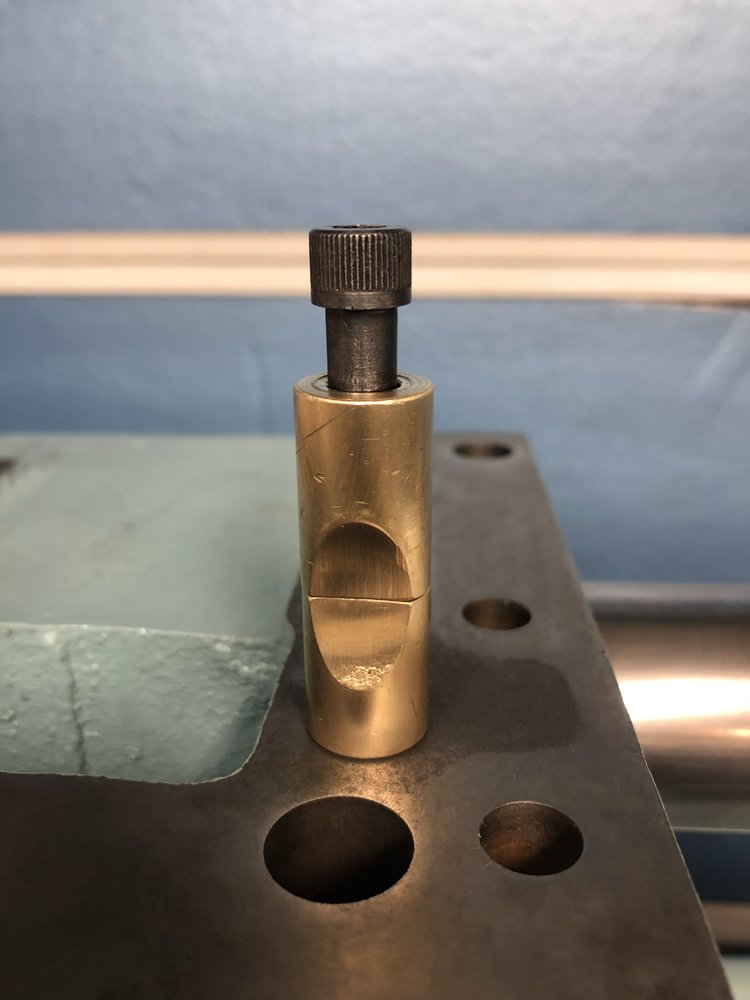

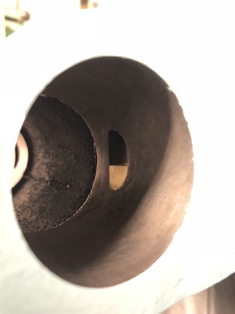

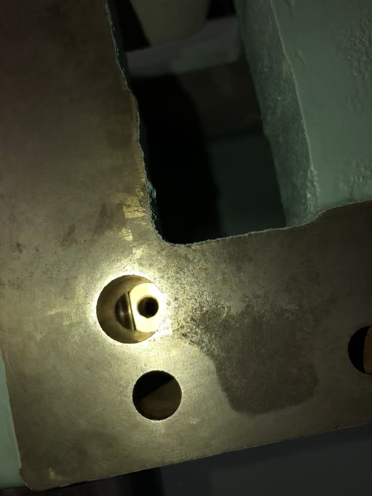

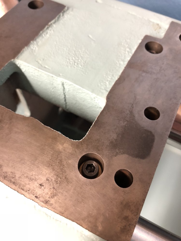

My apologies, I haven’t been monitoring this thread. Here are some pics that should help with how the bars are held in place, both in the headstock and tailstock castings.Very glad I've found this post, there's not much on the internet!
I'm trying to fix an old scope and can't get the rods from the castings, information will be much appropriated!
