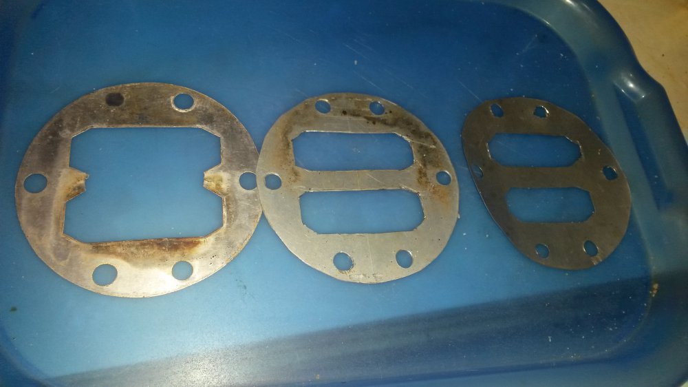

There are no cheap wheels on mine as it's static in a belly locker in a truck with the tank mounted alongside, which isn't making access any easier
I have just looked at the parts diagram again and I think you are onto something. I only found one metal gasket. That's probably because I failed to separate the head from the first valve plate - I think you can see this in the photo above. Time for another
