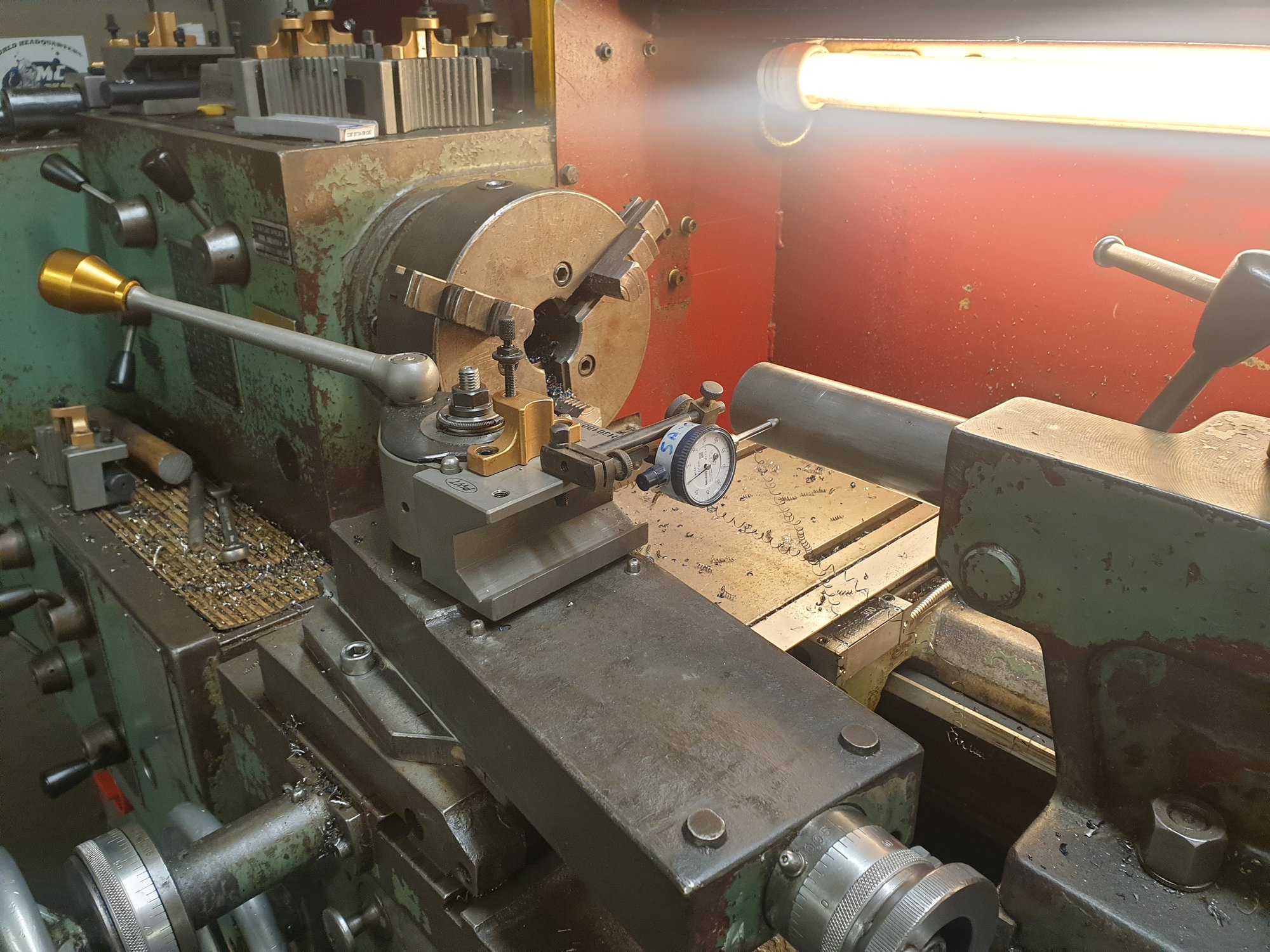

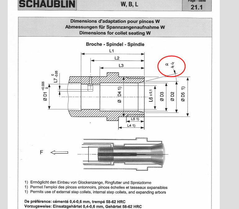

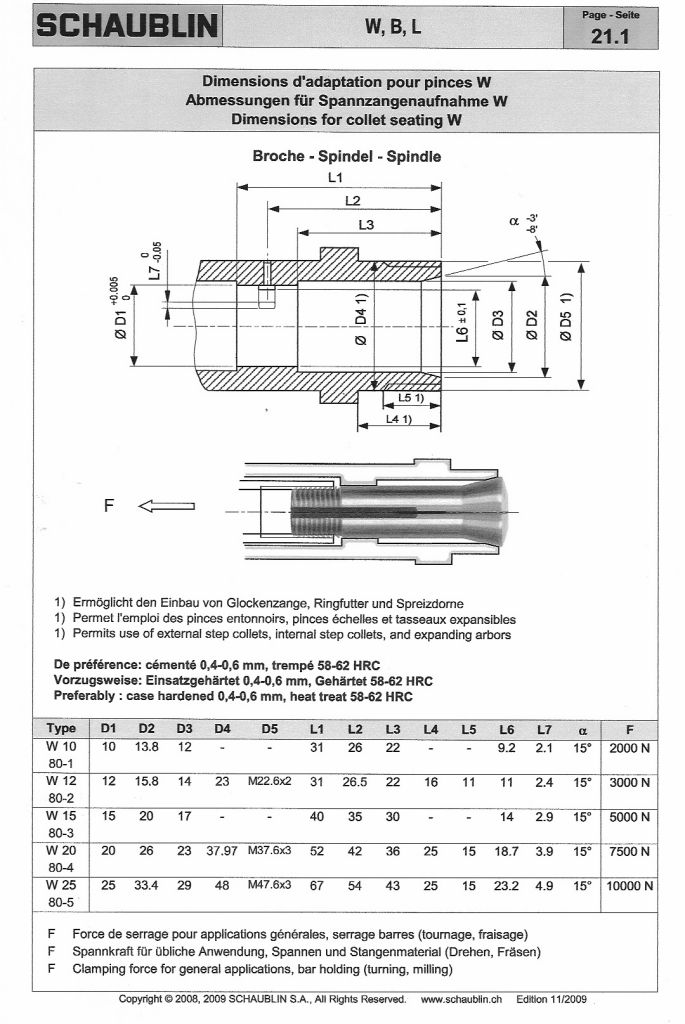

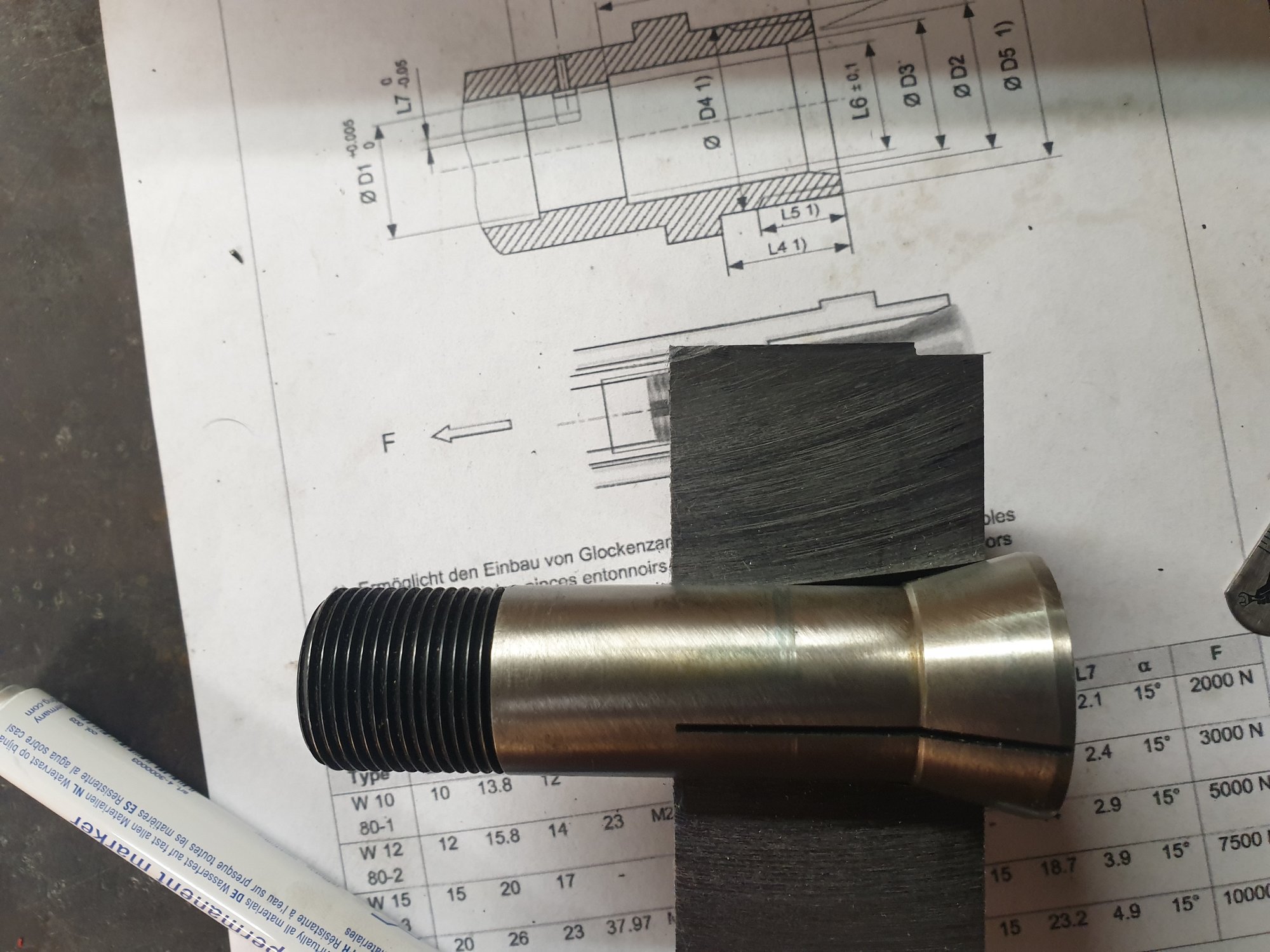

Currently attempting to make a holder/seat for schaublin W25 collet's i bough second hand recently, I found a data sheet for the collet and it states that the collet has a 15° taper up front.

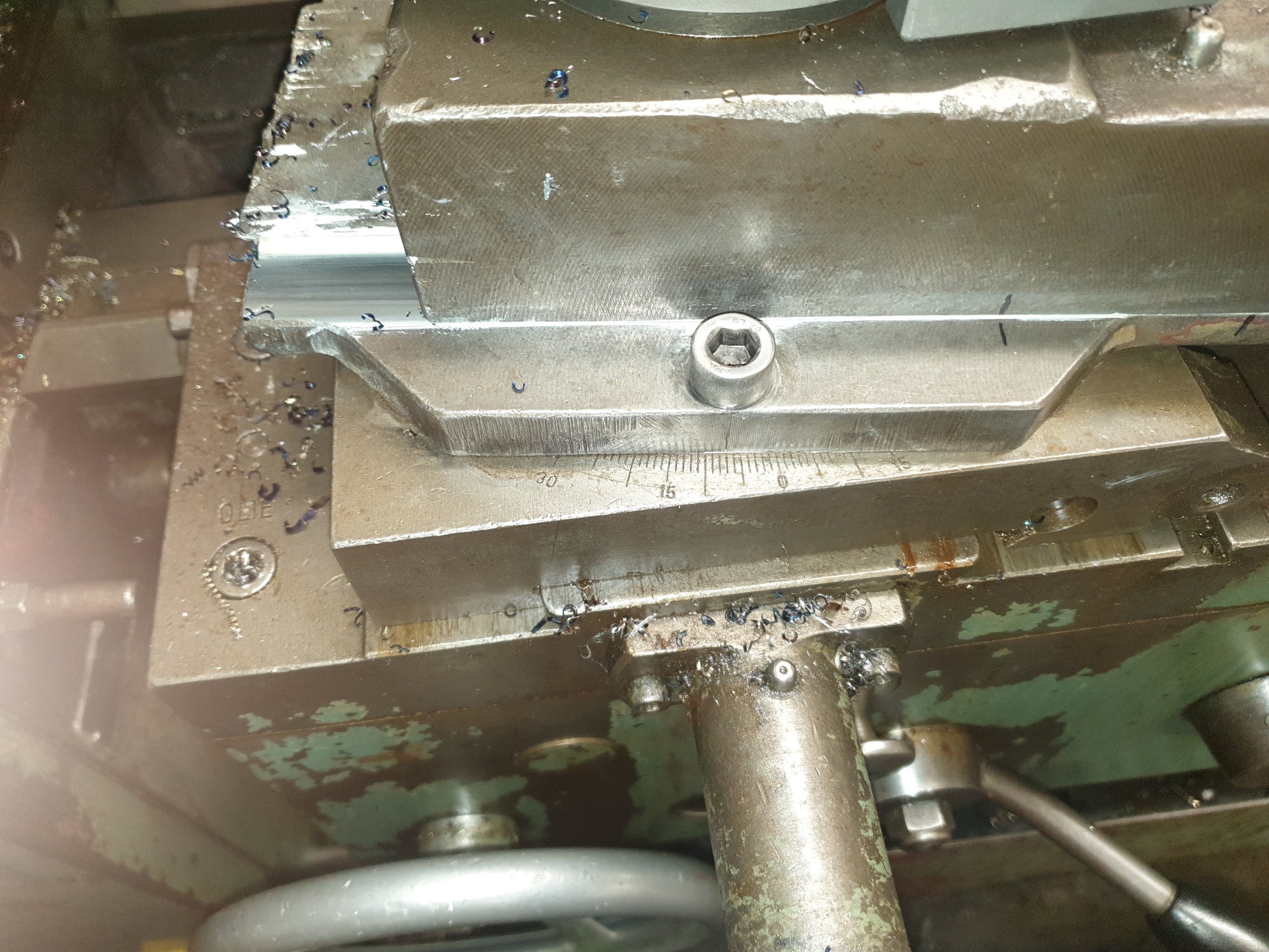

I've set the compound angle using the technique described by Joy Pi in this youtube clip:

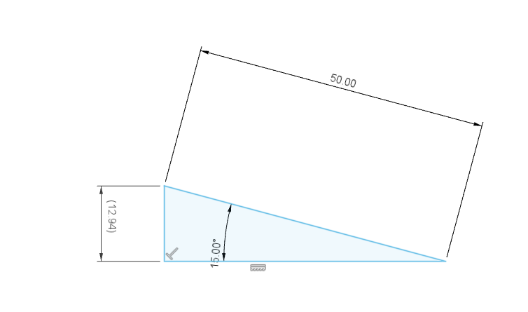

I used Fusion to determine the vertical leg angle, then mounted a dial gauge to my lathe and did exactly as described in the youtube clip. After a couple of tries i got it so that the numbers on my DRO for the cross slide were within 0,01 mm.

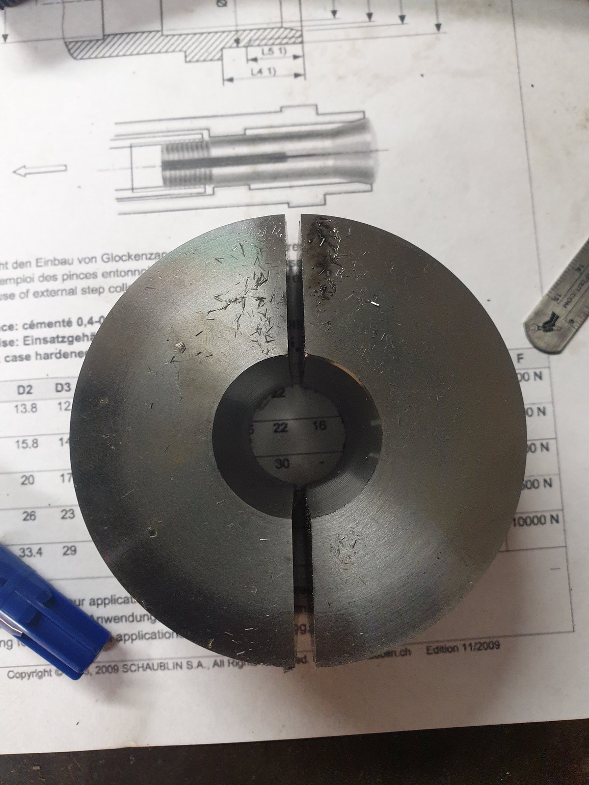

However the result is this, after i made a test piece i cut it in half to see what te result was, the angle is way off from the collet 15°:
So my question, what am I doing wrong? As a disclaimer I have a form of discalculia so I struggle with angles and numbers, so it might be something simple. Am I setting my compound wrong, am I reading the plan wrong? All help is greatly appreciated.
Christof.
