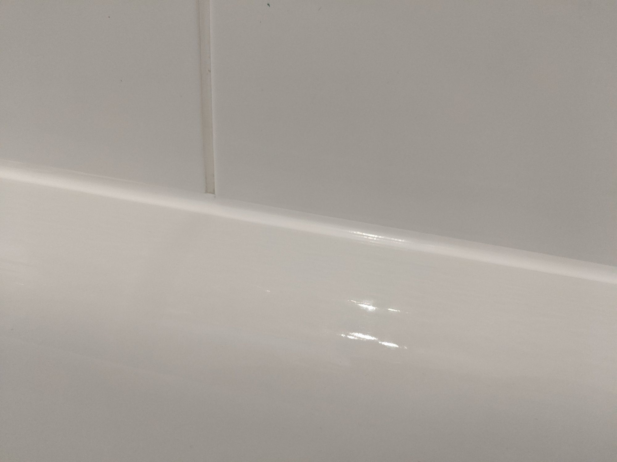

masking tape on the wall then on the bath or shower gun it in .run over with middle finger then pull it off .perfect results every time
what he saidmasking tape on the wall then on the bath or shower gun it in .run over with middle finger then pull it off .perfect results every time
For baths, half-fill with water before starting and leave overnight to set.
For me, straight from the gun squirt with soapy water quick finger sorted.
Just given the bath an annual tidy up, need a lie down in a dark room now. My attempts with a silicone gun are much like my welding - I can lay down 12 inches perfectly, then have to change position or release the trigger and stuff up the good bit trying to make the messed up bit tidy. No matter what - bog roll, baby wipes, soapy water, special tool, expensive silicone - forget it.
Used to use dow corning stuff - it seemed to take a good few years to blacken in the dampest spots. Swopped to Stays white (or some name similar) - and it has. Stayed white.
More technique dependant yet to have it failThe risk with squirting water onto the bead is that as you smooth it out you trap water under the bead and it doesn't adhere correctly and causes the edge to lift.
If you start to get mould on your silicone them the simplest solution is to roll up some toilet paper into a sausage shape and put it over the silicone then saturate with bleach...leave overnight or longer and all mould will have disappeared.
at nobody has mentioned yet is a decent mastic gun makes the whole job a whole lot easier. Forget those cheap orange guns, inconsistent feed & a hand cramp after 5 minutes!
