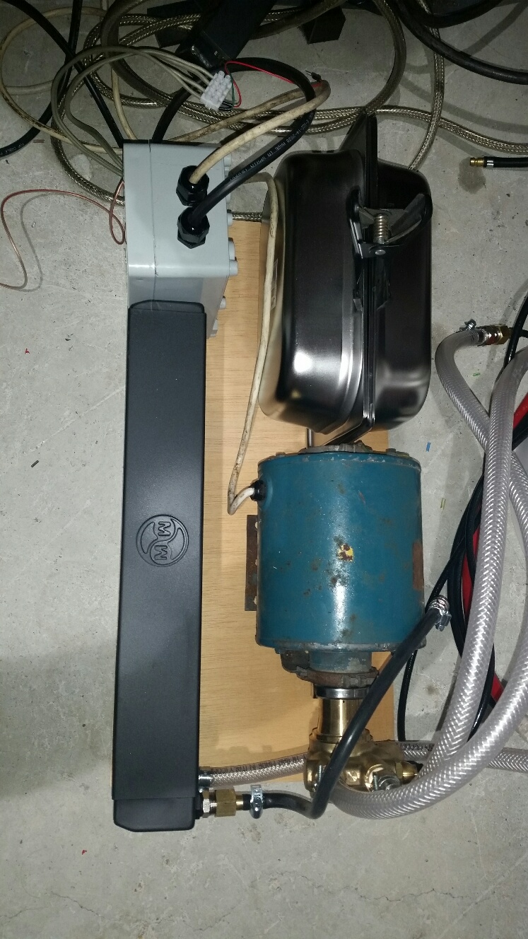

I want it the same size as the welder which is 530mm*260mm but minimal height, so it can stack. May even paint it blue.360mm. Wow that's gonna be a big cooler. Should be plenty mind with 3 fans. Yes the auto stop will help. Just ensure you have at least 1 minute of after run time from welding stop to properly cool the torch.
360mm. Just ensure you have at least 1 minute of after run time from welding stop to properly cool the torch.
I'd be very happy if i could keep mine 150 high.It doesn't need to be that big mind for a 200 amp machine. I'm working on the fronius one at the mo after it spat its dummy and popped a board. That's 450x 150x 150. Tiny thing.
Height is easy to keep down and relatively unimportant. Are you sitting the welder on top?I'd be very happy if i could keep mine 150 high.
Yep i would like to put the welder on top.Height is easy to keep down and relatively unimportant. Are you sitting the welder on top?
The foot print is key to keep down.
You have some sizeable items to try box in.
I think it should all fit. Going to cut a piece of MDF tomorrow and start laying the bits out, then hopefully try welding the tank.I think your quite lucky as your welder is pretty big.
No you made the right choice.Should have gone for the 240mm rad . The tank is hanging out the back a bit.

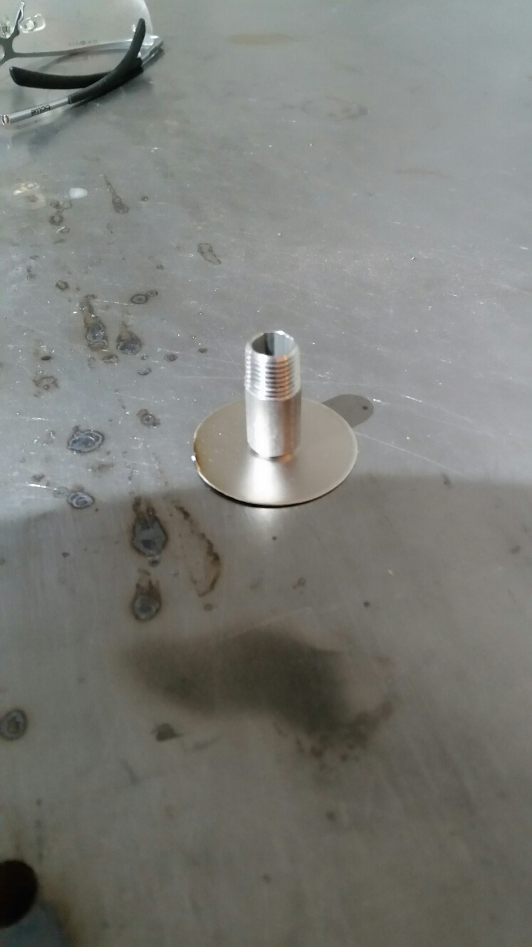

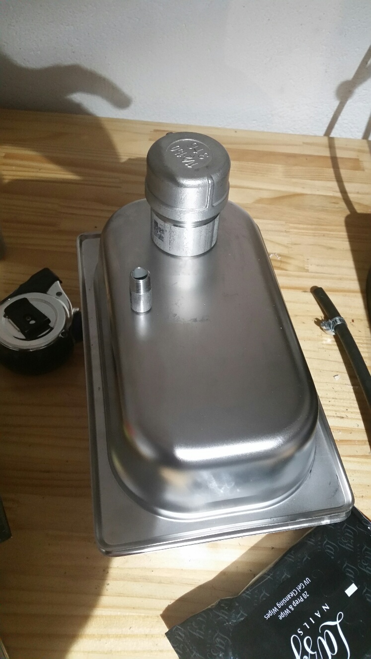

Call me old school. I know u have made a fancy gadget to sense flow etc but would it not make sense to have a way to actually see the flow return. Every one I've made I've always made the return flow visable by removing the cap.Made a start with the tank, maybe i will cut these fittings down? And these need to be shiny before welding?

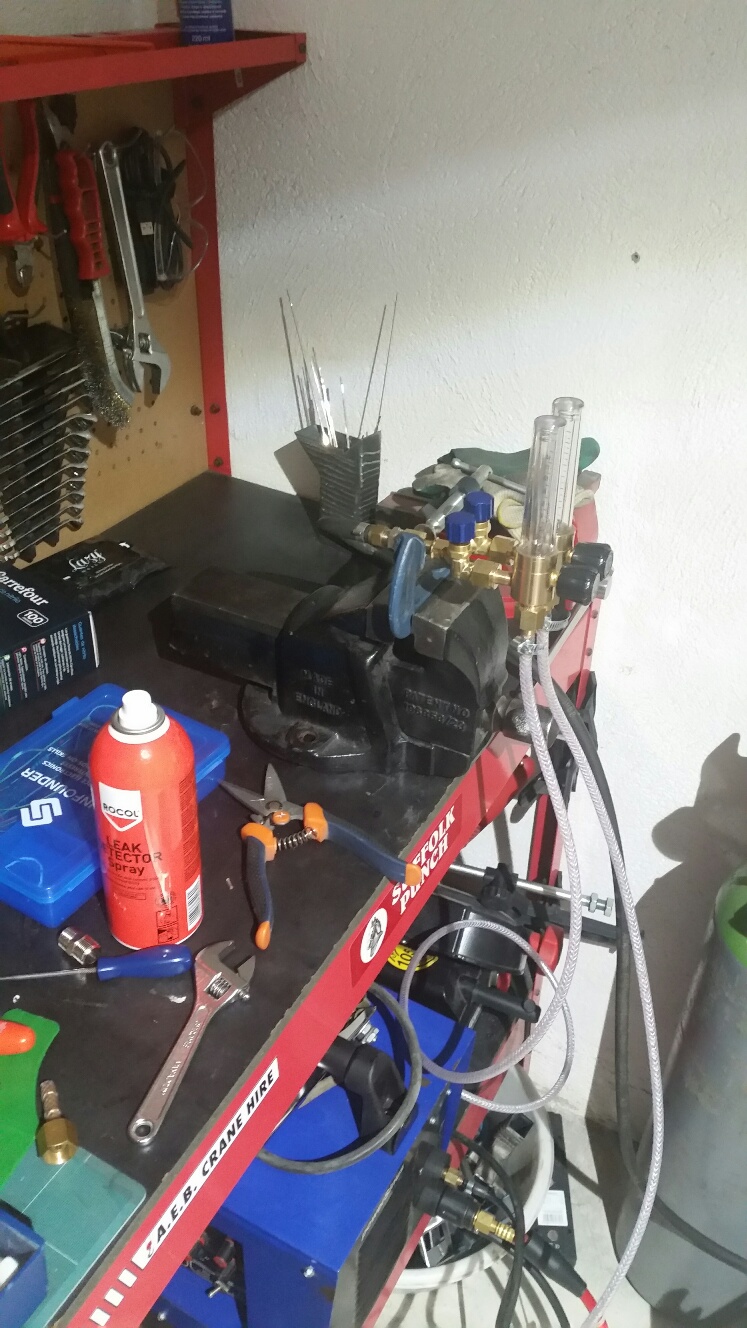

Bodged together a way to purge it (Richard look away now) but its leaking on the threads of the flow meters.

I don't think it really matters with this tank i doubt its going to be usable .Call me old school. I know u have made a fancy gadget to sense flow etc but would it not make sense to have a way to actually see the flow return. Every one I've made I've always made the return flow visable by removing the cap.
It will be fine mate.I don't think it really matters with this tank i doubt its going to be usable .

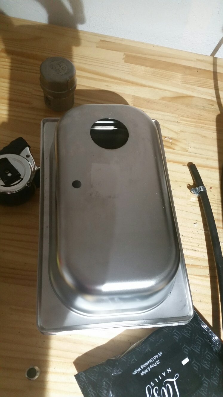

Personally I'd weld all the fittings first while it's open and the back side of the welds can be protected easily with access and finished properly afterwards by removal of heat tint.
I personally wouldn't weld the two halfs together. I'd make a rubber gaskit and bolt them. This way the tank is completely heat tint and oxide free. No issues with distortion and also you can access the inside for a good clean once a year. That's how I would do it.
