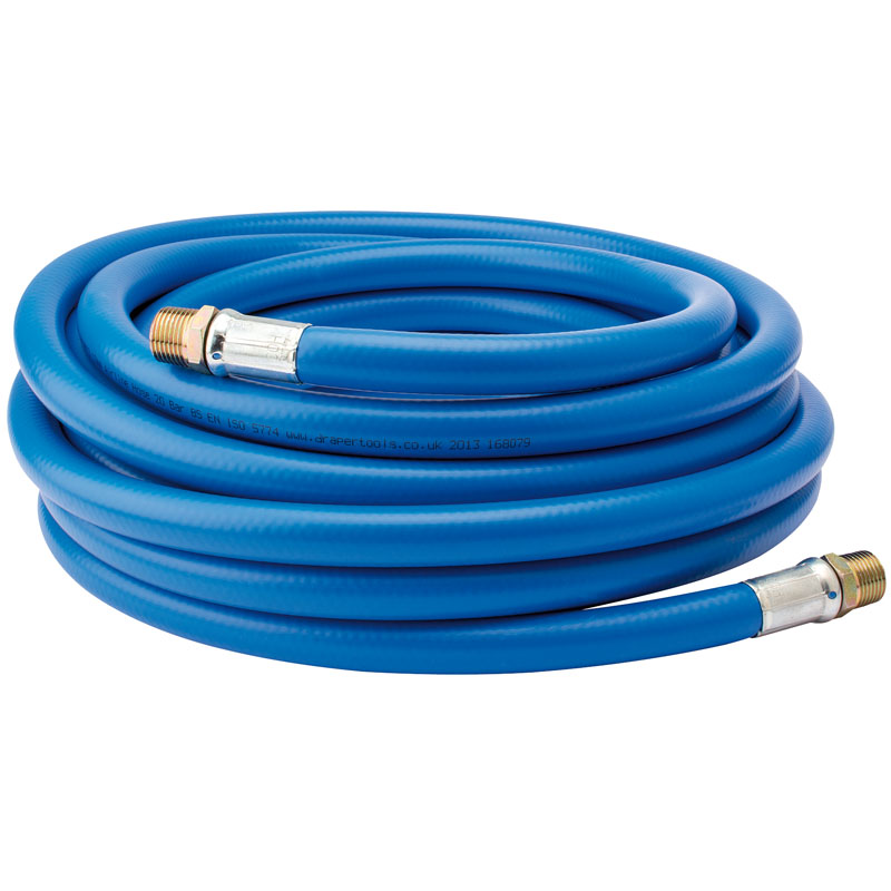

no its far to small 10mm bore minimum and not coiled
I normally use a second tank at the end of line then through a separator that I leave partially open and have no bother even after half an hour . yesterday did some blasting without it in line and within minutes saw water coming out of the separator so it definitely does the jobthere is one other thing to know with sand blasting that is drying your air before it gets to the sand as you will need to consider some sort of system to do this
