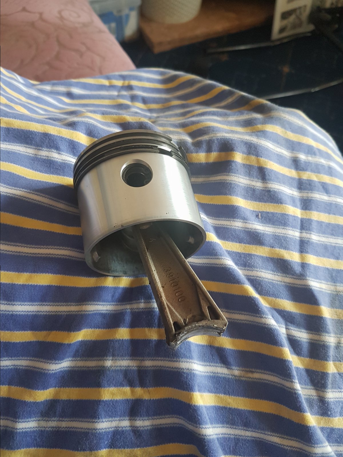

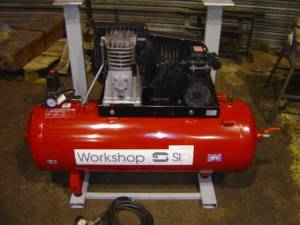

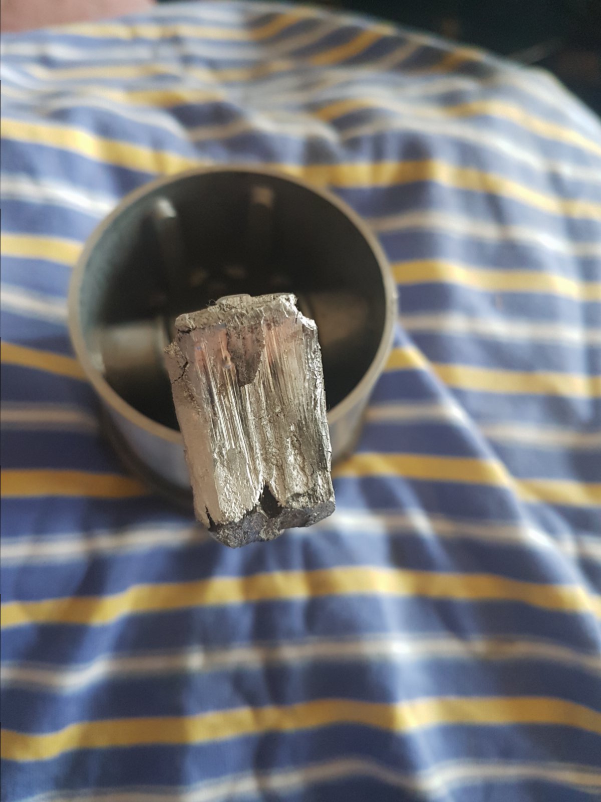

A while back I was using my compressor spraying. It took a while (because i could not hear the compressor) but it became apparent there was low air.
Subsequently investigations found the trip had stopped the motor. I reset the trip and found the motor worked but the belt did not. The reason for this is because the compressor section has locked up.
The large fan wheel turns almost full circle and then meets a bit of restriction and then stops dead. It then does the same the other direction.
Any suggestions please.
