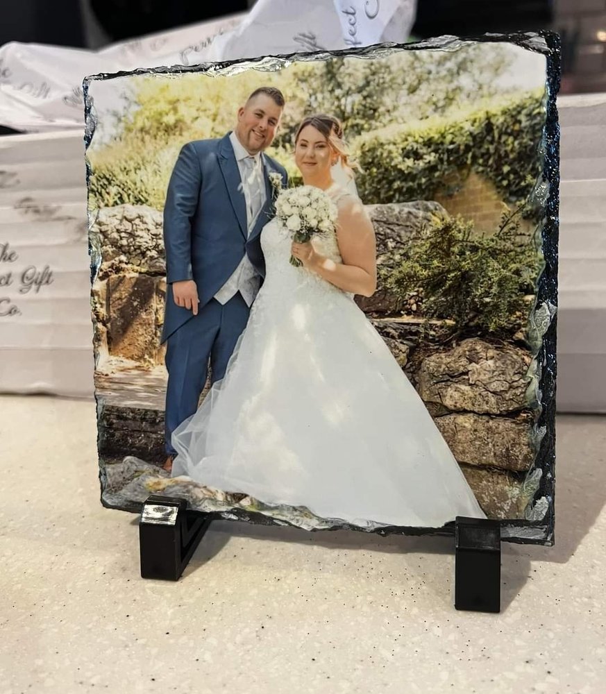

This I am pretty sure is a sublimation slate for example.
