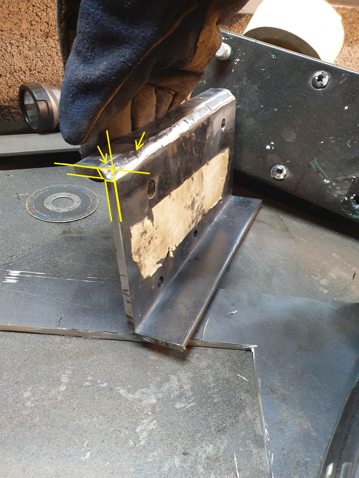

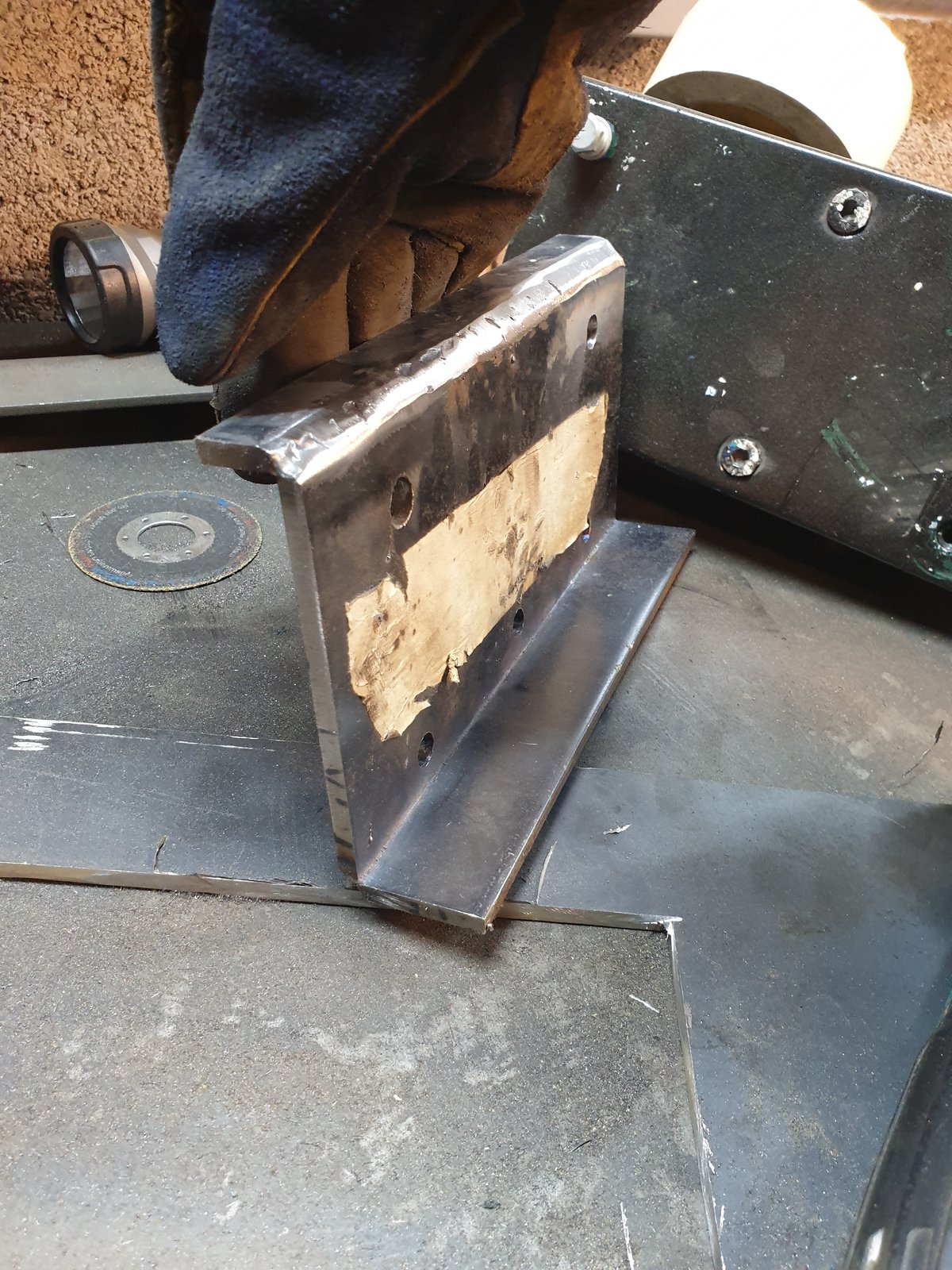

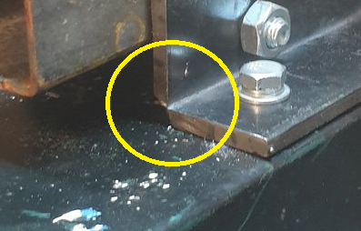

A pin through the beam will be above the problem .. not only underfill but a massive stress riser , think of it like a perforation on loo roll .
