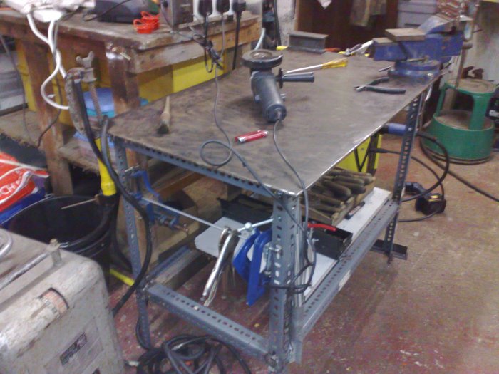

oh too far lol. i'm nipping to the scrappies this week, will have a look what they've got, could do with a bit more steel

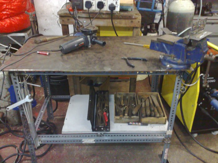

I would move your files from under your bench they will collect the spatter from the mig and buggger them.
If you put your lower angle the other way up your shelf would sit in it not on it. Dexion has the holes in it so you can bolt it together that way you can dismantle it and reuse it.
