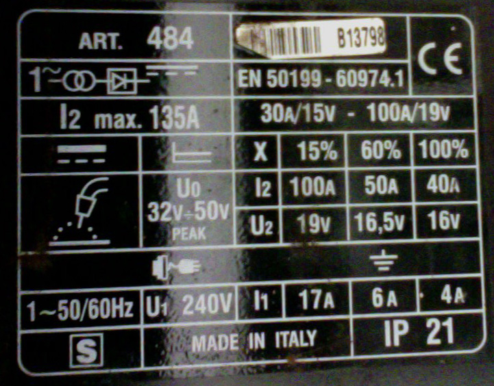

Looks high on lower settings - can you recheck with no wire speed ? They is a data plate on back that should guide youHello Hutcho and a111r
Thanks for all your help yesterday, I appreciate it.
One last question if thats OK?

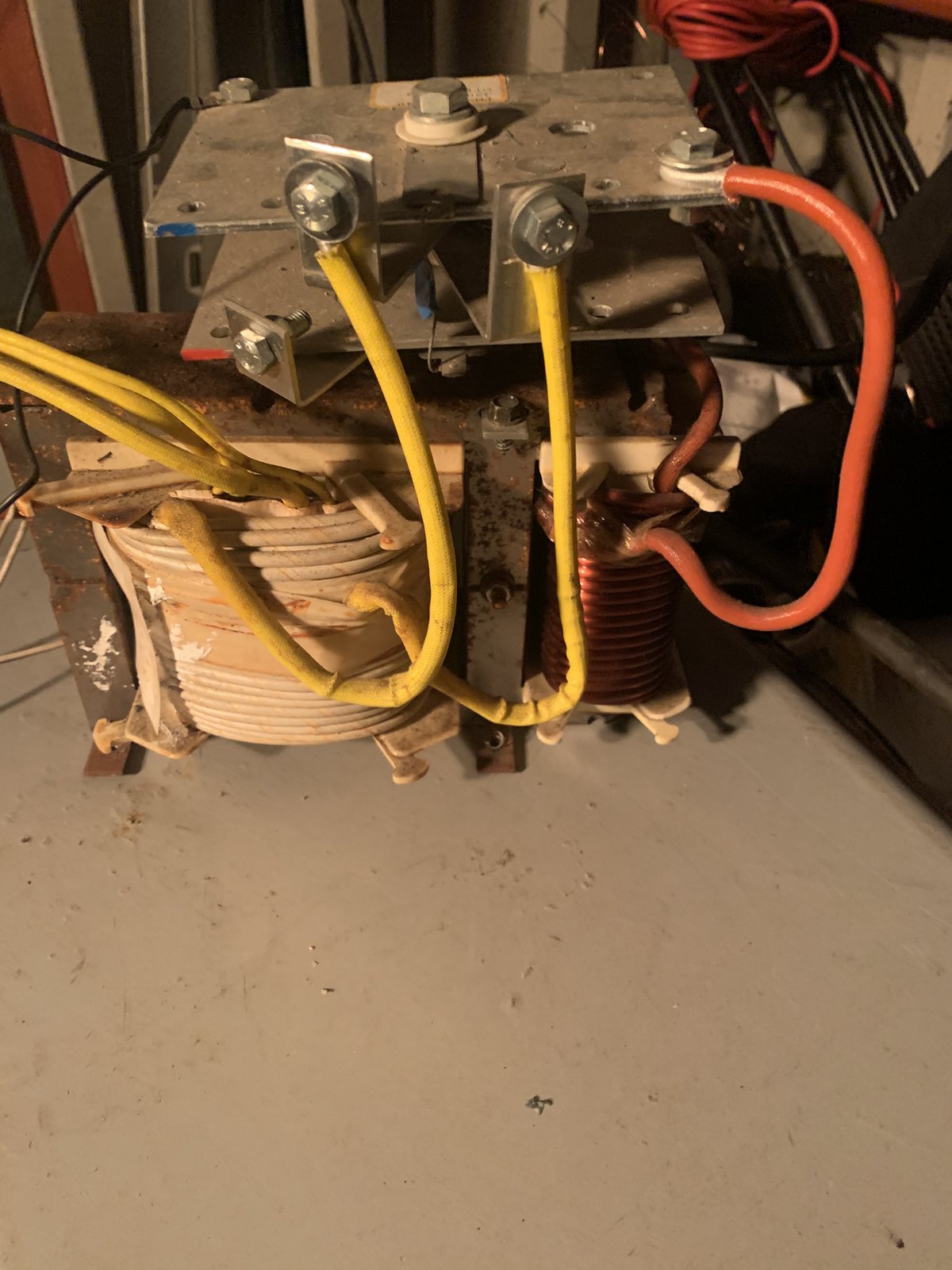

I measured the open circuit welding voltage between the torch tip and earth lead for the various combinations of the power settings.
The voltages are:
1 + min / wire speed 5 = 22.5v
1 + min / wire speed 10 = 26.8v
1 + max / wire speed 5 = 24.8v
1 + max / wire speed 10 = 29.2v
2 + min / wire speed 5 = 27.6v
2 + min / wire speed 10 = 32.8v
2 + max / wire speed 5 = 30.1v
2 + max / wire speed 10 =37.0v
Can you advise if this looks about right?
