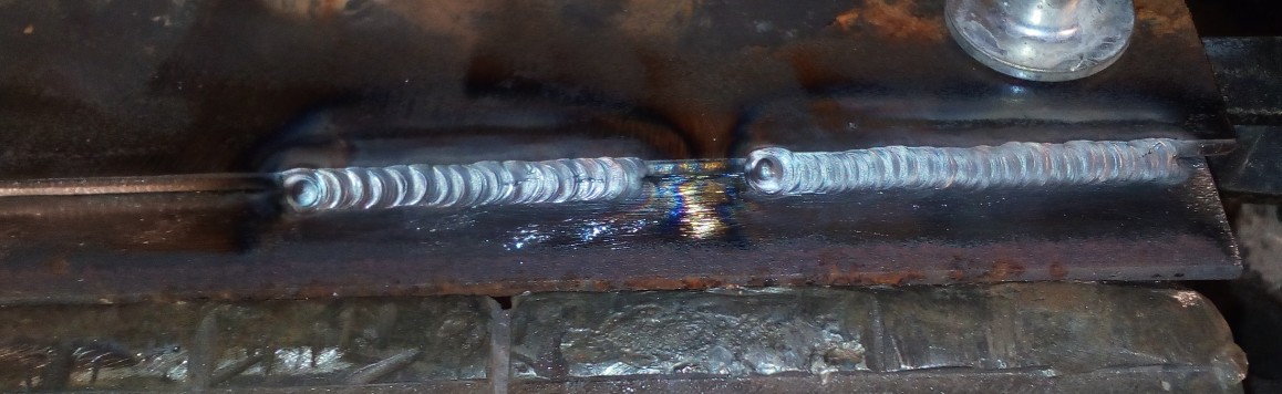

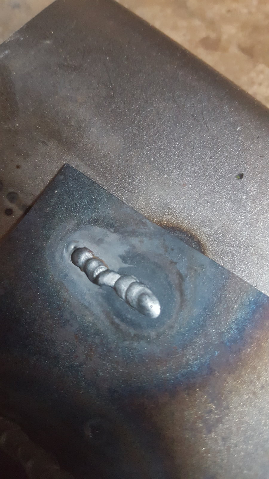

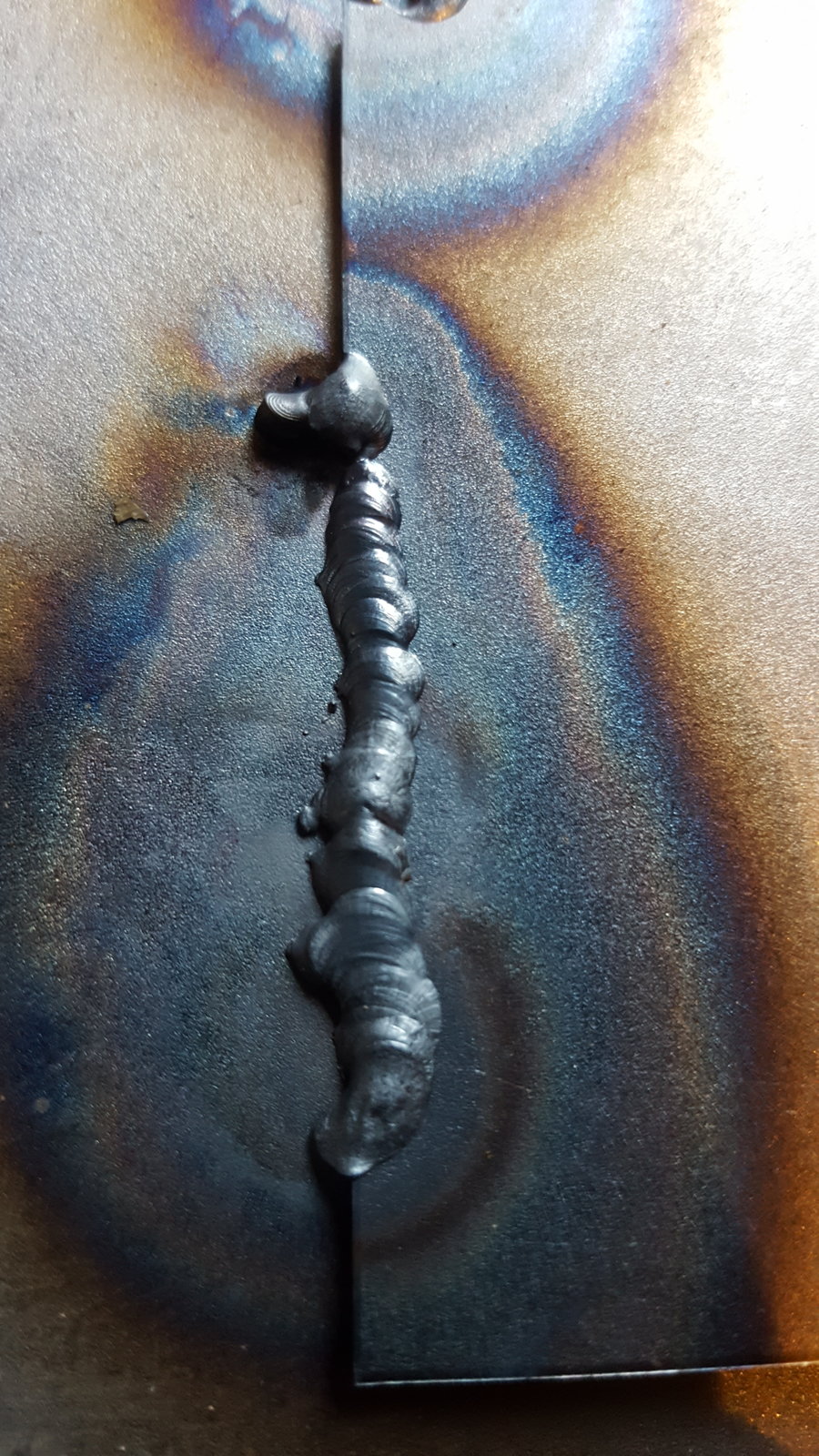

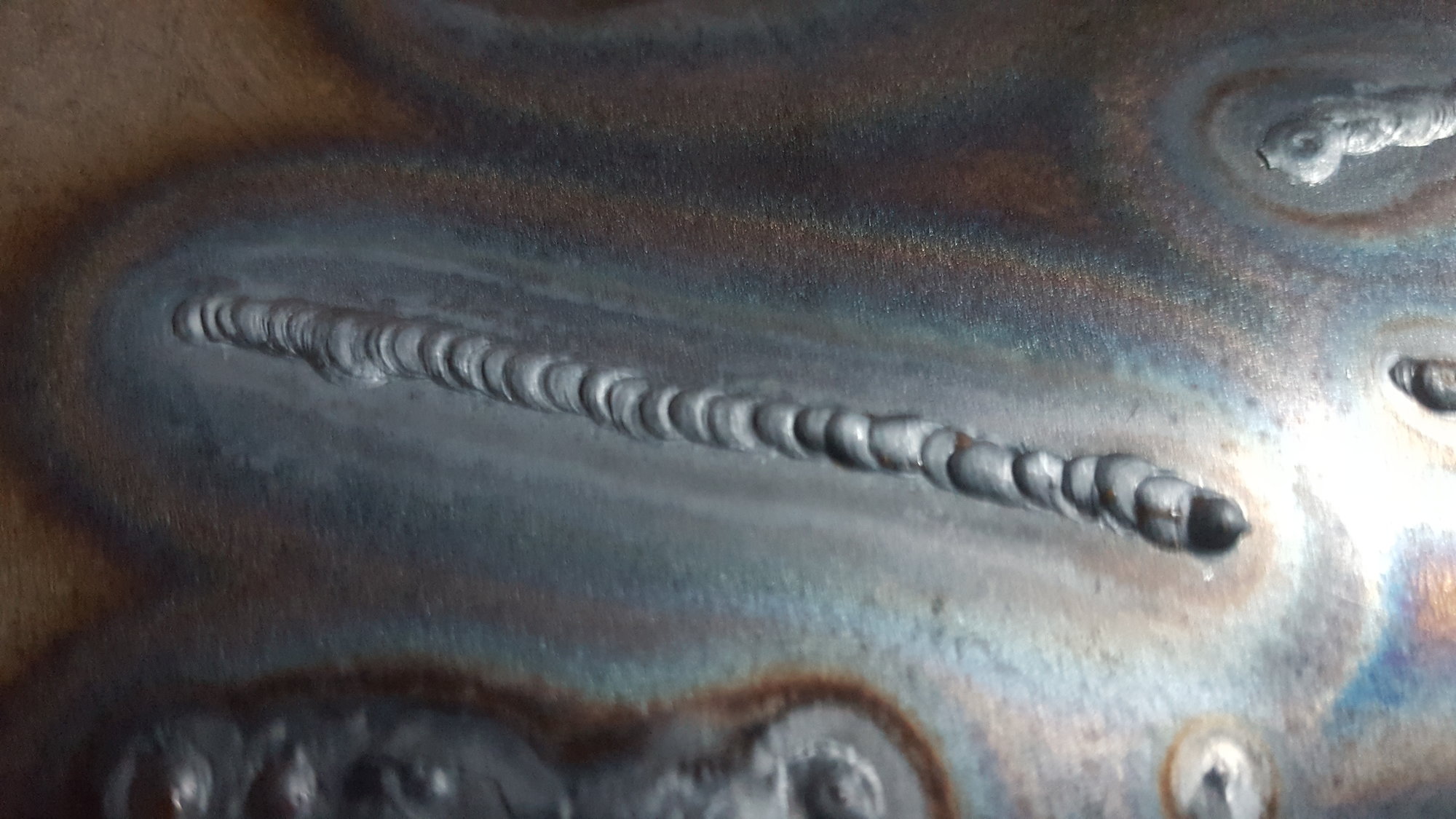

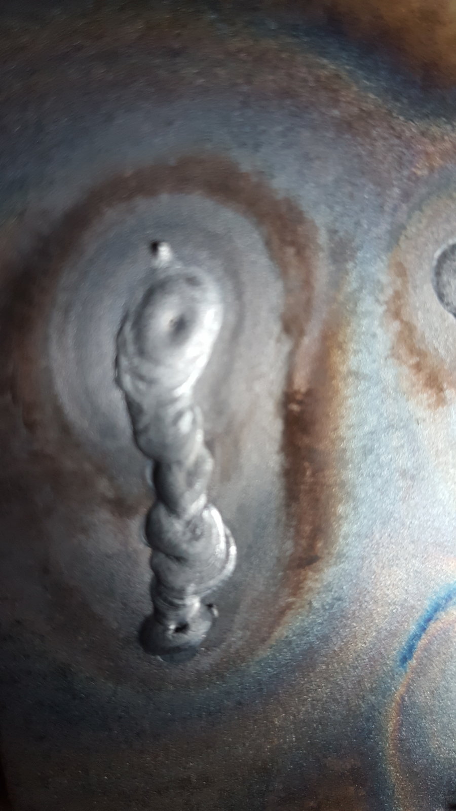

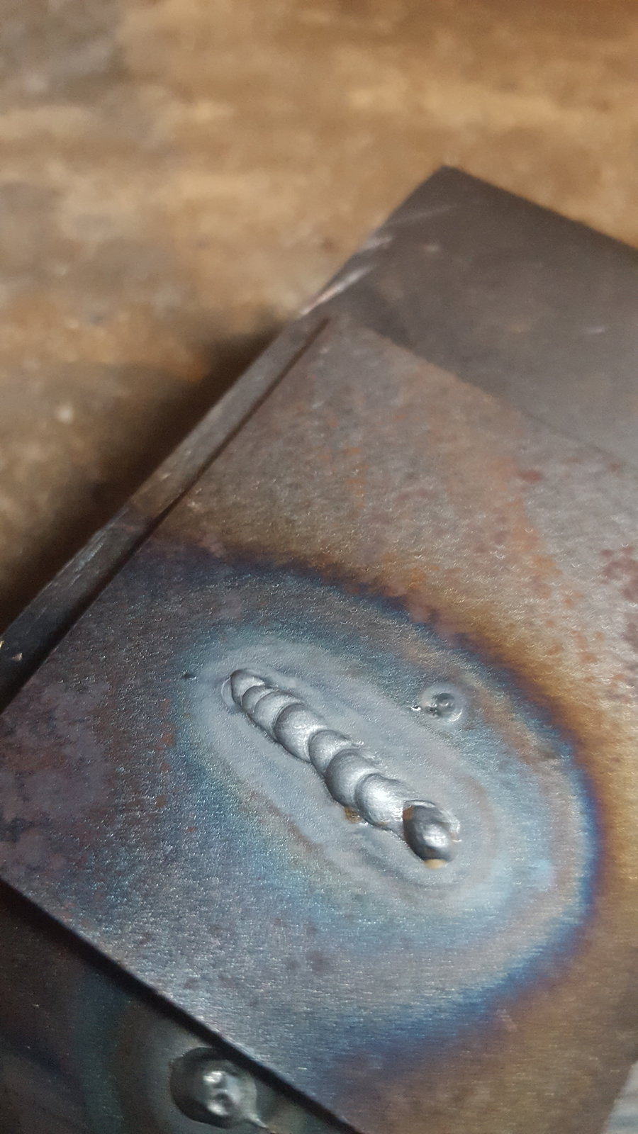

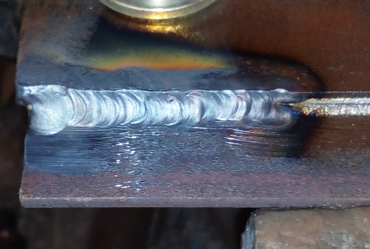

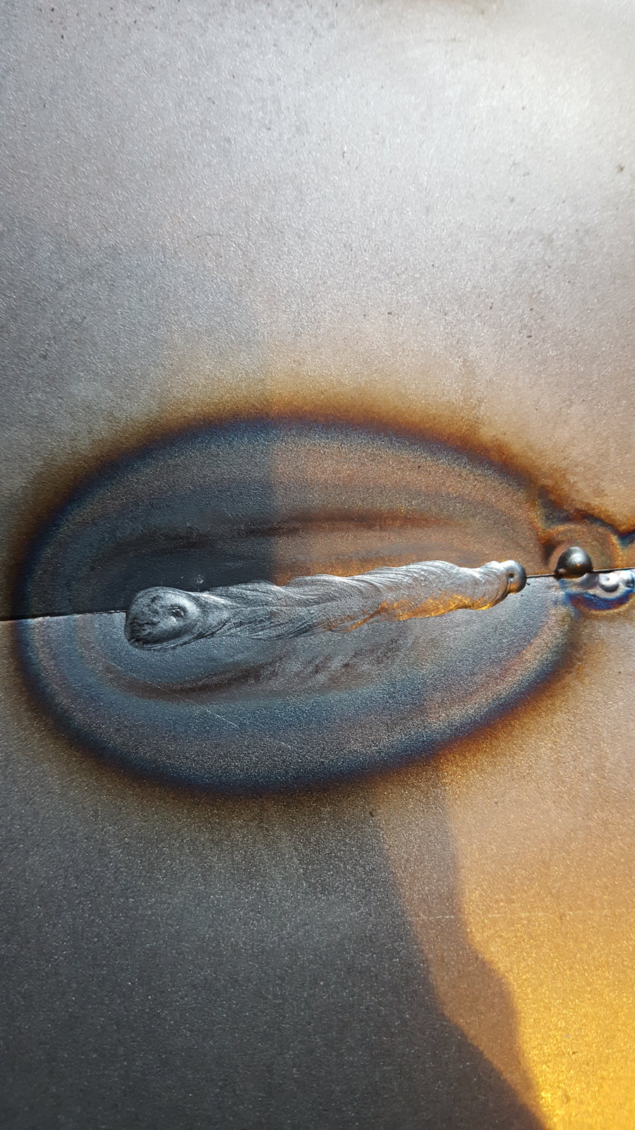

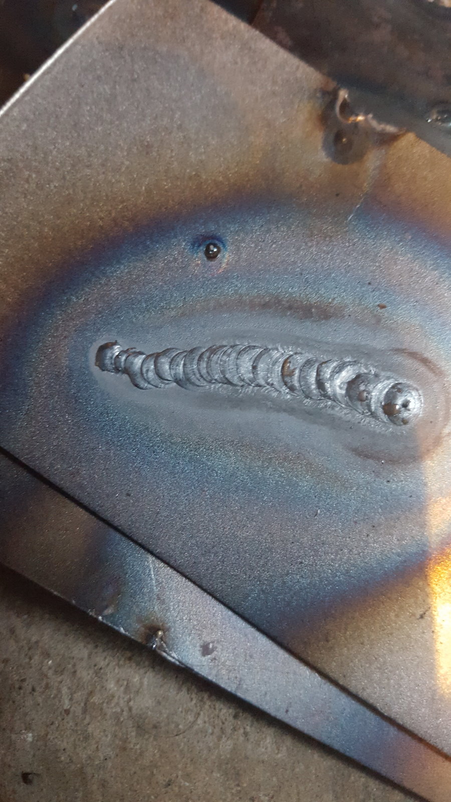

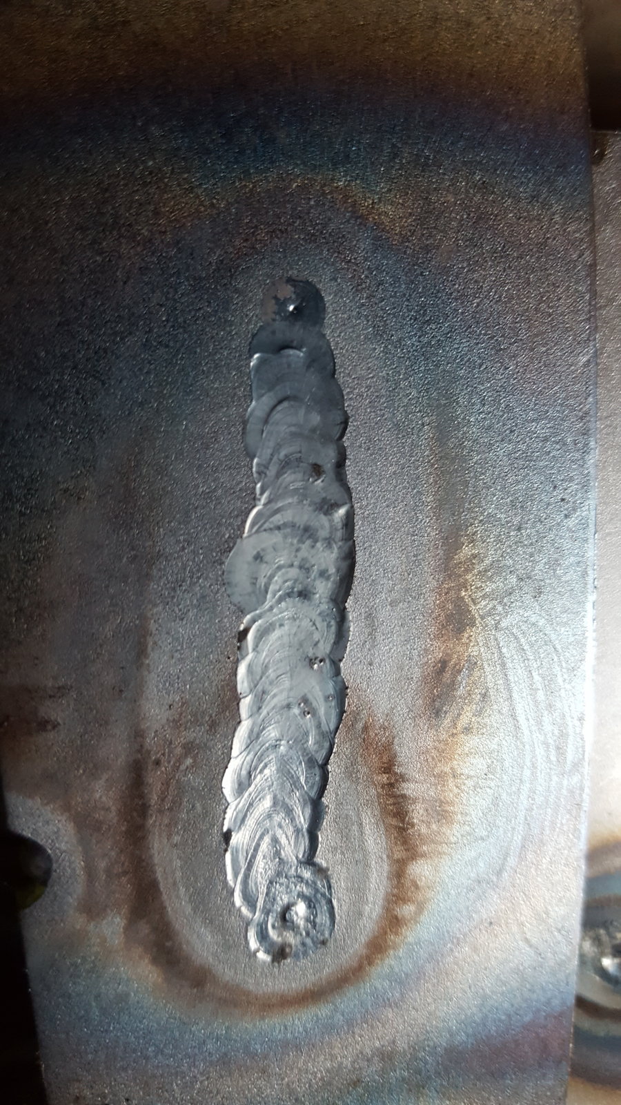

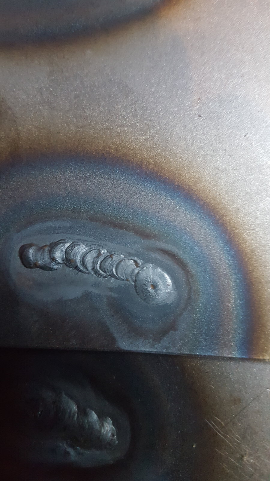

I'm no expert but have had a 4 hour lesson recently and done about 100 bar of gas.
They do look a bit cold but your about right on amperage. Either your going to fast (my problem I suffer with most) or your filler rod is too thick and cooling the puddle too much. 1.6mm will do most of what you'll probably ever do with the set up. Possibly try again with another 5 amps.
If you ever get the chance to shadow somebody it's a beautiful thing tig welding. Imagine your playing an instrument.
Next practice ensure your tungsten is sharp - the arc will mirror the angle of your grind.
10 - 15 degree tilt back of the torch. This gives a leading edge on the puddle and allows you to see.
Strike the arc nice and tight and look for the puddle to form. Once it's formed tiny dab of filler then move up and wait again till its puddled, dab and move on.
Once you've got some confidence and are comfortable it should be a really smooth action of slowly sliding along with the torch and a tick tick tick tick tick with the filler rod in time. Like a clock ticking but not necessarily one dab a second.
Keep up the practice!

today I decided to switch my torch to the left hand and filler in the right.... it felt so much better!!!
