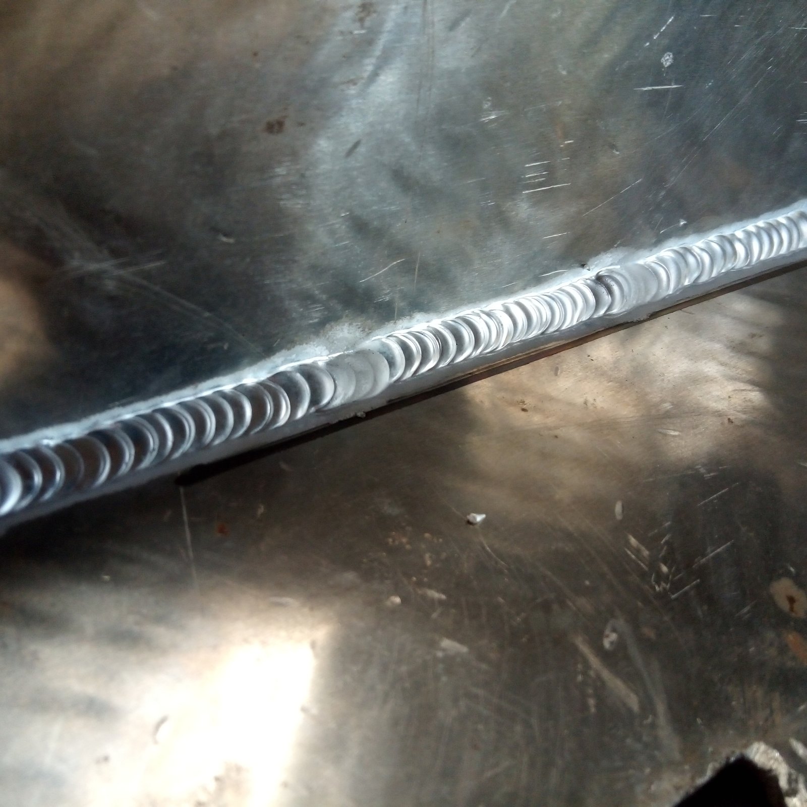

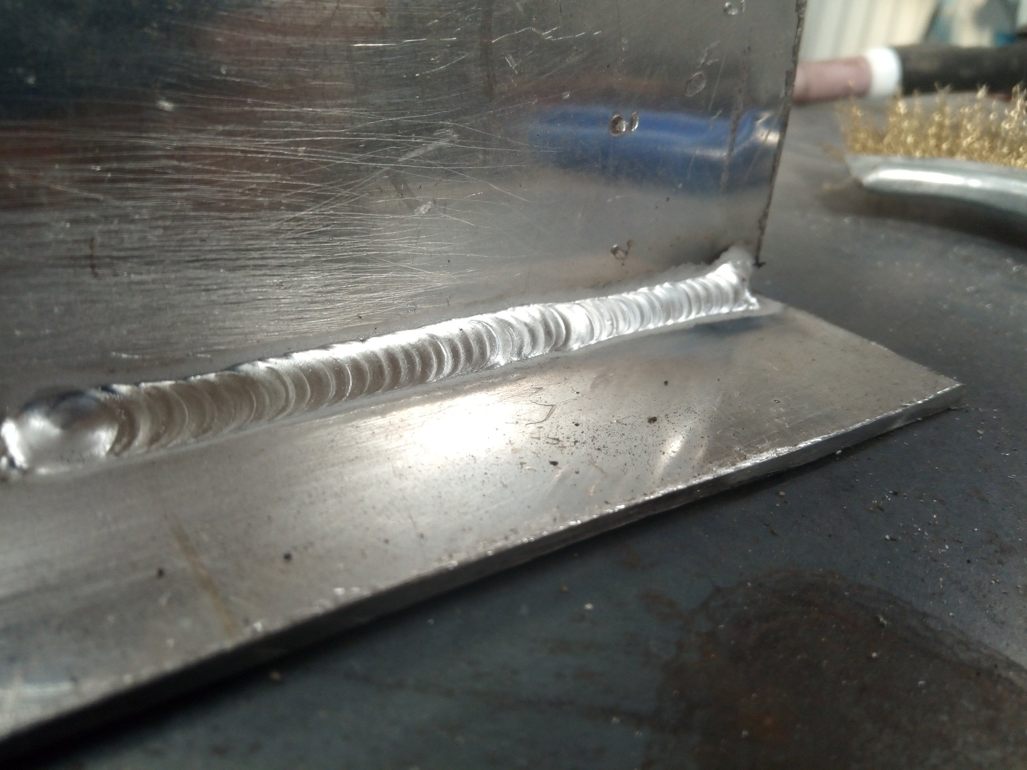

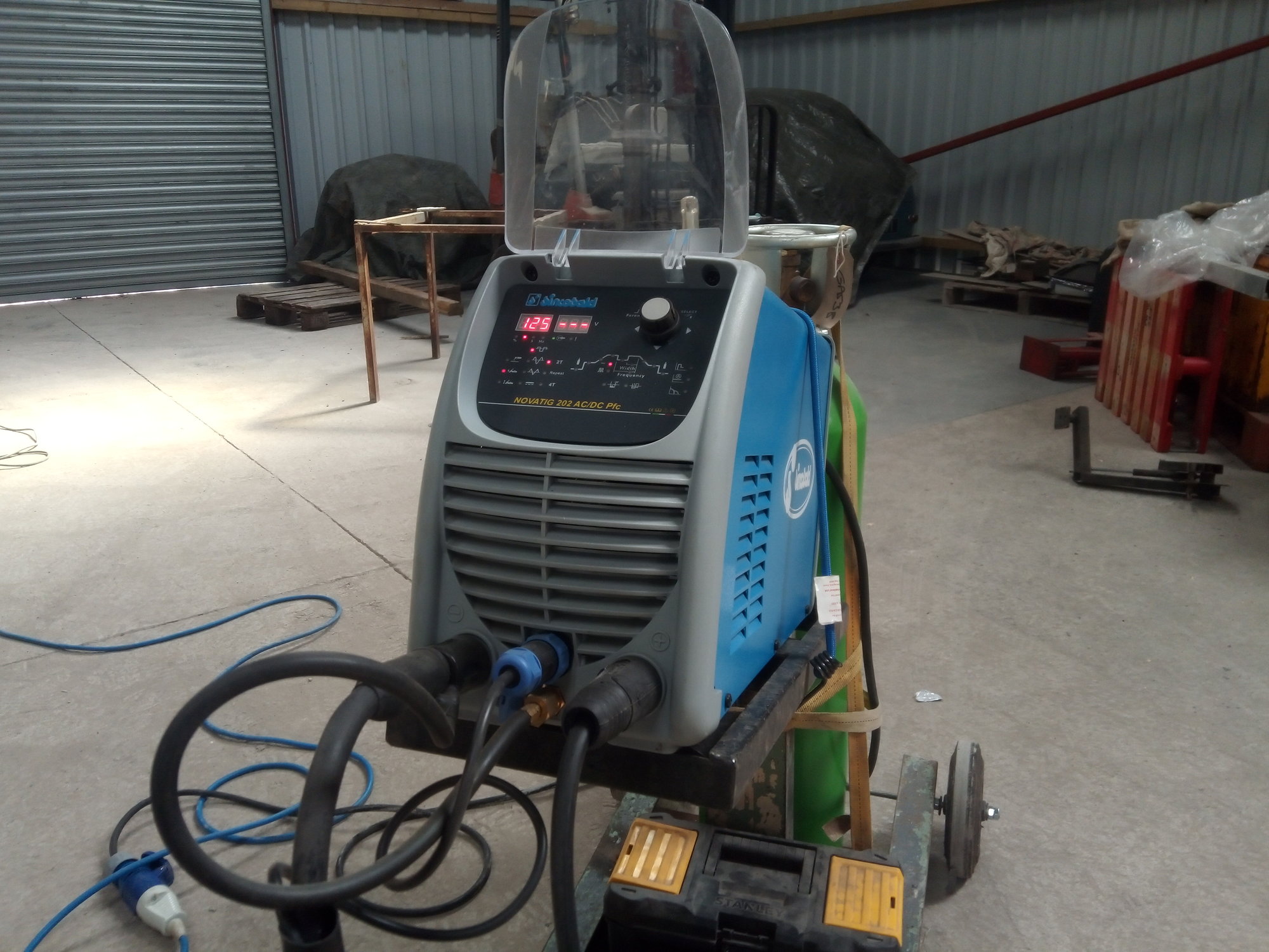

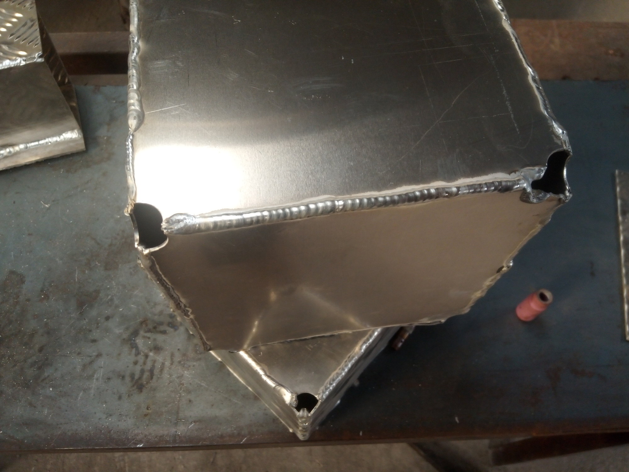

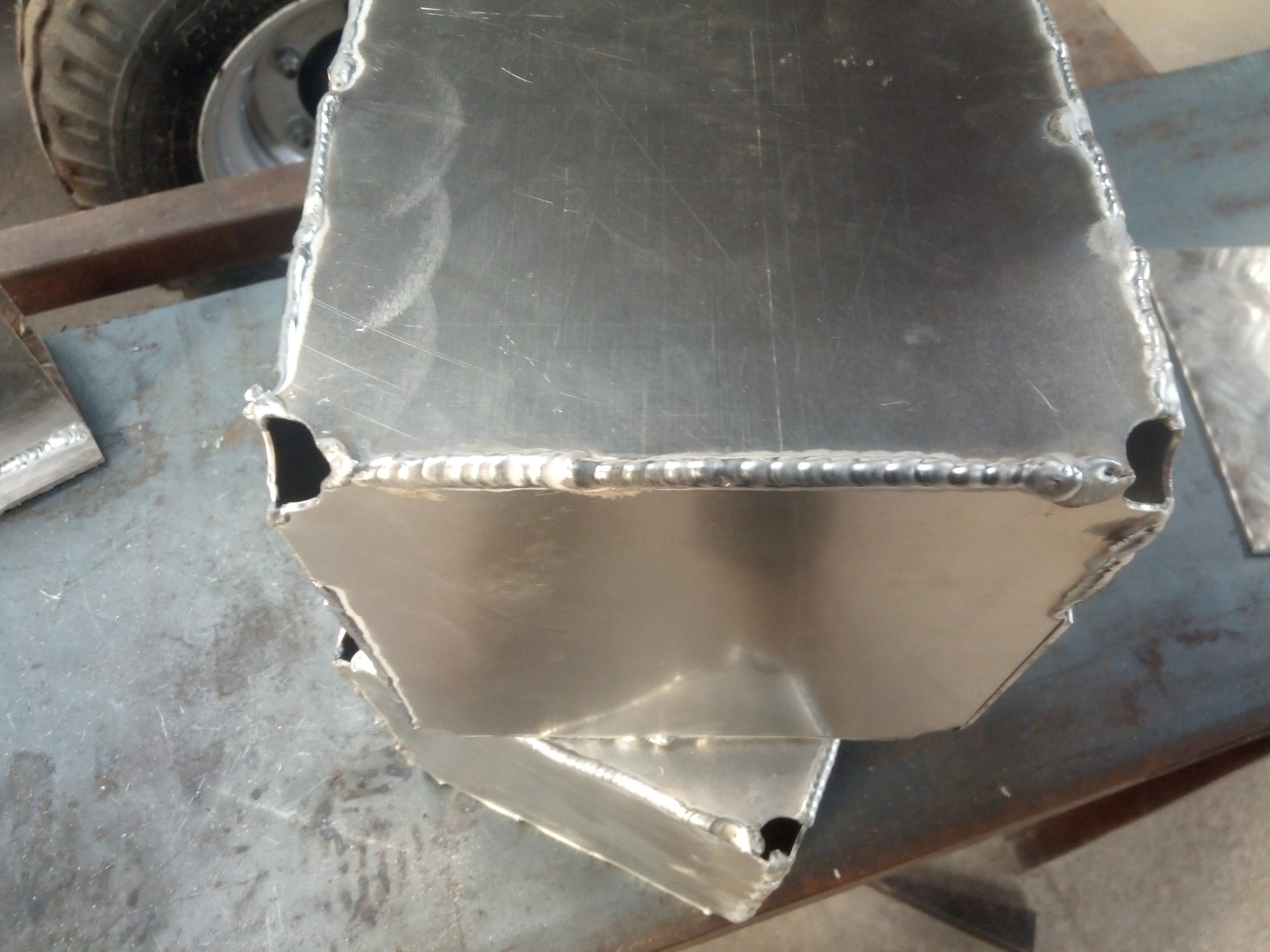

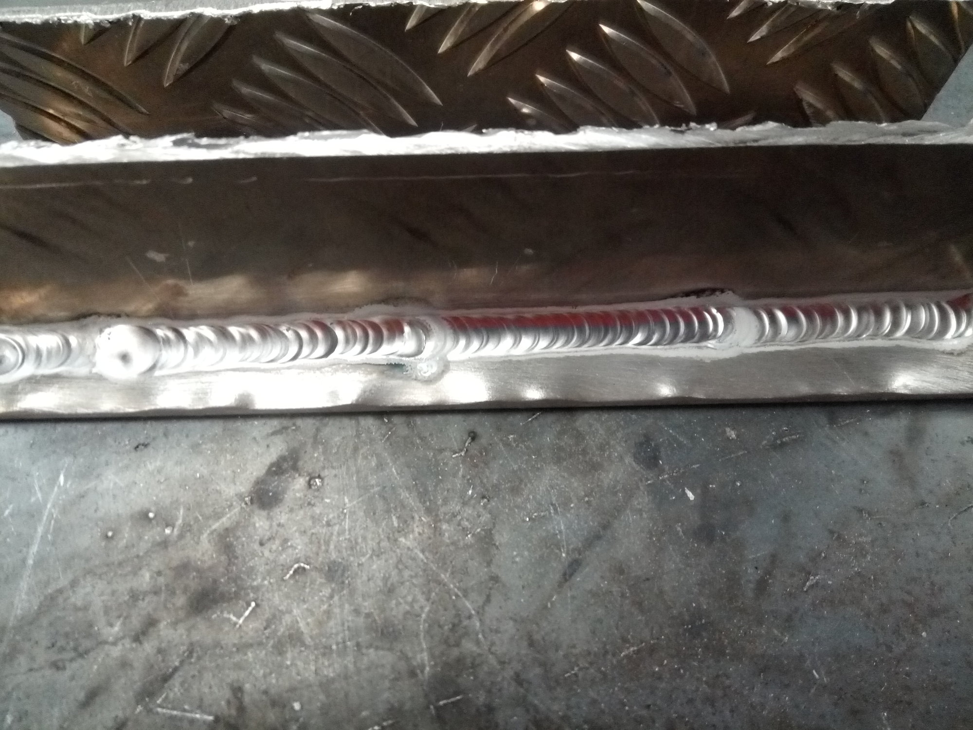

Nothing wrong with that Dave.Did another tee fillet the other day 133 amps square wave 10lpm argon frequency 125

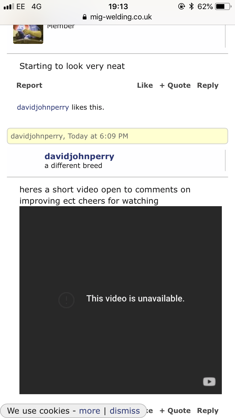

Not working for me eitherNot working
That's perhaps why if you was wired? try again when it's just weirdWired i can see it perfect
