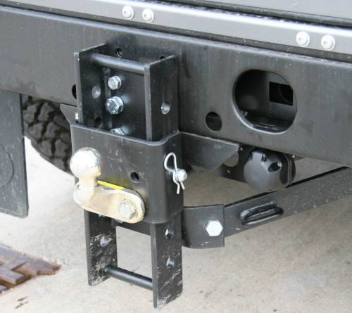

I had a genuine LR NAS 2" reciever hitch on my D2, nothing weedy about, was definitely stout and had substantial bracing to the chassis railsIndeed - I cut he bottom bit off on mine as not needed. Plenty of bracing though unlike the plug in style ones.
I don't like the square tube plug in style. They tend to stick out too far to get clearance. Might be ok onroad but offroad sideways forces can be pretty high.
Dixon Bate adjustable as fitted to older Landrovers are the best I reckon.
