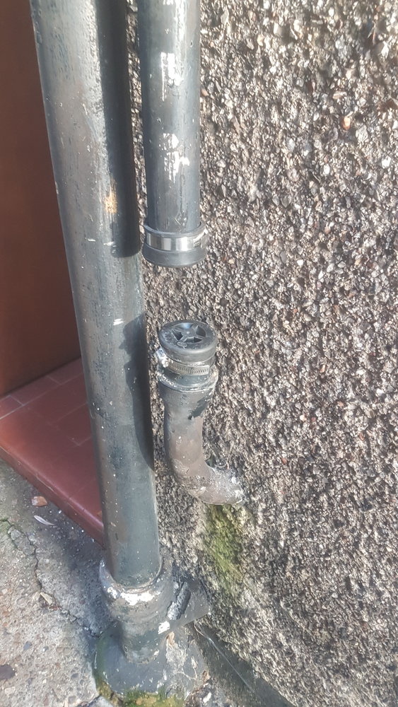

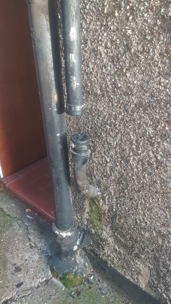

well I have never seen that before,Picture shows vent from sink !
hum maybe, She did mention new owners upstairs so maybe they have done some workWind direction?
Yes it's joined to both propertiesLooks to go upstairs still - so capping it at the bottom might cause issues with it filling with liquid, leaving it open might cause worries about what's leaking? . . . capping closer to the upstairs connection might be better?
Its a different kind of smell decomp critters smell different this is deffinalty a drain/ water kind of smellHi, It could be a rat or something has crawled in there and died, Once decomposition has finished the smell should fade.
Colin
I asked the tennant that question the other day funnily enough.Could upstairs had any work done, and started putting water down it from a sink??
No liquid bone dry and no smell either but the smell may only get forced down when a toilet is flushedWas there any liquid or smell when it was separated?
