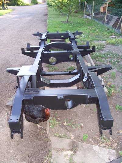

First things first - I am a complete novice and I suspect to get better on the spraying I have to practice - but I dont want to get through all my expensive paint just practicing on the garage door The chassis I did with chassis black - in sheen finish and that came out OK apart from the odd matt area - see pic)

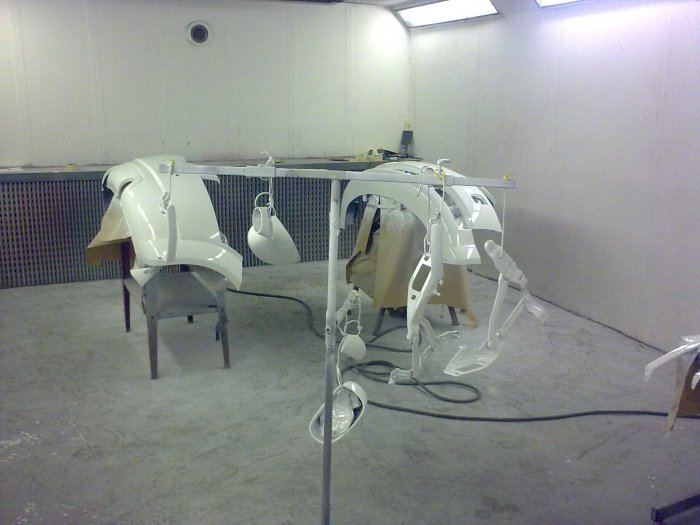

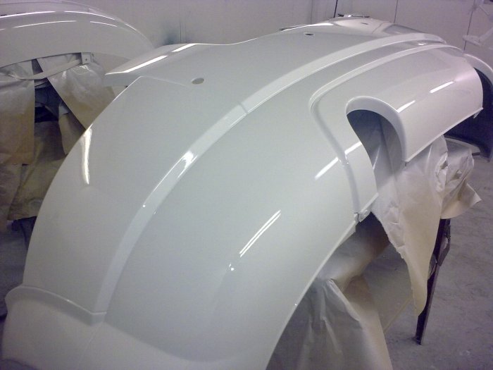

hi mate im a sprayer and spray everyday in a bodyshop
in my expirience i will only stick with well known guns! as they will always give you top preformance and will last a life time!
finish wise you should consider these points!
Paint thickness air pressure and spraying distance are the key to a good finish, not forgetting correct gun setup!
i will not spray any top coat above or below 2bar! obviously unless doing a very small accurate blowin.
as for your paint i dont like cellulose! the only good thing about it is it dries very fast and polishes up like glass.
Cellulose is hard to get a good finish as it drop glosses and will sink so in time it may show up any repairs!
A 2k paint will be better like cellulose it is direct gloss but has better properties and if prep work is done correct it wont sink for years!
Paint wastage will occur if you are spraying too high pressure getting blowback as the paint hits the panel and attomizes poorly and bounces back and possibly if you ar using anything above 1.4 fluid tip as it will chuck th paint out !
hi mate i have 5 guns ! 2devilbiss 1 iwata and 2sata! hvlp(high volume low pressure) 2bar is perfect if you tried basecoating more than that you would get striping! that the standard pressure in the trade for top coat with modern finishing guns

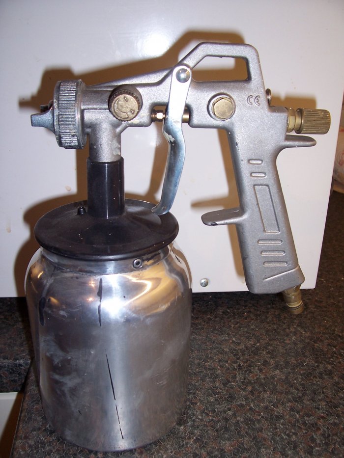

Also thinning ratio depends on the gun as well as the user for us DIYers. No idea which gun Kernite has, but have you ever tried spraying with a gun that came in a family pack of air tools for £20? They can be quite sensitive.
haha i did start with a family pack and i dont think my boss would allow it in the shop lol! if it was me no matter how expirienced i would stick with quality known paint lets face it thats what you will be proudly looking at every morning you see the car and for all the hard work you want it to last
ha bloke next door got one of those packs and couldnt get the gun to spray so without thinking i stuck it onto my airline and bang paint eveywhere it was a pressurised gun not syphon not to mention the once flat botton of the pot was now a convex dome.
well thats something you only ever do once
It might be helpful if you would put up a pic of the gun someone might recognise it, if it old and suction then more than likely would be a conventional one, does it have any indications about what size the cap/fluid tip size it has on it

not wanting to insult you but i would get another gun that one doesnt look as though its up to much have a look here and see the difference the gun you have looks very old
Seriously, throw that gun away, quite honestly they are the worst of the worst!
Even upgrading to something like the 02132 in this PDF will give a marked improvement.
I had a 'family pack' gun as Malcolm calls it and tbh, it is utter rubbish.
I bought a SIP gun similar to the 02132 one and although it's probably nowhere near DeVilbiss quality, it was nowhere near DeVilbiss price either.
Certainly a major step up from those multipack ones.

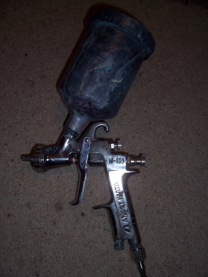

I have been leant a professional spray gun (Anest Iwata - see pic) by my local body shop (to whom I will be eternally grateful) and what a difference it makes. I now get a wide fan so 50% overlap is possible - I was only getting about 2" fan with my old gun which produced tiger stripes and overlapping was difficult.
If I change the horns I can now see the fan changing 90 degrees whereas before nothing much changed which is why I was unable to work out which way to have the horns.
When I change the feed screw I can actually see the spray pattern changing whereas before nothing much happened.
So setting up is now possible. I now just need to find the right paint mix for optimal finish.
I'm now raiding the piggy bank to see what is the best gun I can afford. The one I am using is gravity fed - which is better, or what are the pluses and minuses of gravity versus suction guns.
