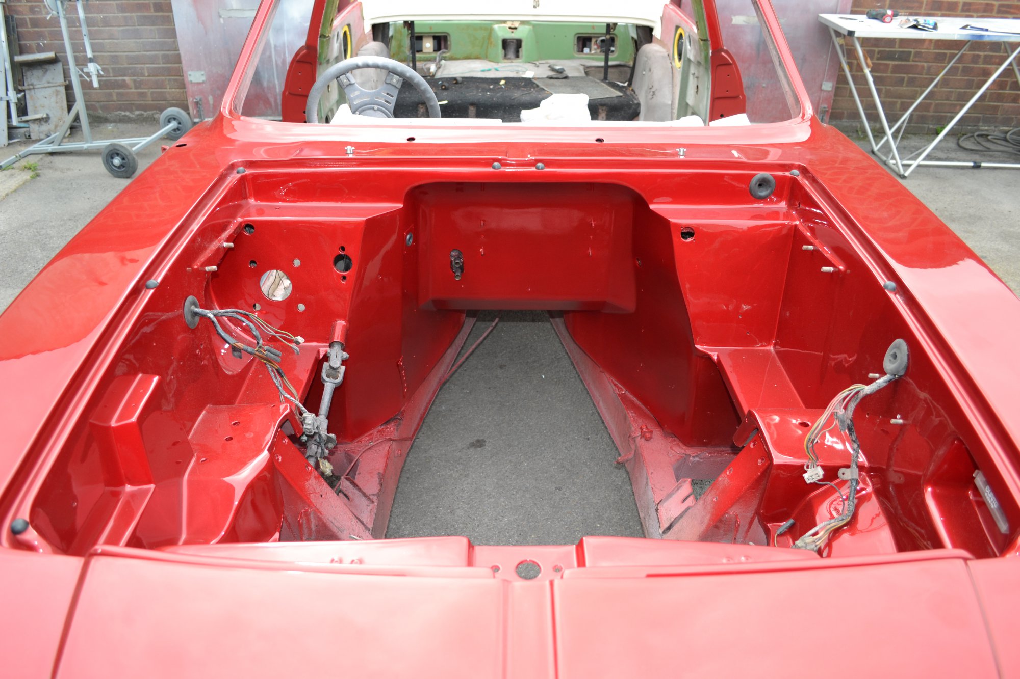

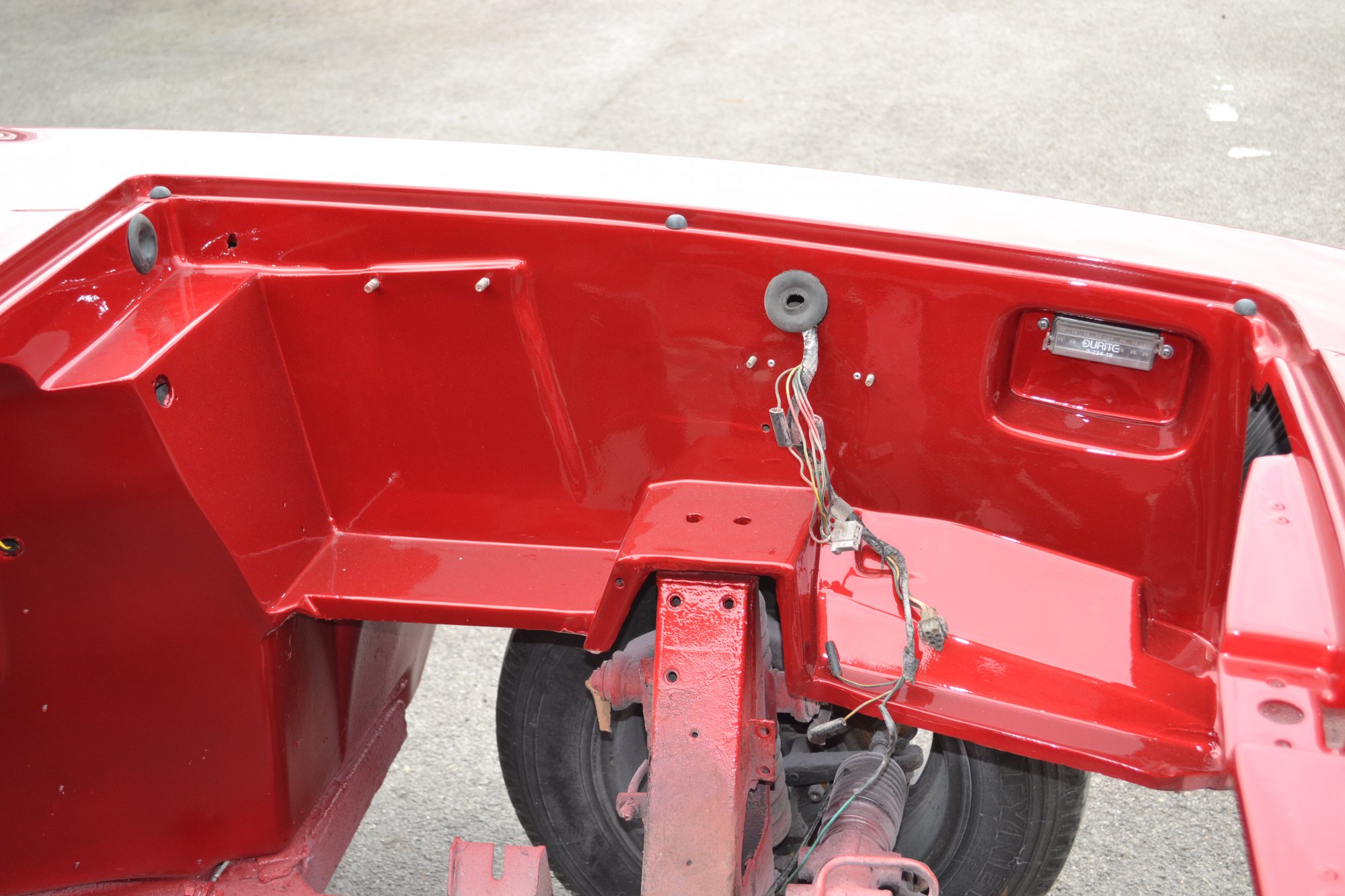

Weld a collar on the bulkhead and use a nice soft stretchy CV gaiter.
I don't know if it's rubber or 'rubber'...
It was a serious suggestion though, with some lube it's surprising what size objects will pass through a tight hole.
Do you know any farmers? Google Lamb ring pliers, they expand a small ring big enough to go over a lambs nuts in 4 directions.
Had a look on Ebay and found some for nine quid posted! Well worth trying, so thanks for that suggestion.
If your looking at saving the money and doing it quick cant you just de-pin the plug stick it through and repin?
