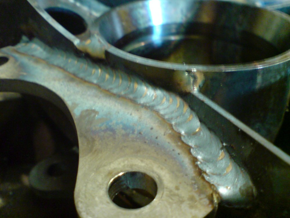

cool..i did have to alter the settings...the original settings i use for three mm box sat really cold and would not puddle properly..so i i turned the power and wire speed up until it sounded right....the puddle flows nice but yes i will cut open and see what penetration is like....i find it easier to drag than push the weld...it would be nice to perfect the technique...
