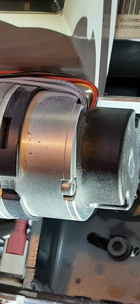

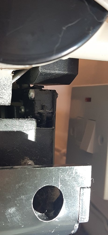

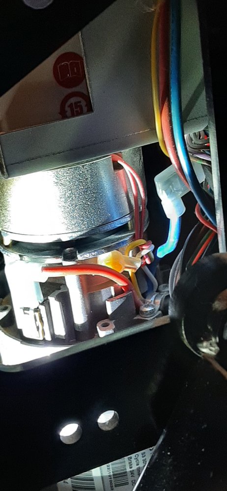

The first picture is the microswitch, there are 2 microswitches.You might well find that the motor is braked in some way to stop inadvertent chair movement when power is not applied (I.e if you stop half way down the stairs). One of those other wires possibly releases the brake mechanism?

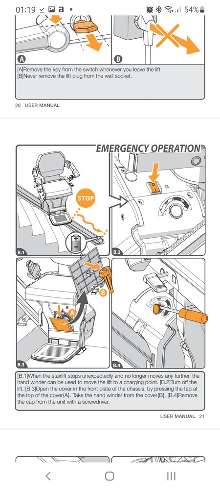

I'm still going with the fact that there will be some way to handwind the chair to allow rescue if it gets stuck, in fact I'm pretty sure it's a legal requirement.

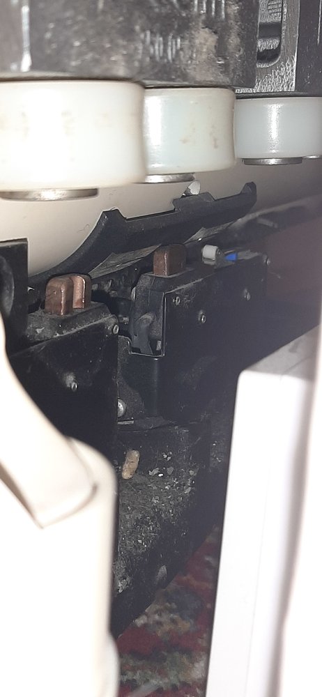

What position is the up stop microswitch in? From your picture it looks like it's jumped the striker and is now back in the position to allow movement?
Also, although it appears to have overtravelled are you sure that all the other safety switches are in the correct position, there will be loads of them including on the foot rest, chair position/alignment, anti crush all around the rail chair interface, safety gear engagement, possibly seat belt, etc, all of which will prevent movement.
Hence the requirement for handwinding.
That's why I said no to trying to direct drive the motors. To many potential safety switches.I thought my mothers had done a similar thing.
Turned out to be simple for hers and it hadn't actually over-run - the seat was rotated back in the correct position for travel, but the manual locking handle wasn't - small adjustment later, it dropped into place and all worked again.
There are safety switches all over the place and only needs one not back in place and it wont work. Even simple things like the keyswitch being off, or an E-stop pressed.

Some of them seem to only used the powered drive to "load" the drive chassis on to the rail, using temporary guides and the remote control to operator. I assume the temporary loading guides also operate the relevant safety switches to allow movement.There has to be a manual way to move the stairlift. How do you think the installers get the things on the track?. Give Midland Stairlifts a call. They have refurbs in as well.
The guy that services our stairlift told me you do have to 'grow' another pair of arms to put the chair back on it's trackSome of them seem to only used the powered drive to "load" the drive chassis on to the rail, using temporary guides and the remote control to operator. I assume the temporary loading guides also operate the relevant safety switches to allow movement.
