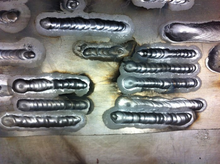

Right can now weld lovely beads on aluminium using both just the foot pedal and pulse, was using thoriated 1.6mm electrodes.

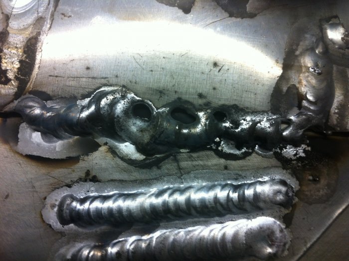

Tried lap joints again but wasn't having much luck again. Was either burning back the top piece too much and not getting heat into the bottom piece or the aluminium rod was balling up in front of the puddle and contaminating the weld usually ending up with me dipping the tungsten in the great bloody ball of aluminium in front of the puddle.
You can see on this fillet joint there is hardly any penetration into the bottom piece of Ali.
I'll 2nd what I said earlier, 1.6's are only for <40 ish amps in my book. I rarely use them for anything these days. 2.4mm zirc. ground to a small land, then ball it up.

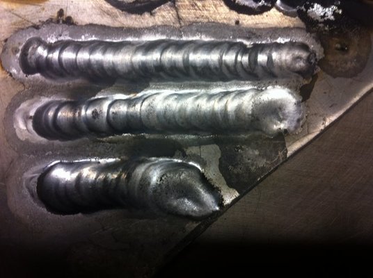

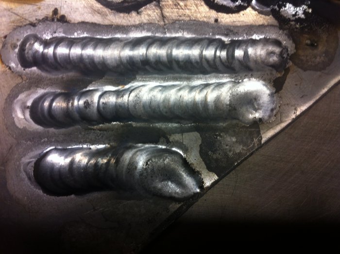

Heres my welds not qiute as good as yours but im getting there.
I also tried a lap joint and got exactly the same as you
(bottom pic)

a common cause of poor fillet/lap welds with ally is too long an arc length.
if the arc is favouring one edge direct it towards the other
dont move forward till the pool penetrates the very corner of fillet/lap
Finally nailed a couple of fillet welds on aluminium yesterday. Changed to the 2.4mm rods as said.
Not the prettiest in the world, but were relatively shiny, some contaminiation (black specks in the weld) but very nice fish scales look. Looking forward to perfecting it now. Once im happy with the fillet welds i will probably move onto the outside corner and then the lap joint.
