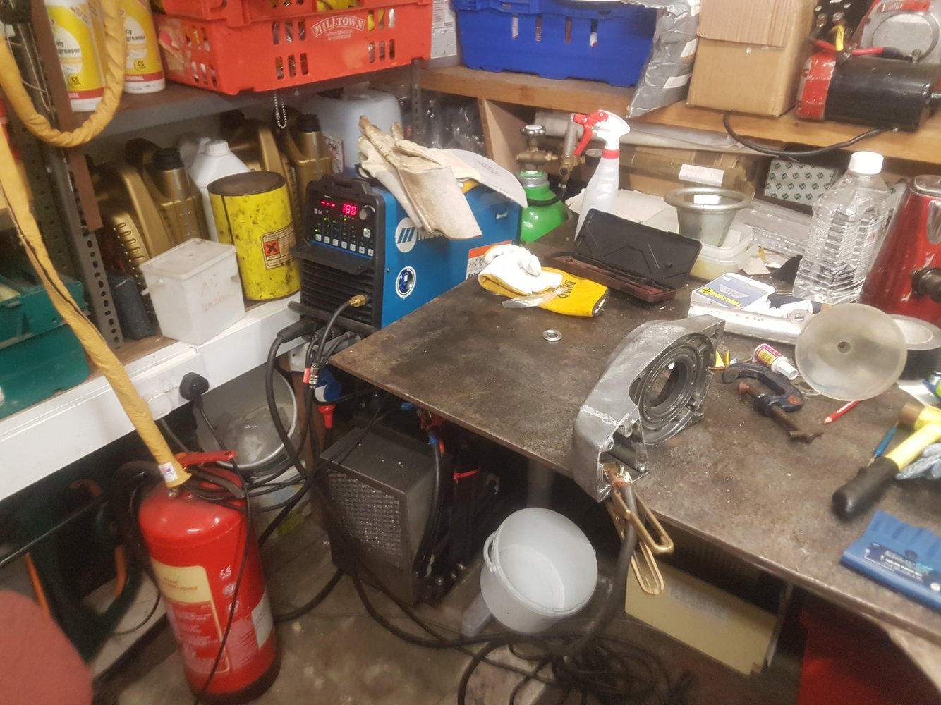

WTF, I said, as I believe is the current fashion, and reached for the multimeter. Bloody field windings were open-circuit. Then I remembered that the last time I used that Vax, it stopped for no apparent reason. Thinking it had just blown a fuse or had a cable break, I switched to the other one and had been using it ever since. Peering at the windings I could see the break, near the attachment point. Right then. Some precision fiddling with a small tubular crimp restored continuity and I threw the switch aaaaaand... away it went, a little quieter than before perhaps, so I left it running on 'soak test', propped against the wall while I tidied up. After a couple of minutes, for no apparent reason, it stopped. Lawks a mussy me, I ejaculated, as I went to the bathroom to wash my hands.
