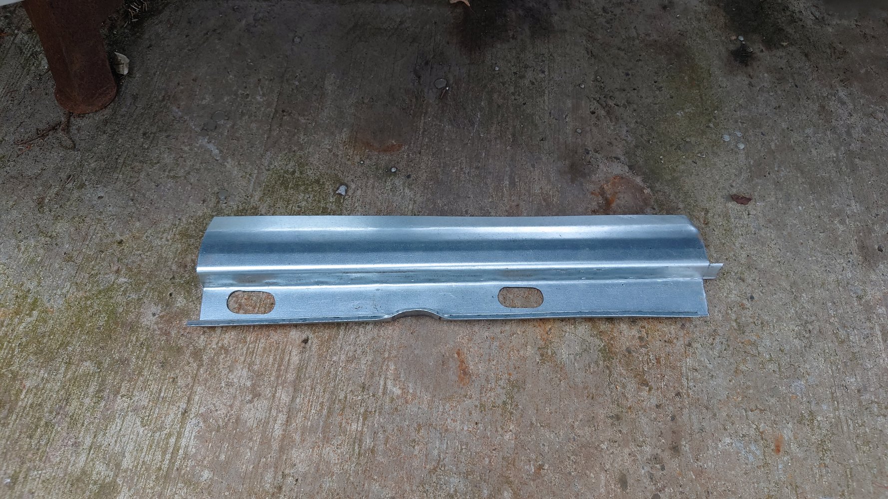

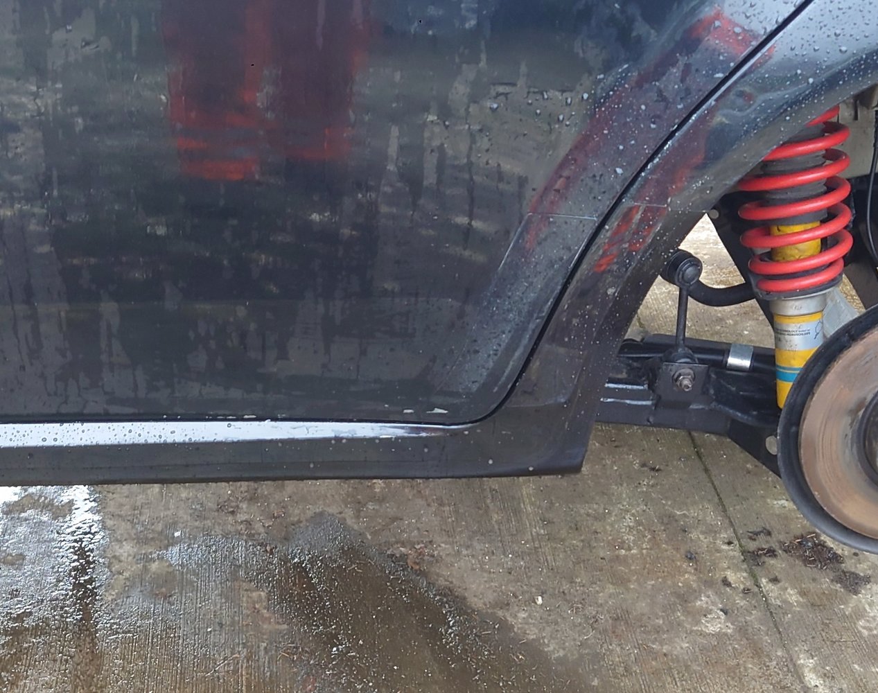

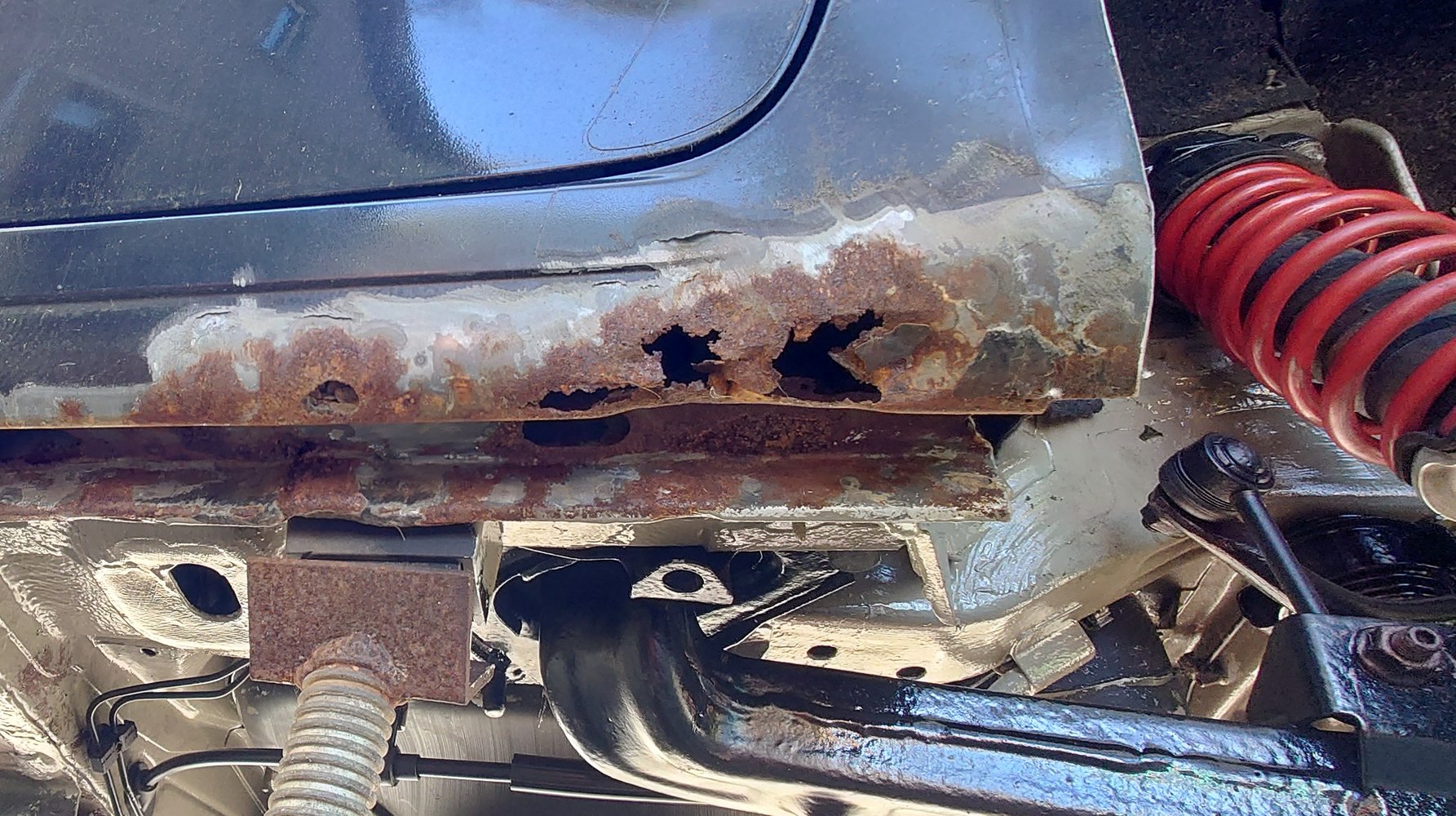

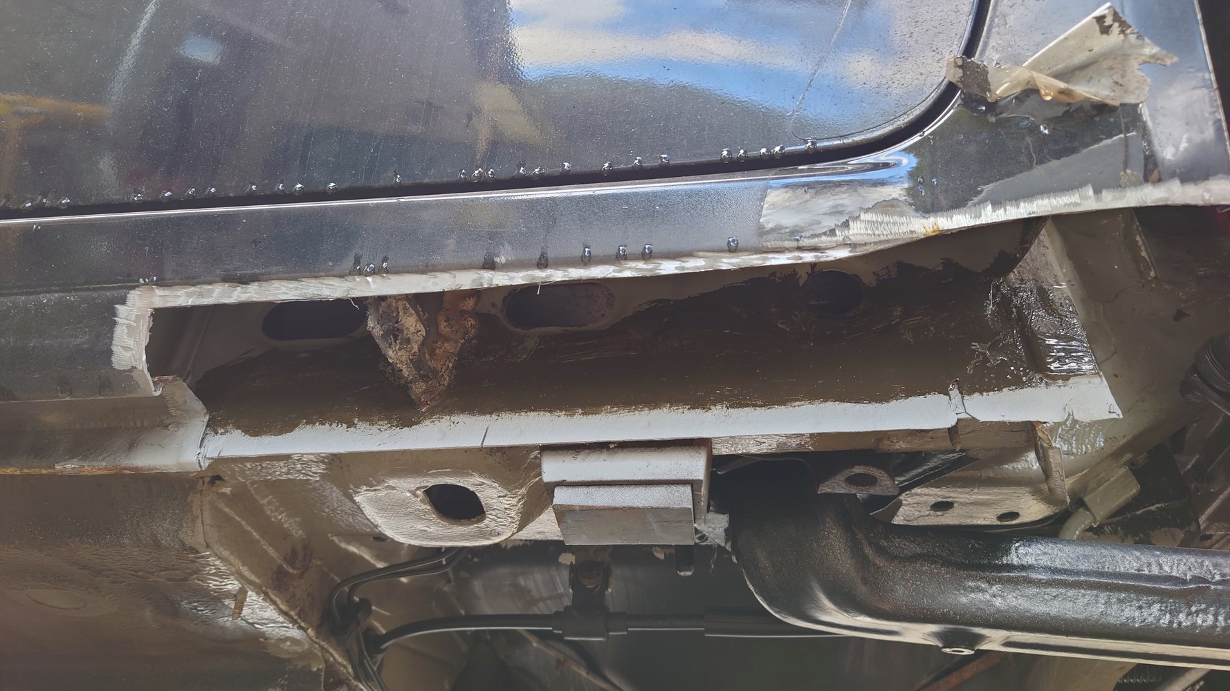

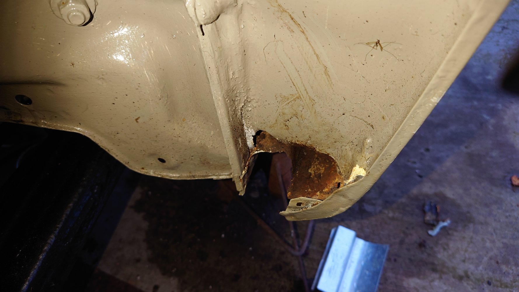

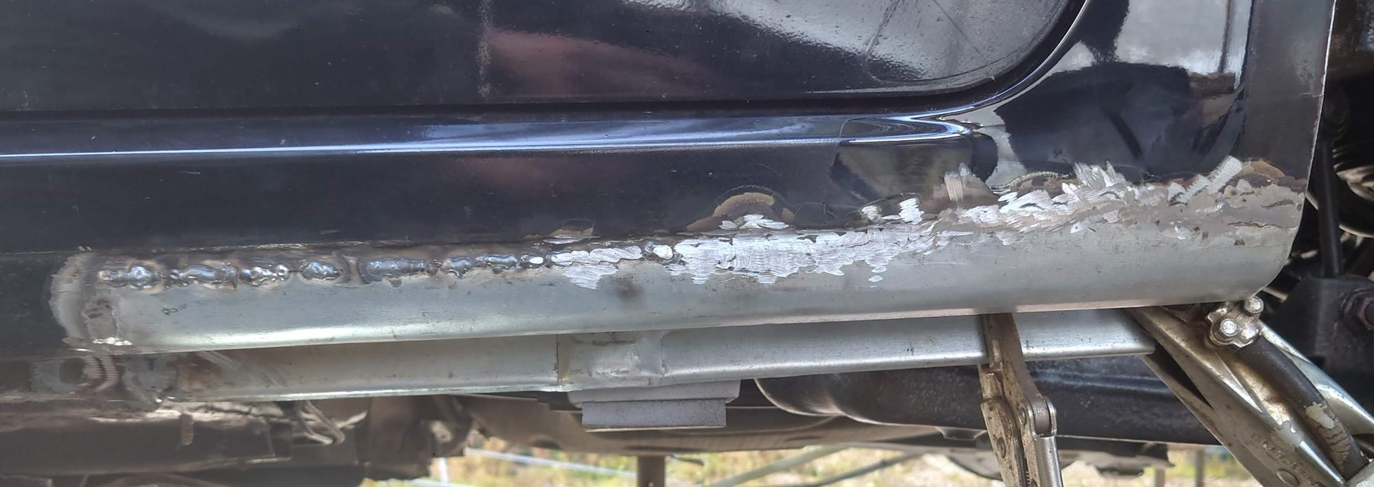

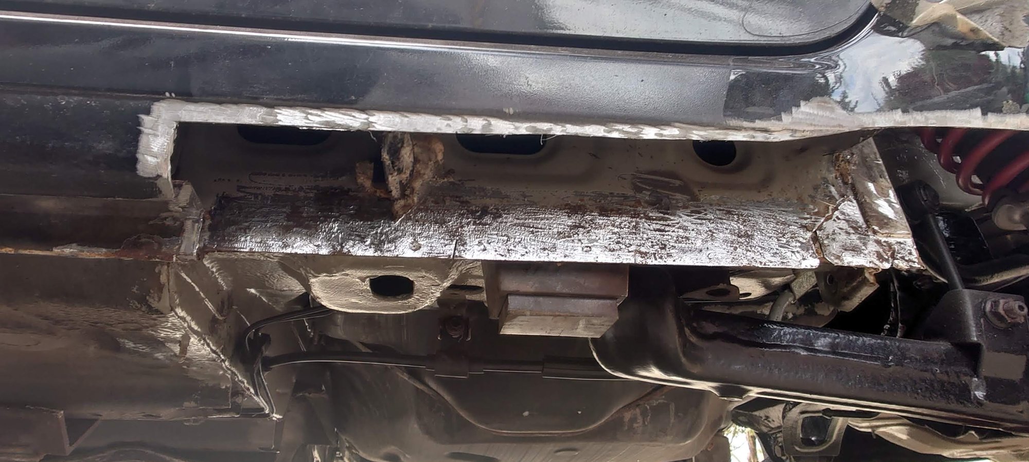

Today I finished fixing some more rust on my Alfa 159.
This is a bit of a saga, I started in September but I wasn't in a rush, which was just as well.
The rear of the sills are a bit crusty.
This is the worst side, the other side was the same but less so.

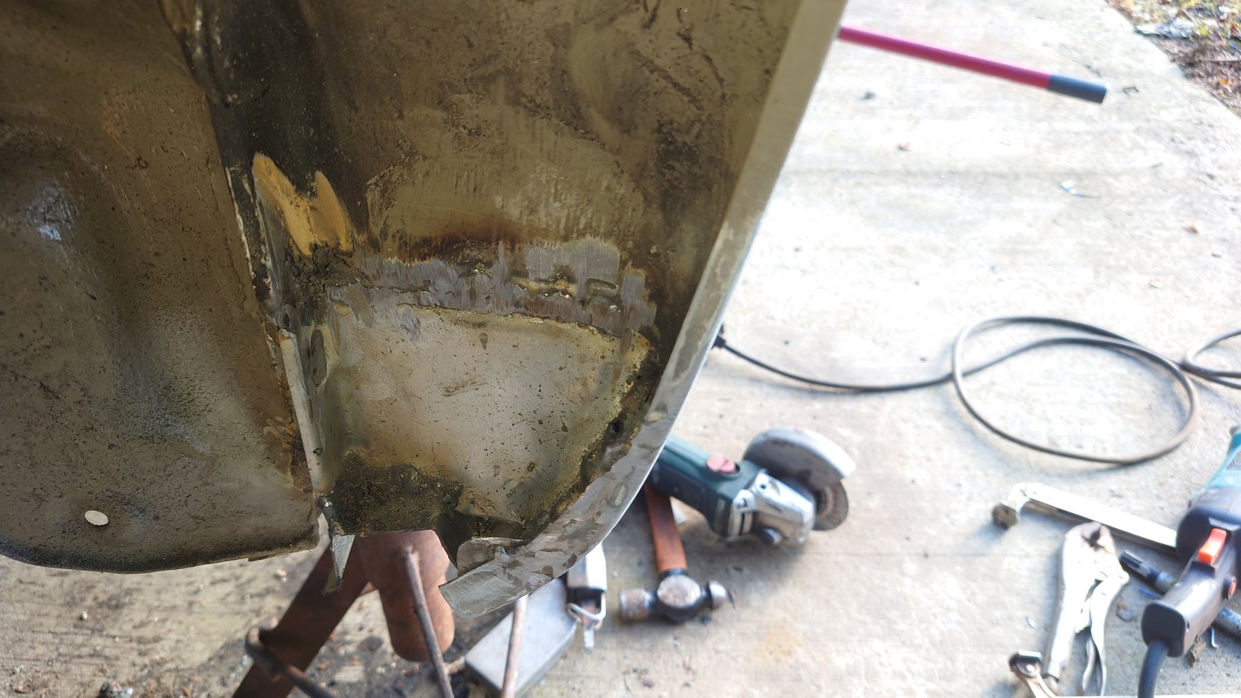

Cut out the rust and cleaned it up.
I gave most of the inside two coats of epoxy but I used galv paint on the bits that were to be welded.
Then made a patch.
And welded it in
Cleaned it up and applied two coats of epoxy to the outside with a brush.
That's as far as I got before the test, so I took it for the test.
The test centre with the earliest test available was over 35 miles away and the car hadn't been driven for 6 months but off I headed.
Uneventful trip and the test was started as planned, but they then reversed the car back out of the test centre.
They said there was a fuel leak and they wouldn't carry out the test.
There was no talking to them and I lost the date (and the test fee) so I had to apply for a full new test.
I applied straight away and got a date of February 3rd!
No matter, I don't need the car so I didn't bother looking for a cancellation.
Back home, I checked everything and couldn't find a diesel leak or a leak of anything else.
On further investigation I found it had preformed a DPF regeneration 45 miles ago, so it looks like the smell of diesel was just a hot exhaust.
I was a bit peeved so just let the car sit.

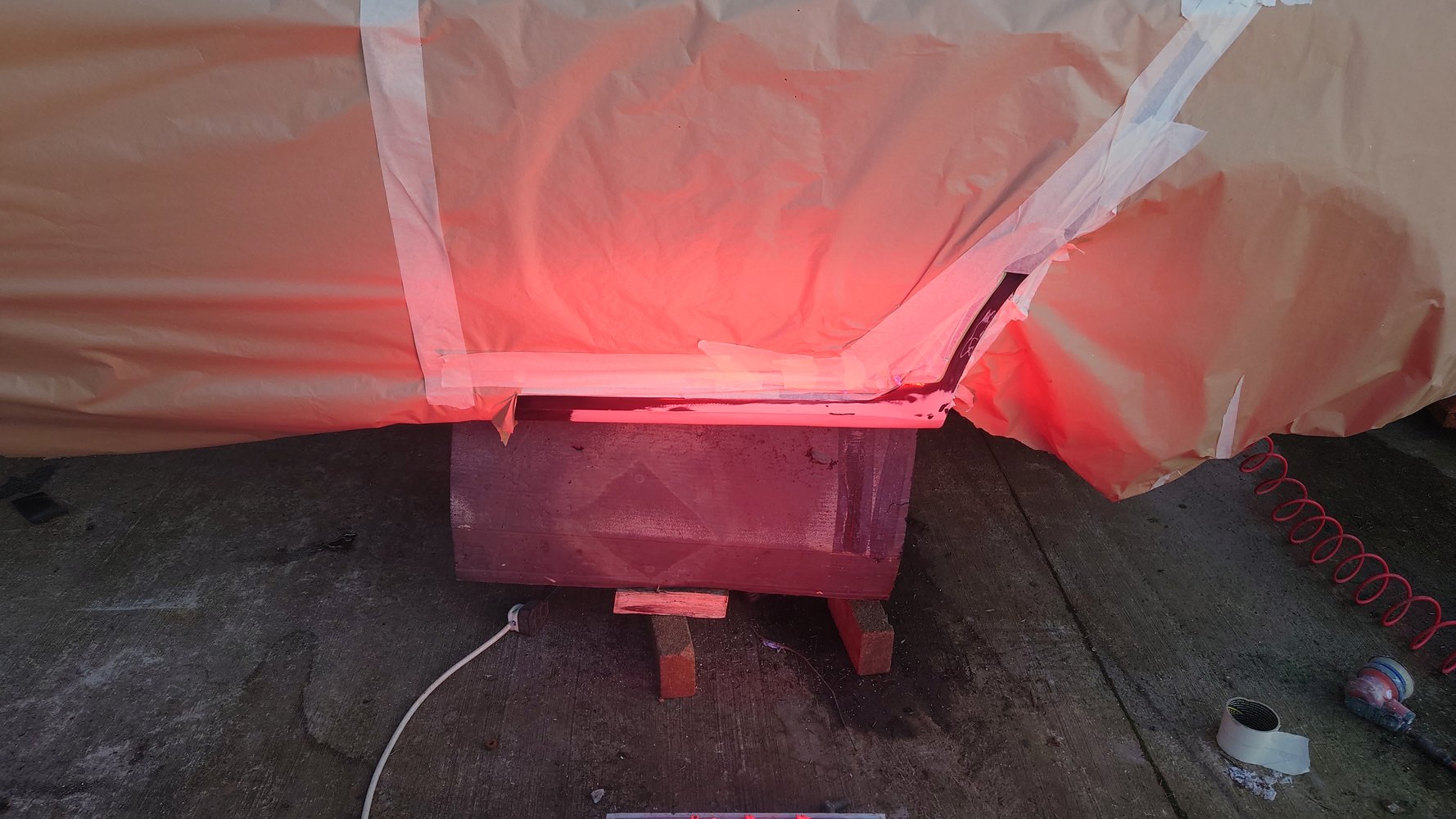

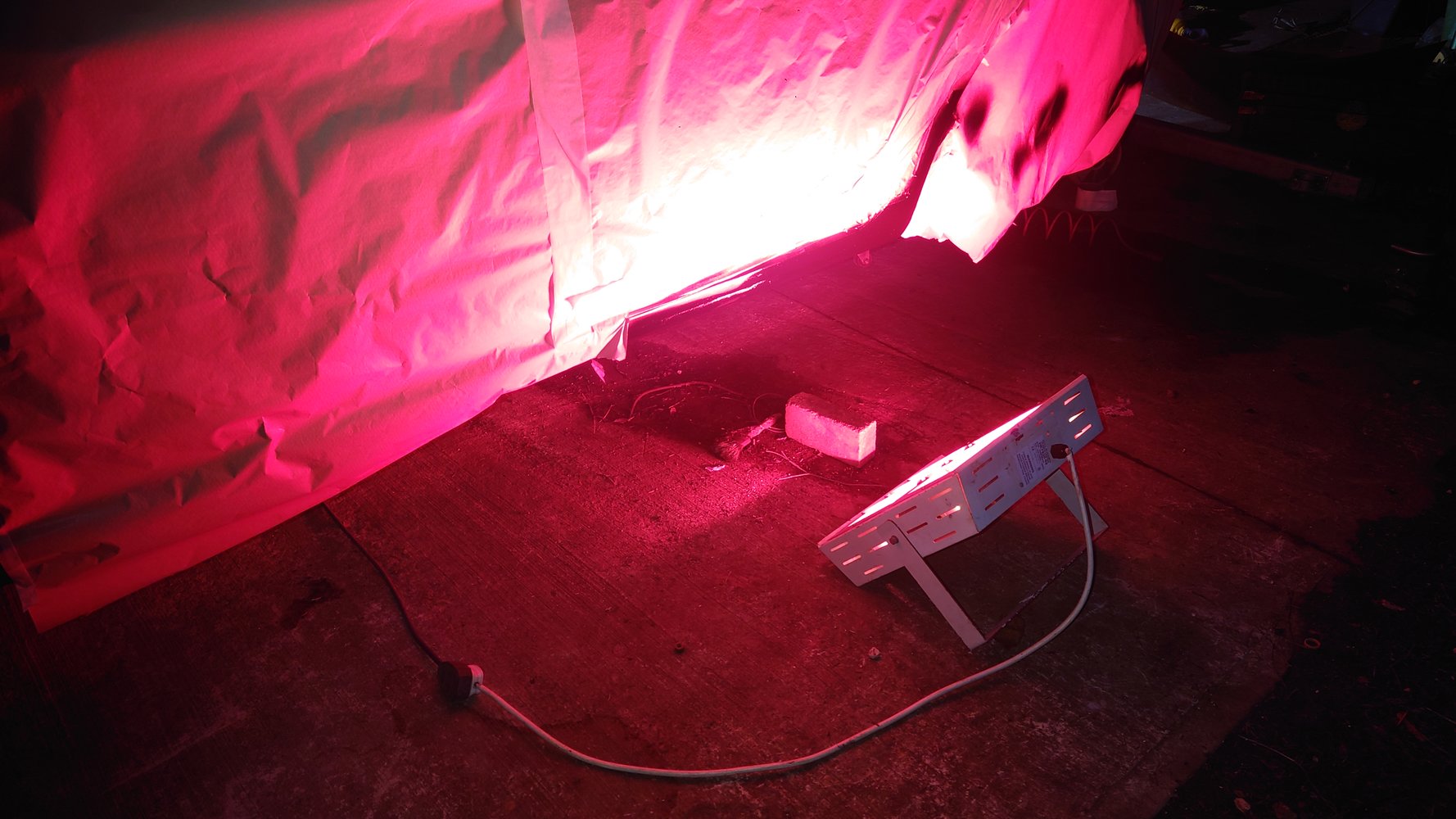

Fast forward to yesterday and I decided to try to try and make the repairs a bit more presentable and closer in colour to the rest of the car.
It's base coat and clear, but now is not the time of year for painting outside so I just gave it a quick lick of 2 pack black.
It was a nice day, very cold and it was almost dark before I started painting.

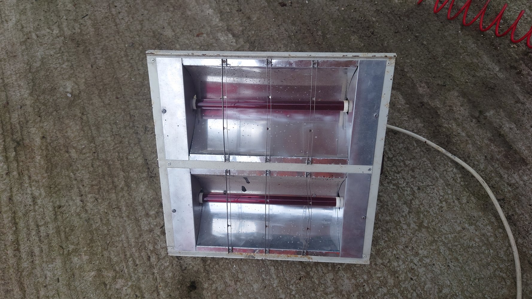

However, I do have a very powerful infrared heater that warmed the panels nicely and cured the paint in a few minutes (thanks @Pete. )
I'm fairness it turned out ok, and it looks far less obvious than white primer.
I will paint it properly when the weather gets warmer or I get some room cleared to get back inside the garage.
View attachment 436146 View attachment 436143
Yeah it was a fiver in the boot fairNice work!
Do you have a spec or link on the IR heater please?
The bulbs and holders are reasonably cheap on ebay, couplle quid each. If your making car patches I think the frame would be quite easy to fabricate from polished sheet.Nice work!

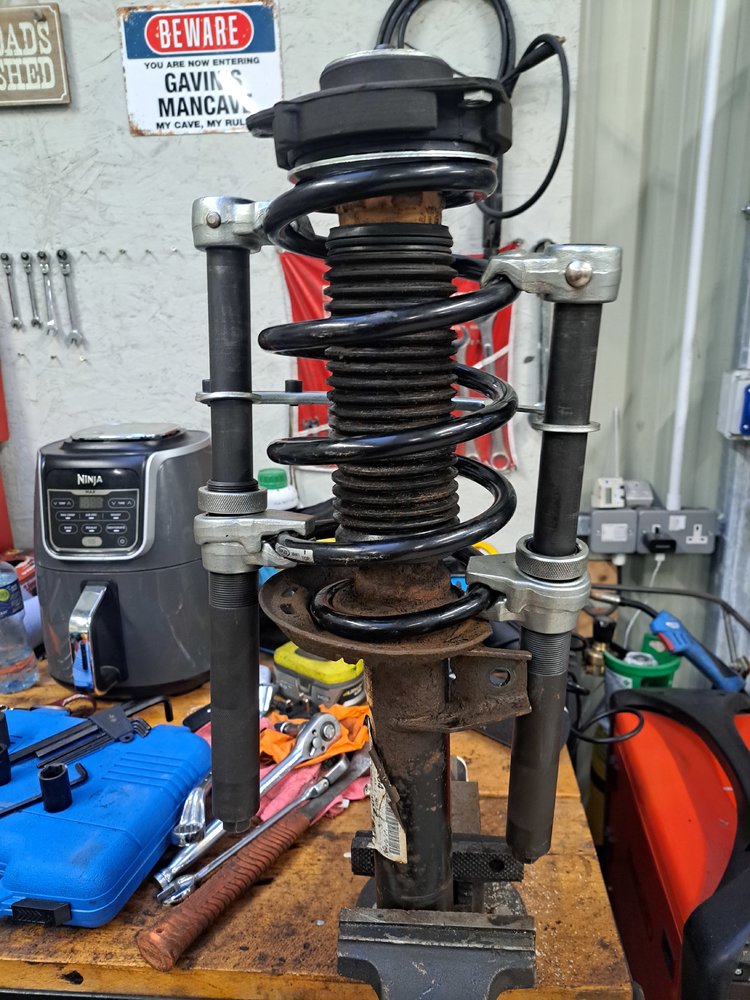

Replaced front coil spring on my wife's VW Tiguan.
