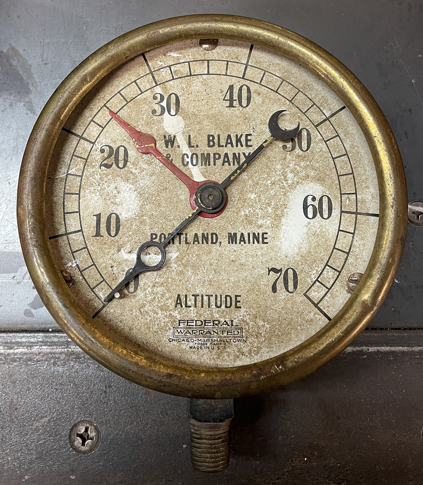

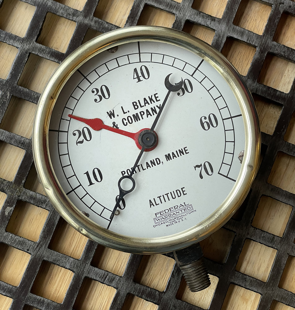

Great job. Any idea what it came out of?Spouse found a nice old gauge for me for a few bucks whilst browsing in an antique shop. She knows I like vintage/antique industrial items, and this also bore the name of a local company. The glass was missing, and it looked pretty rough, but I was optimistic that it would clean up...and I have a hard time turning down any new additions to my growing pile of old metal stuff.
It turned out to be an easy fix. Cleaning the face, touching up the hands, polishing the brass, and cutting a new 'glass' from some polycarbonate sheet took a total of an hour and 15 minutes.

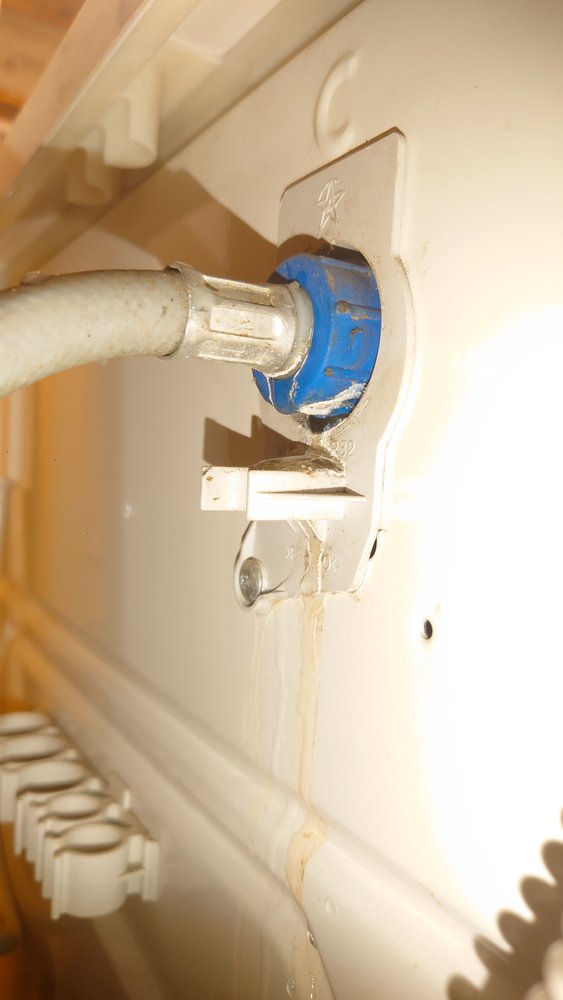

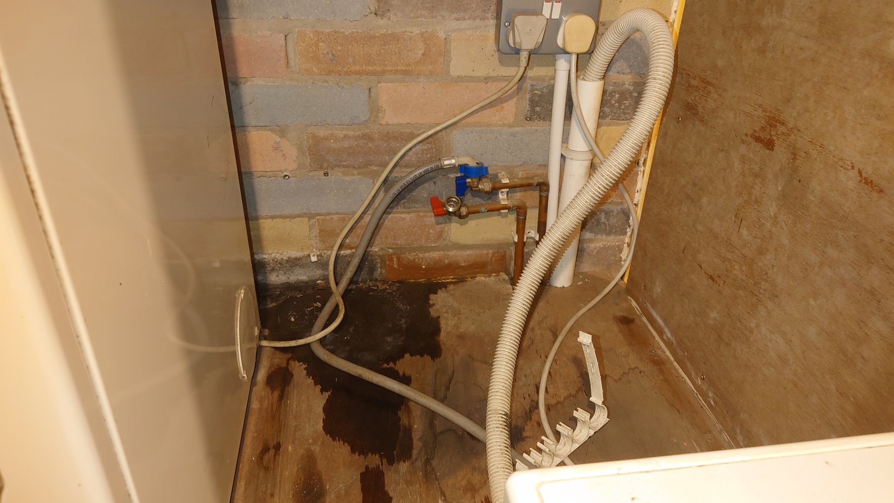

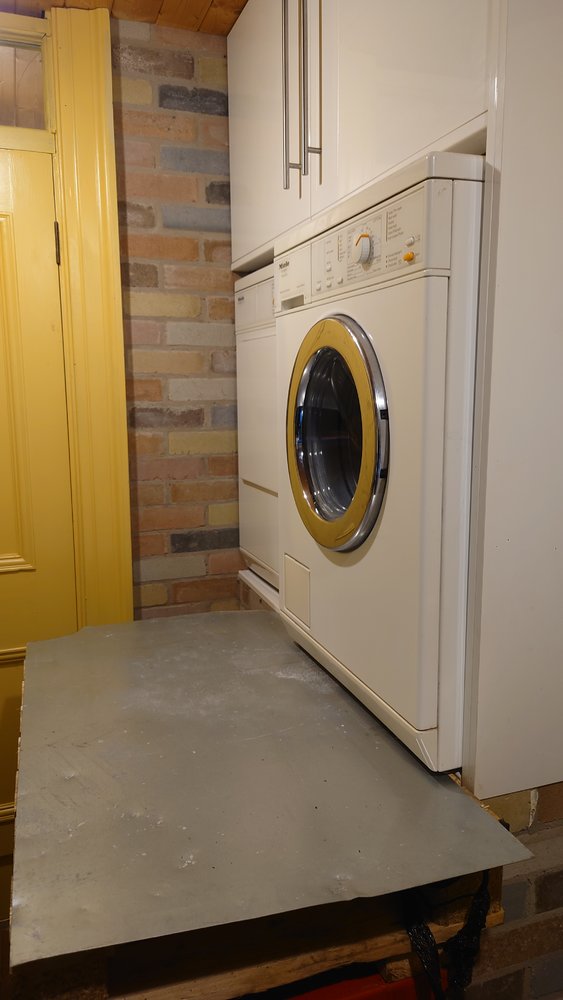

Washing up liquid - applied liberally under the feet and where they will be sliding.Today I fixed a small leak on the washing machine.
Simple repair, just needed to tighten the inlet pipe.

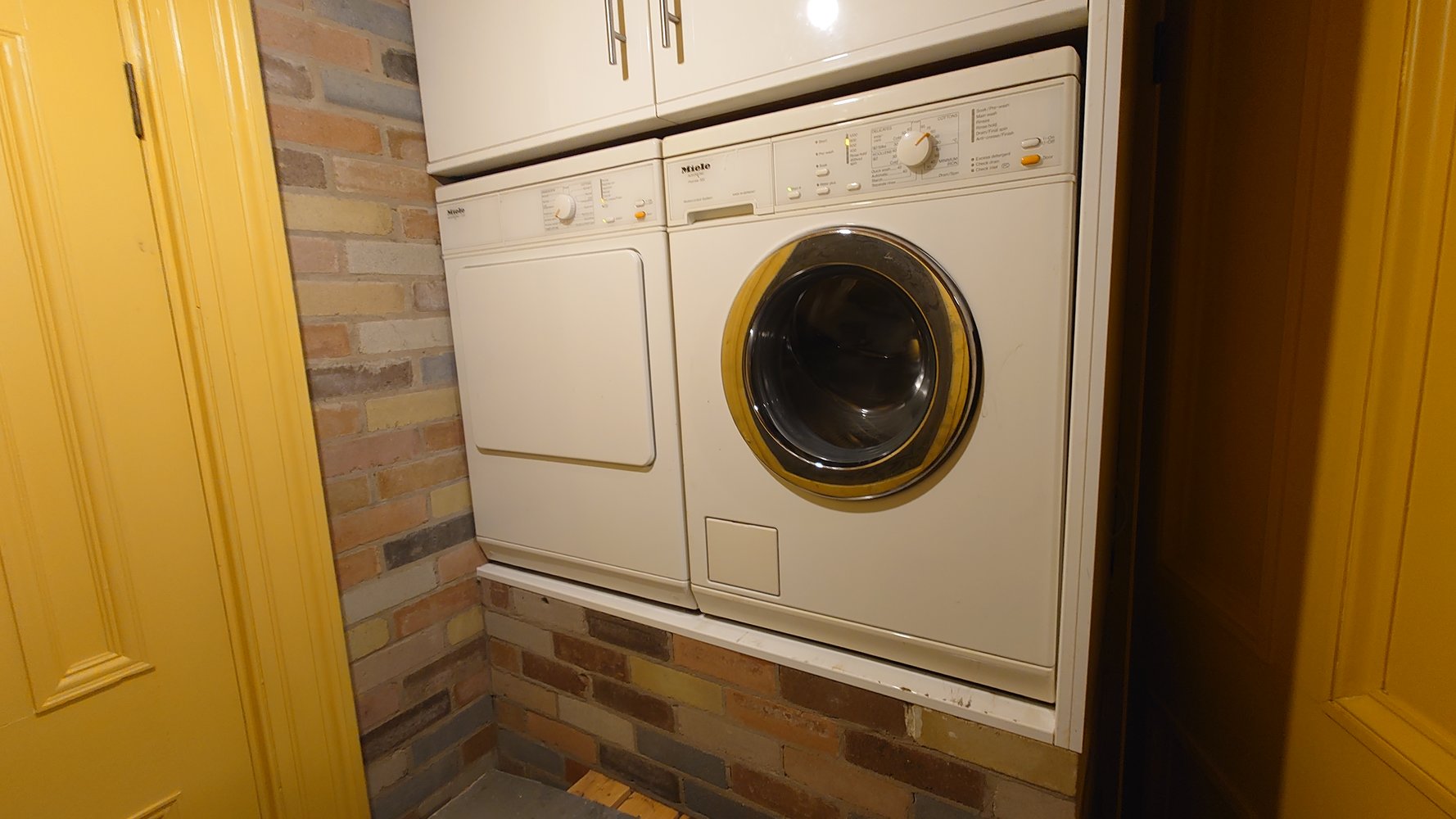

How and ever, the machine is 900mm above the floor and there isn't much room.
It seemed a good idea at the time (30 years ago) but now I'm older and weaker, it's getting more difficult to drag it out to get access to the back.
However there are some advantages to being a hoarder and I bought a lifting table on here from @Dozzer (many thanks) and I did think at the time it would be useful for this very purpose. (Amongst many other)

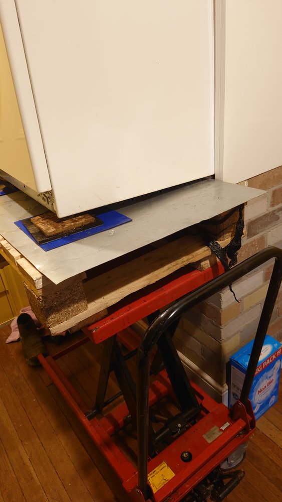

Not easy to get a proper photo but you should get the idea. The table didn't extend to the height I needed, so a pallet and some 4 x 2 was pressed into service to increase the working height.

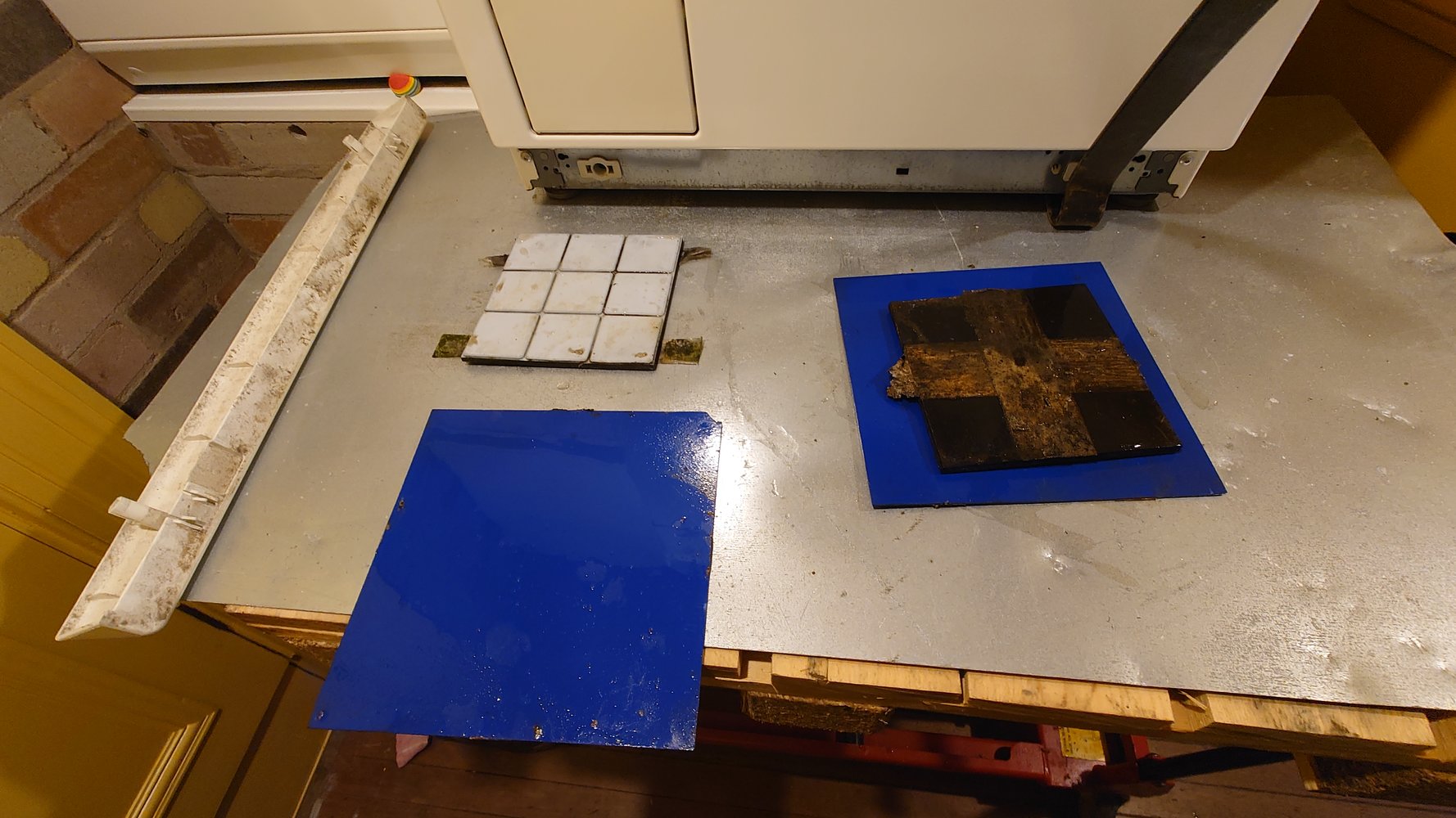

To make it easier to slide the machine out, I added some galv sheet.
It still didn't want to slide so the real hoarding came into play and I remember I had some small bridge bearings that I saved from the skip with no real thought as to why.
With a couple of small square plates, to spread the loads from the feet, they worked a treat and the machine slide out easily. I had to reposition the bearings a couple of times but it was all very straightforward to move.
I was then able to lower and move the machine to get full access.
Then, just reverse the procedure to get it back in and job jobbed.
I don't know what it was used for. I was trying to find a catalog that I could browse through. I found a couple of their older catalogs for sale on eBay, but I don't want to buy them just to look this up. W. L. Blake & Company date back quite a ways; I don't know how far back, but I did see some office correspondence for sale on eBay dated 1891, and the letterhead said "Manufacturers Agents for Railroad, Steamship, and Mill Supplies."Great job. Any idea what it came out of?
My first thought was an aircraft, but 70,000 ft sounds like a lot for something of that vintage...

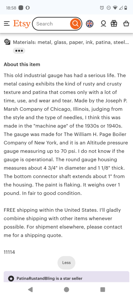

Thanks @Onoff. That looks like a virtually identical gauge, other than the company. Since it was manufactured or sold to a boiler company, it seems logical that it could have been used on a boiler or on some kind of steam equipment.@Blue Chips , does this help?
That's exactly how I set in and also replaced both 12 kg washer & later on our 7 kg condensing dryer out in the mancupboard .. giving a light smear of washing up liquid on the top side of the plastic sheet make it slide in & out of the platform a lot easier as well as allowing the machines to be slide backwards off the sheet.Today I fixed a small leak on the washing machine.

Pressure gauge for engines & vacuum brakes so pressure can be adjusted ???I don't know what it was used for. I was trying to find a catalog that I could browse through. I found a couple of their older catalogs for sale on eBay, but I don't want to buy them just to look this up. W. L. Blake & Company date back quite a ways; I don't know how far back, but I did see some office correspondence for sale on eBay dated 1891, and the letterhead said "Manufacturers Agents for Railroad, Steamship, and Mill Supplies."
Interesting that it doesn't say what units are used for the altitude measurement. Maybe it's some kind of 'equivalent' altitude, or ???
I think it's probably feet of water, 35 PSI equates to 80 feet.Thanks @Onoff. That looks like a virtually identical gauge, other than the company. Since it was manufactured or sold to a boiler company, it seems logical that it could have been used on a boiler or on some kind of steam equipment.
I just tried applying some air pressure to the gauge. The mechanism seems to be working smoothly, but I have NO idea if it's even reasonably accurate anymore. When I applied exactly 35 PSI of air to it, the gauge read 64. The closest pressure unit equivalent to 35 PSI I've found was 71 inches of mercury, which isn't terribly far off, considering that the gauge is probably way out of calibration. Inches of mercury is/was commonly used to measure atmospheric pressure, so that would be a possible unit for an 'altitude' gauge. Maybe one of our steam afficionados would know more about it.
