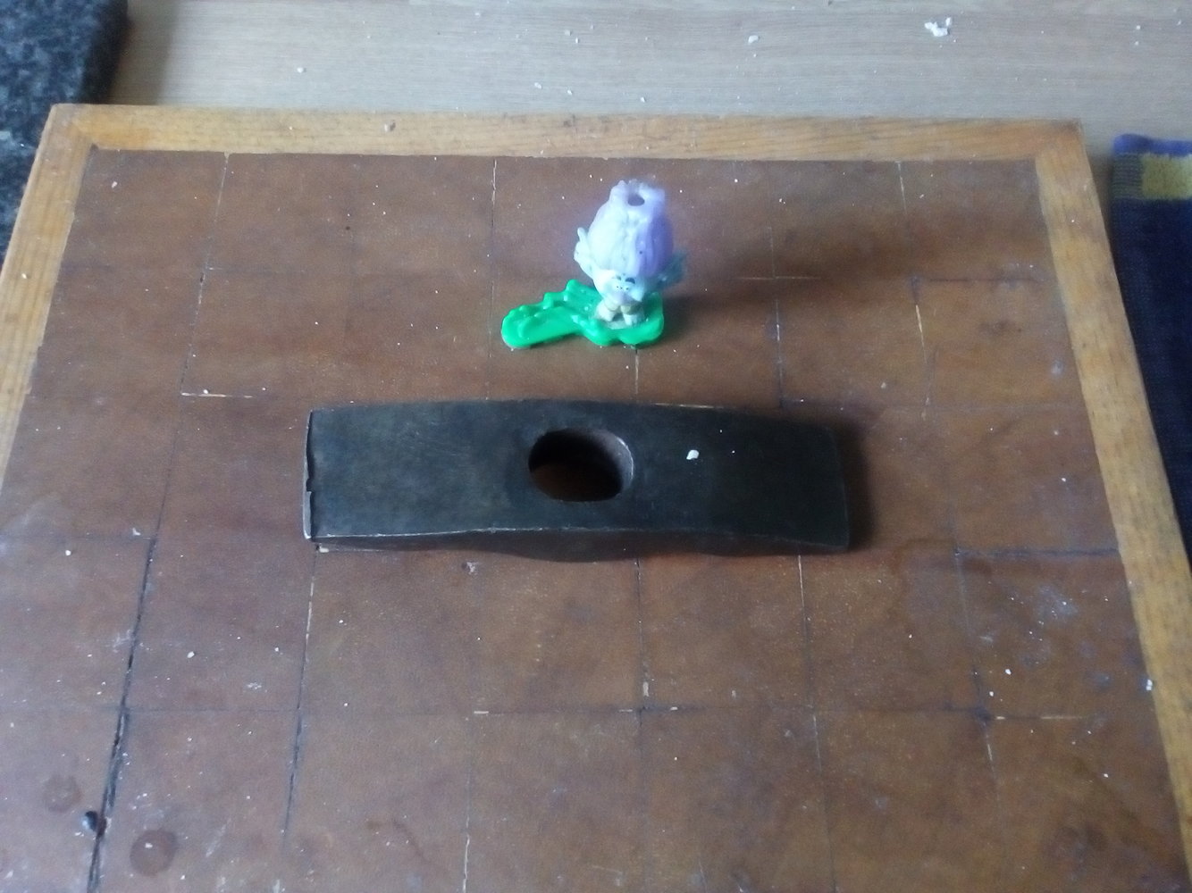

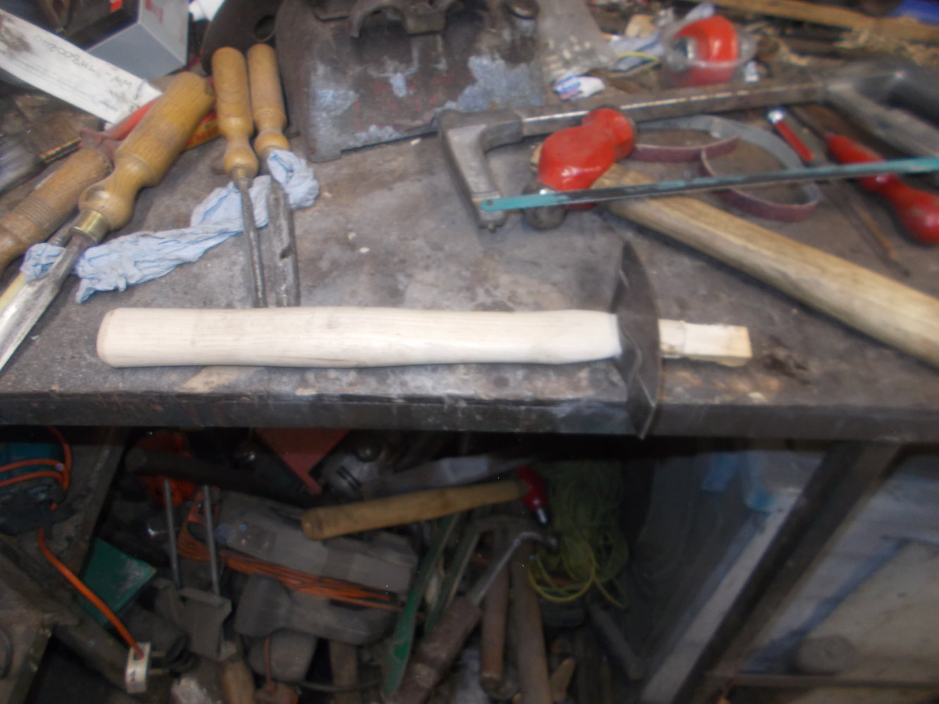

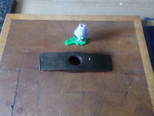

This Welsh Slate hammer was in poor condition.
The tangs hard gone work soft, or were never hardened and tempered in the first place.
Even the shaft hole is an odd size.
So a claw hammer handle was shaped to fit. The wedge is white oak. Only for the simple reason is it was the right size.
Fitted, French polish and waxed.
As we don't have much, if any slate down here. I shaped the tangs to be a useful chipping hammer.

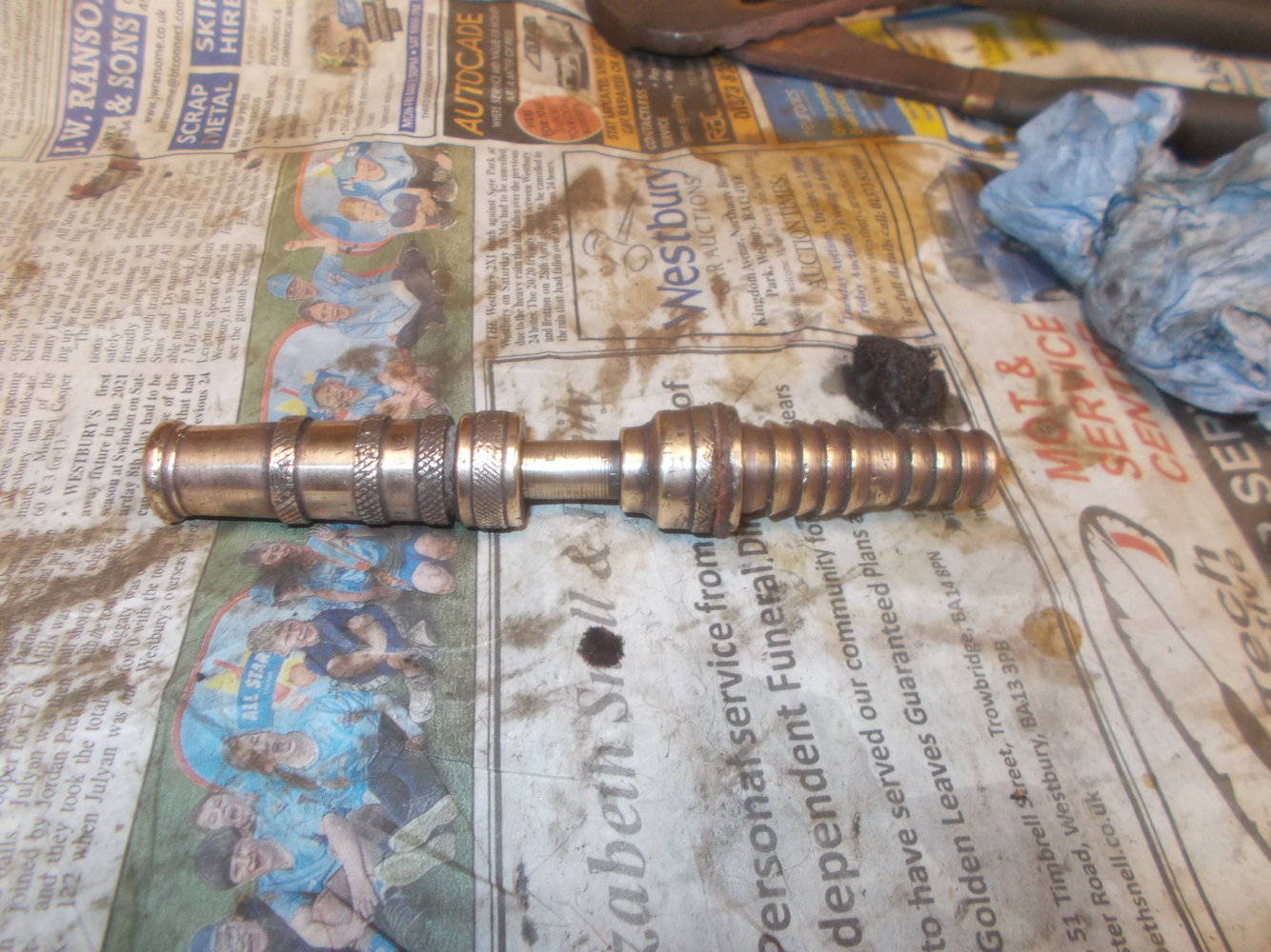

This pre WW1 hose nozzle was used as a trail fro a of the shelf brass restorer.
Not bad, but if you leave it on to long it will leech the cooper out,.
So you have to work harder to polish it out.
