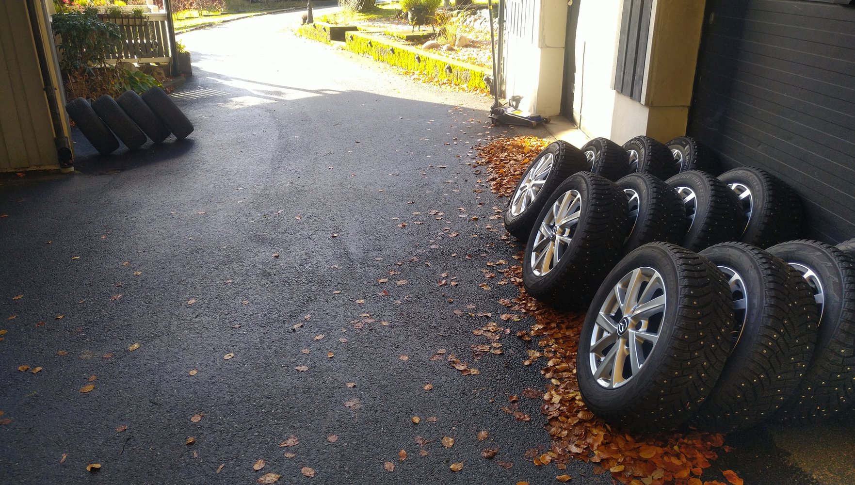

Is it a set date every year or when a certain temperature is reached ?This time of year again...

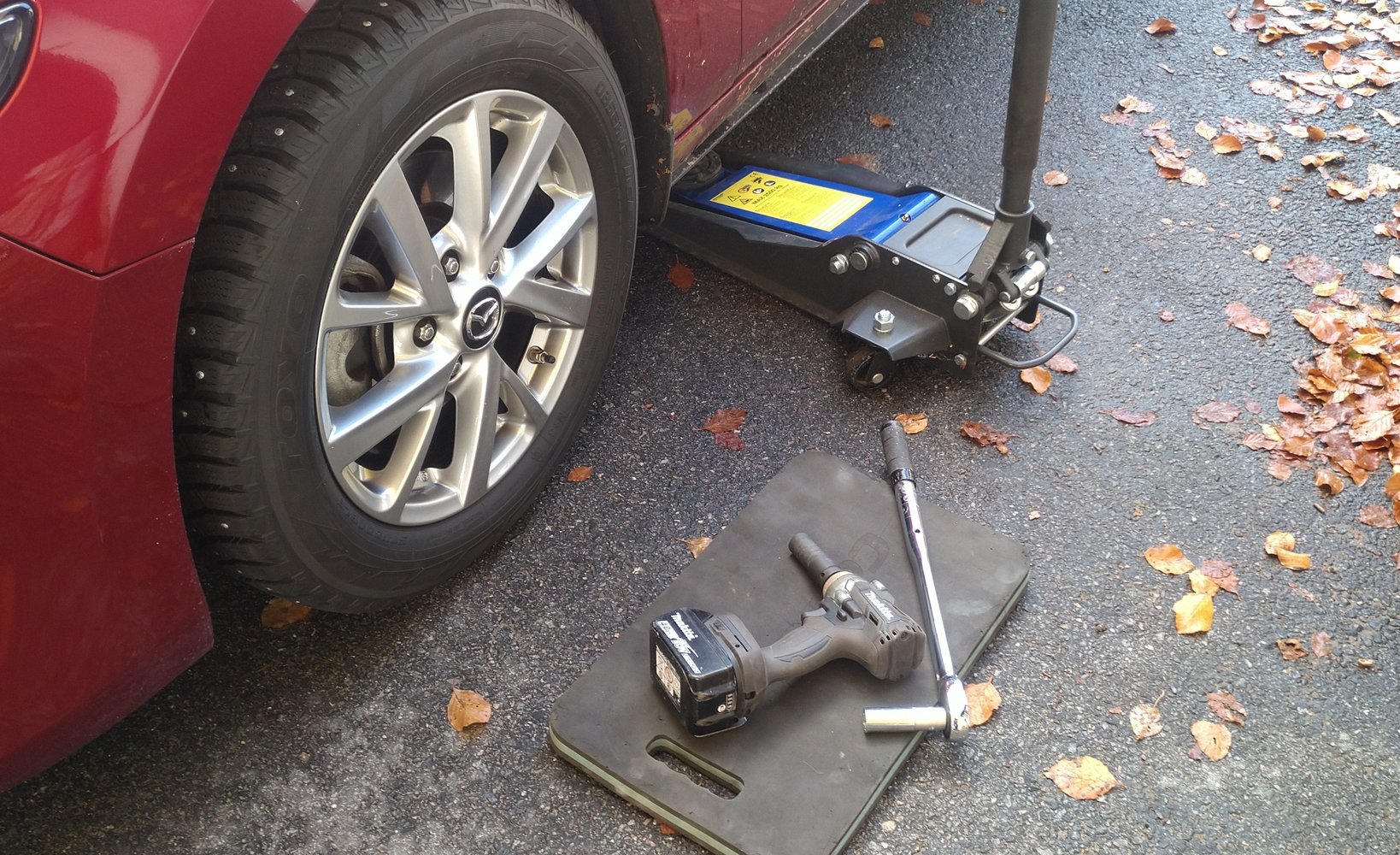

3 cars done, two to go but they need new tyres
View attachment 314768View attachment 314769
Brother is doing his today also! He’s further south than you I think.

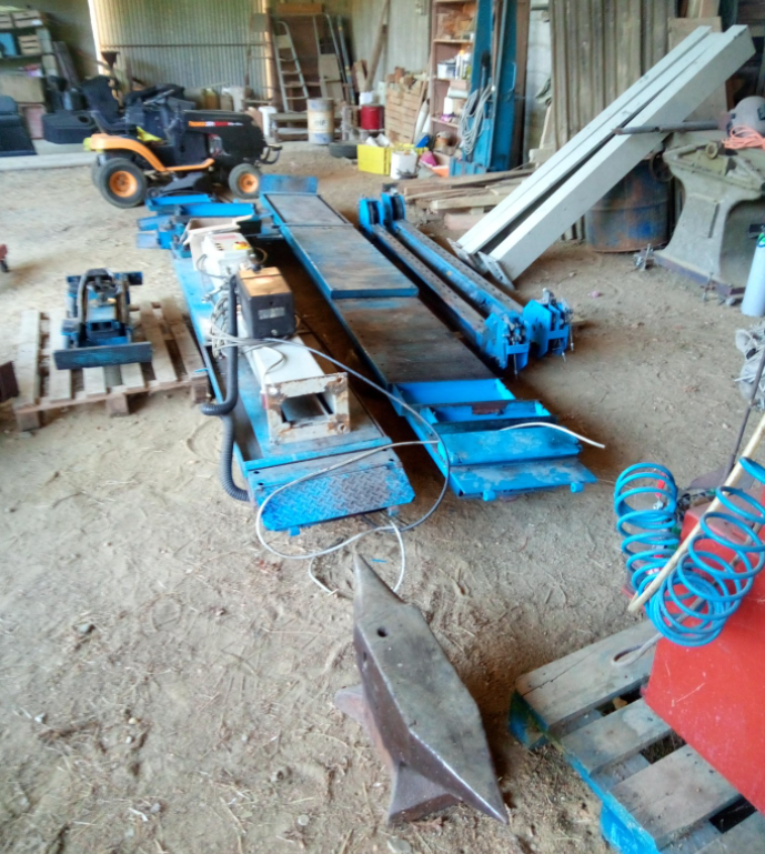

not technically fixed but tested, dismantled, loaded, drove 100 miles, then unloaded a 4 post lift, 3.5T capacity with centre cross lift. Have a lot of expensive car / van bills coming up, and I've been humming and haaaaaing for a good while now whether I could justify one or not, but when I was getting quotes just for the van repairs at 1200 euros for work I can do myself with a lift... sod it, decided the time was right to go for one. Found this one for 750 euros, not too far away. Had a decent day out with a mate, my van and flatbed trailer...
now just got to pour a new foundation, 4.5m3 of concrete, and rebuild it in place, pull in a new cable / air line to it and recommission it.... will be far easier building it here than taking it apart, at least I can get in with the front loader forks on the tractor, so will be able to lift the ramps directly into place, the rest are manhandlable so not too difficult.....
Reckon it should pay for itself pretty quickly, as a fair bit of work coming up, this will be so much easier on the knees and back... already had the mates asking when will it be finished so they can borrow it.......... as soon as you come round and give me a hand with the concrete... hahah..
Hopefully next weekend will be able to dig the foundations out, and shutter it, then the following weekend be able to pour.. then wait til it hardens fully (28 days they recommend?).. hopefully, end of Nov should be operational... maybe, hopefully etc...
I'm sure my knees and back will thank me....
When my work had groundwork done for ramps, everybody involved was happy for ramps to be fully loaded after 7 days.that's what I thought too, but the manufacturer recommends a minimum of 3000psi rated concrete, and 28 days. Asked a mate who's a builder, he reckoned a month would be fine as well? not my speciality, any experts on concrete on here ?
4 posters are pretty much self supporting so anchoring the feet isnt as critical as a 2 post lift so a couple of weeks would be fine for drying time, if your putting rebar in remember your going to want to drill the pad for fixingsThe lift is roughly 5m x 3m so we're allowing about 1 metre each side, 1 metre in front, and then 2.5 / 3m behind for the ramps depending on final placement (might be able to share some with an existing slab). For the footings of the 4 columns we're planning doing 500 by 500 x 300mm deep. All reinforced with rebar, and that will be tying into the roughly 100mm thick slab, an all in one pour...Obviously we'll order the truck based on the final dimensions, but fag packet calcs come out somewhere between 4.5 and 5m3. The majority will be around 100mm thick, so a week per inch would be about the 4 weeks, albeit the footings for the columns would be thicker... think it should be right?
2 weeks is standard around here for anything critical. Yes - critical - because the sheer overspec of anything critical makes sure it's absolutely finethat's what I thought too, but the manufacturer recommends a minimum of 3000psi rated concrete, and 28 days. Asked a mate who's a builder, he reckoned a month would be fine as well? not my speciality, any experts on concrete on here ?
