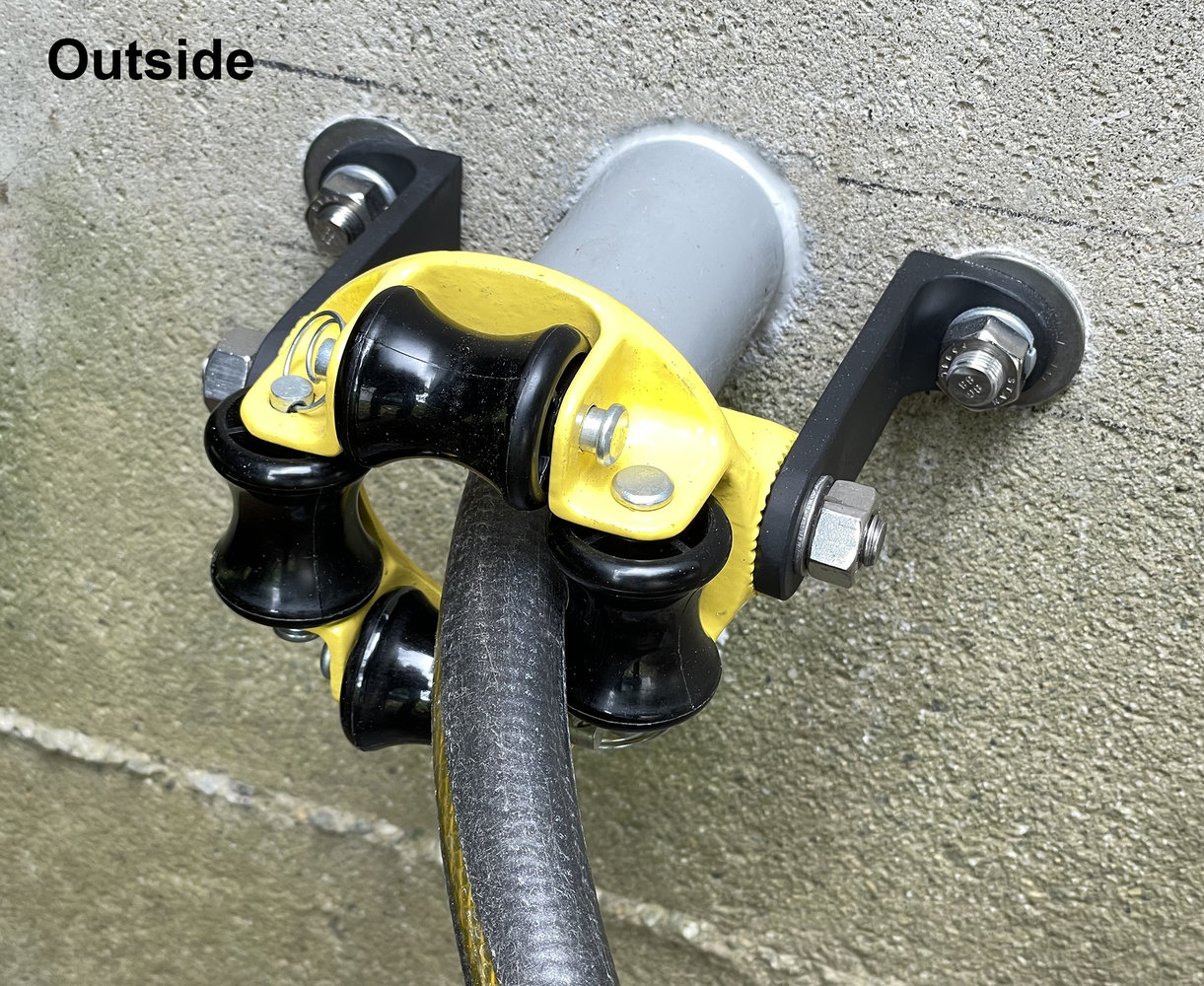

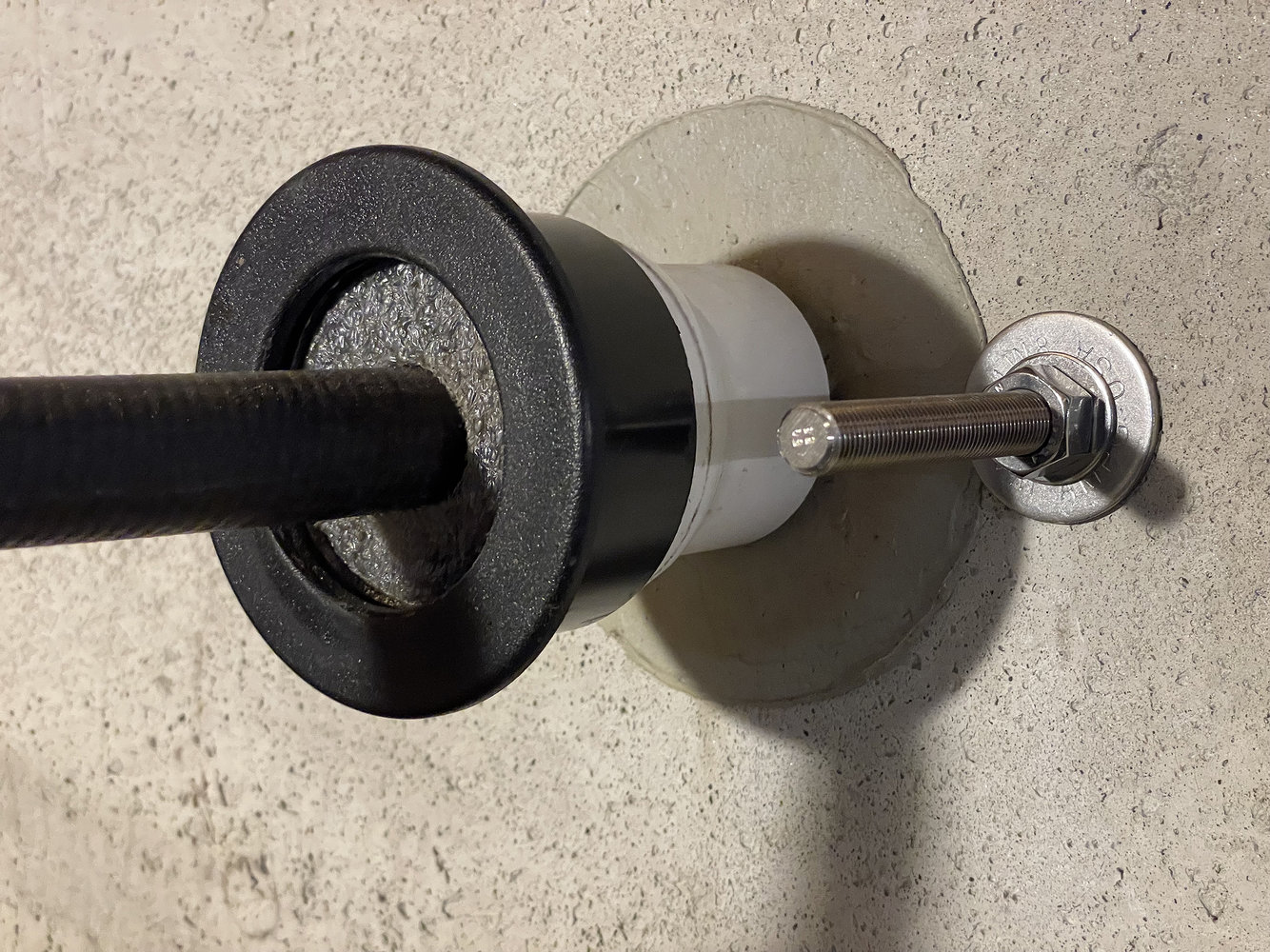

I knew there would be a fair bit of tension & weight on the wires .. So I set them in the wall blocks a foot or so from the wall ends on 16 mm expanding passivated anchor eyes .
Seeing how good the local Welsh ( all recent ex coal miner friends out the local open cast mine ) builders were when they built this their second bungalow in 1987 . There is no way I was or am going to risk drilling &/or hammer vine eyes in the mortar joints , for I discovered that in several cases it was only the pointing holding the blockwork in place as no one seemed to have buttered the full block ends
