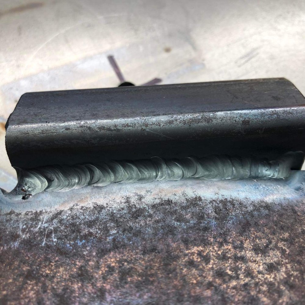

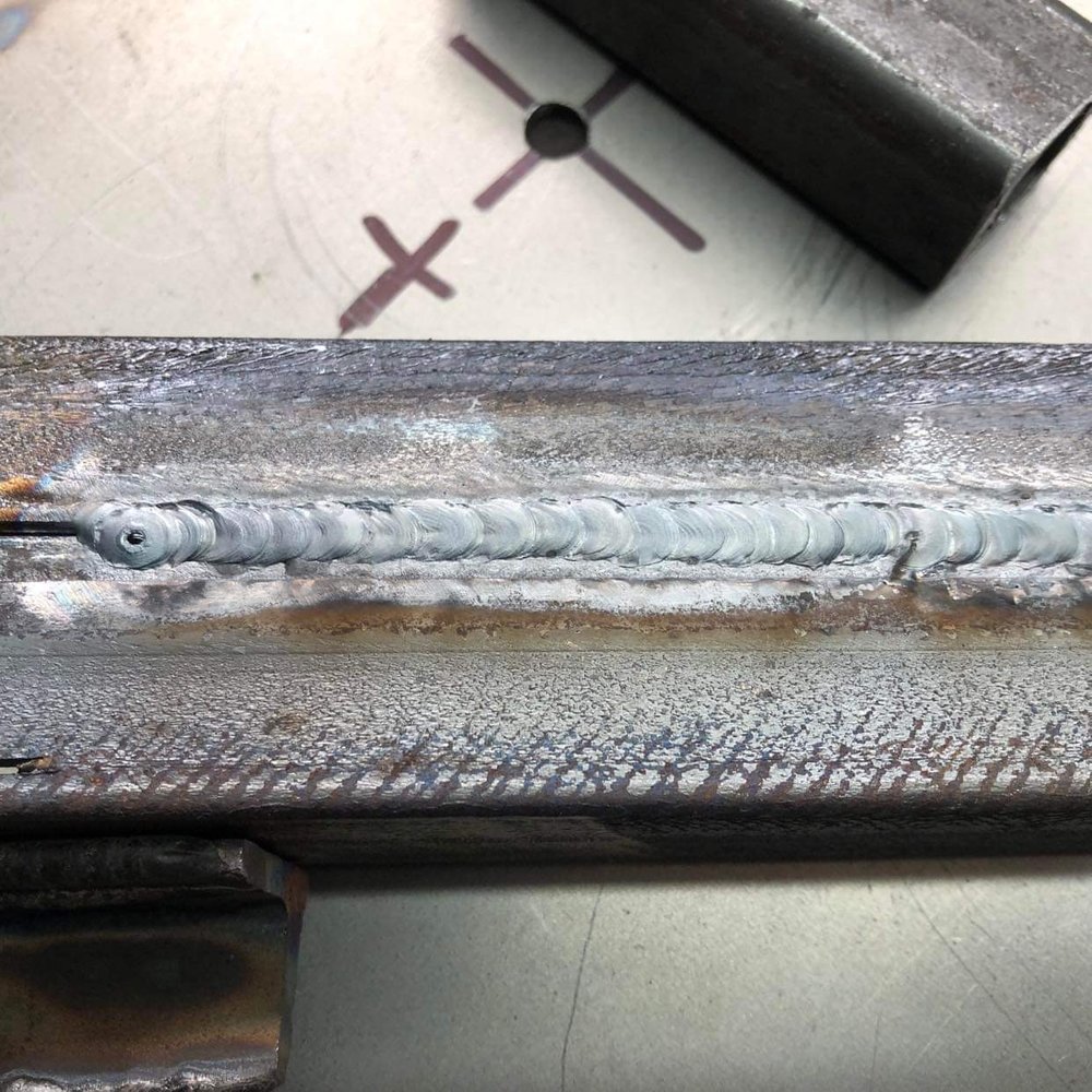

Dont get hung up on diameter, I'd be running a 2.4 on that all day long.Today I've made the effort to start practising with my tig welder. And realised I've been using a 2.5mm tungsten instead of the recommended 1.5mm. Swapped the smaller one in, and had a play. Made a few fairly solid runs on various thicknesses and it all seems to work better now.
3mm angle iron.
2mm plate to 3mm box.
All I need now is more practise. Lots of it.
Welding ordinary steel is deceptive, it's the easiest TIG that can be. When switching to stainless steel, there will be a big difference in weld penetration, weld pool control and filler rod insertion. And yes, I put all my 1.6 electrodes away. I do not see the need for them when welding 1-4 mm, diameter 2.4 does an excellent job.Today I've made the effort to start practising with my tig welder. And realised I've been using a 2.5mm tungsten instead of the recommended 1.5mm. Swapped the smaller one in, and had a play. Made a few fairly solid runs on various thicknesses and it all seems to work better now.

I was also using the 2.4mm on the 1mm steel dummy fuel tank I made last time I cracked up the tig. It went well when the fit was perfect but pretty rubbish if there was any gap.Dont get hung up on diameter, I'd be running a 2.4 on that all day long.
