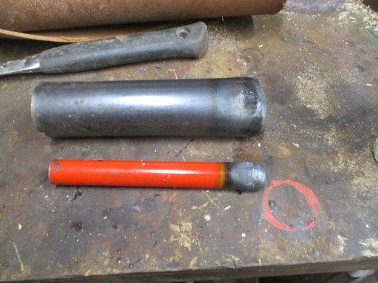

What is itToday a parcel arrive from Poland, the contents as per pic below.
The part number does not come up on the Metrol site because it is seemingly made for Mazak. Because of that I had no idea what the wiring requirements were so I opened it up and found it required a 24v, 0v and the output was +24v. Sadly that is no use for my control so I had to snip out the wee circuit board.
I then metered the wires into switch pairs and LED pair and then was able to wire them all in series.
It is now back together and working like my control needs, the input of my control is sourcing so the 24v comes into the brown wire from the Input and goes to 0v via the blue wire.
Now ready to fit if and when I need it
