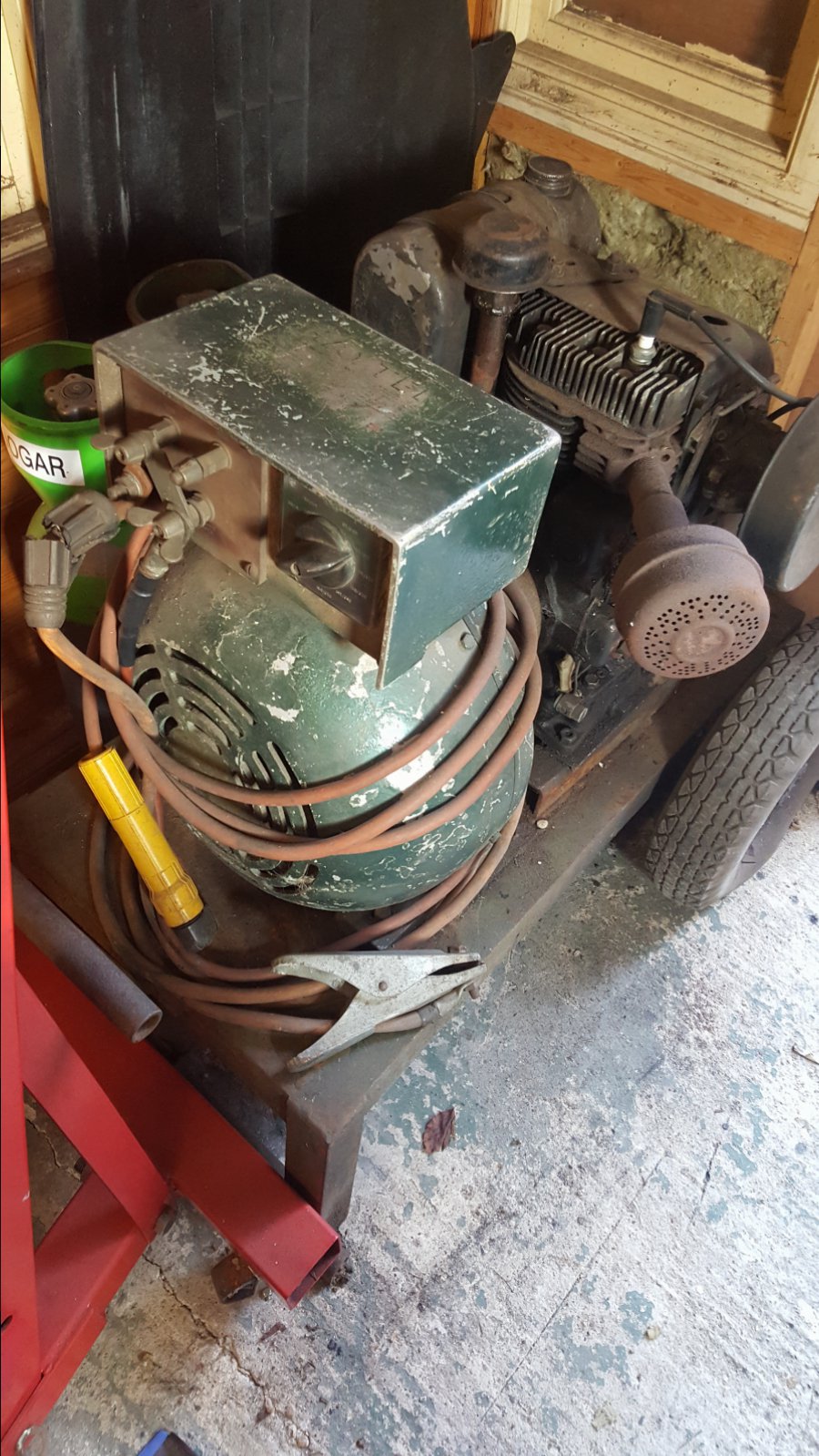

It's a known killer of those mighty midgets to fire them up with the leads cooled round the alternator like that. The magnetic field in the cables can demagnetise the rotor causing it not to generate.
