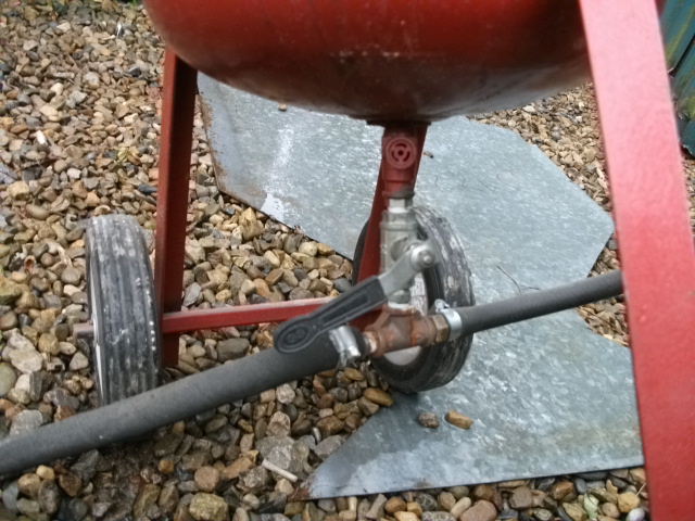

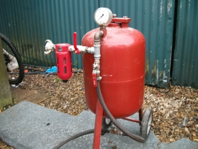

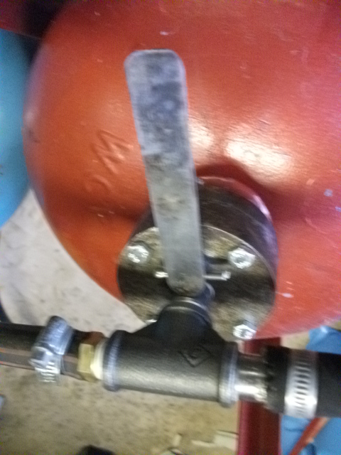

I have BIG problem with my homemade blast pot. It continuously sucks a hole in the media, I have 2 water seperators on the system. The main reason is likely moist in air. I tried with aluminiumoxide and normal blasting sand "yes the forbidden one". and the same thing happens.
Does the shape of the pot have any influence on the result, my pot is a old 100l compressor tank. That is very flat at the bottom. And its a bit rusty in the bottom where the sand is!
