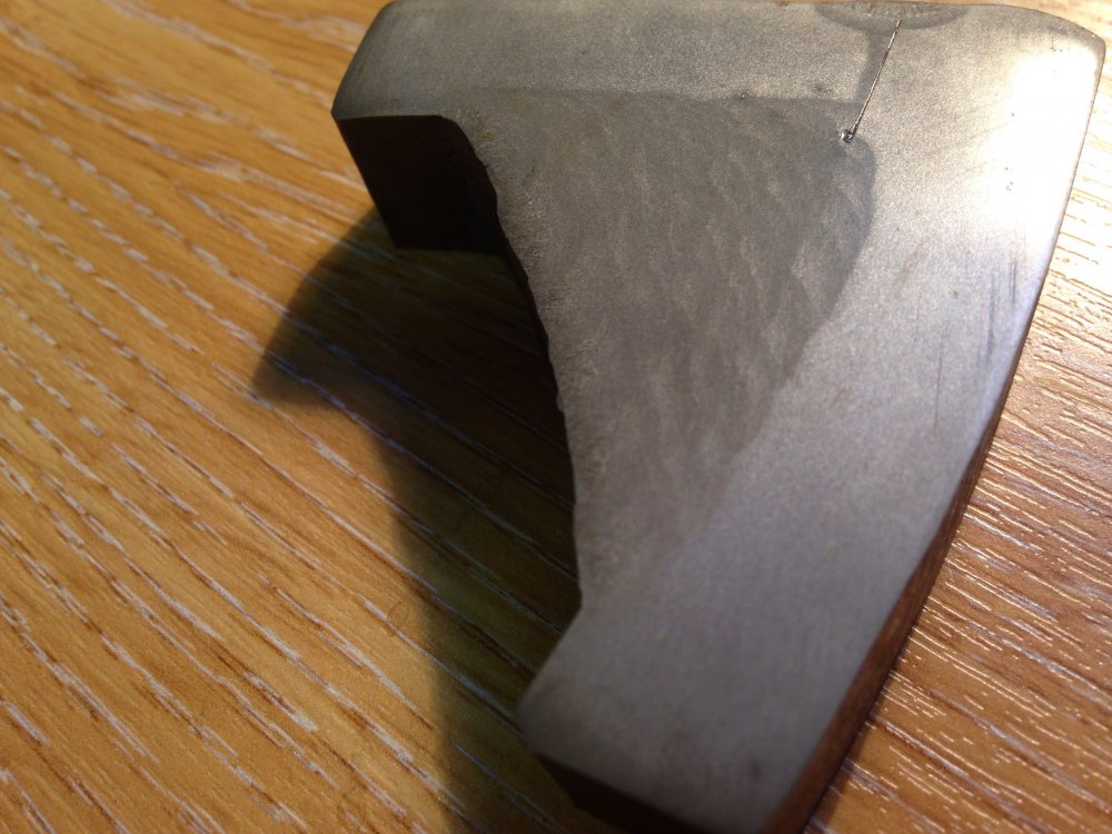

It's hard to tell from the pic but there does look to be an inclusion there.

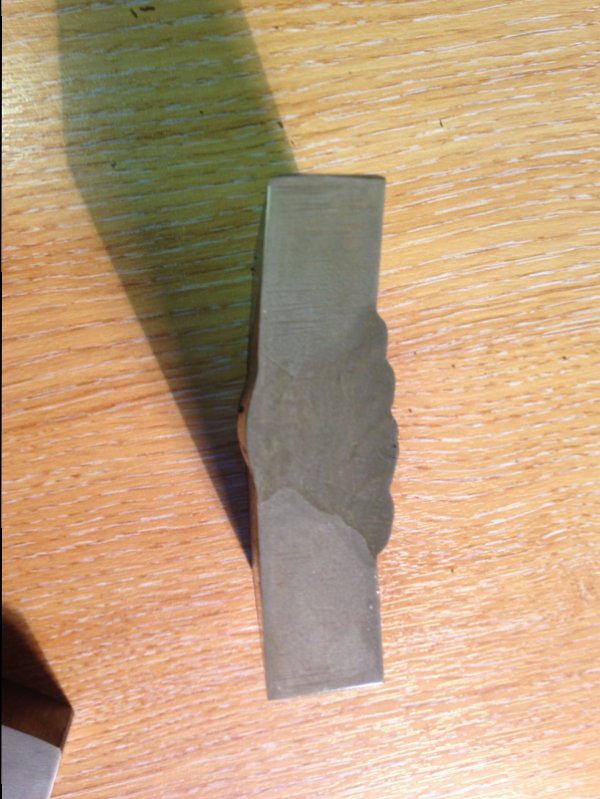

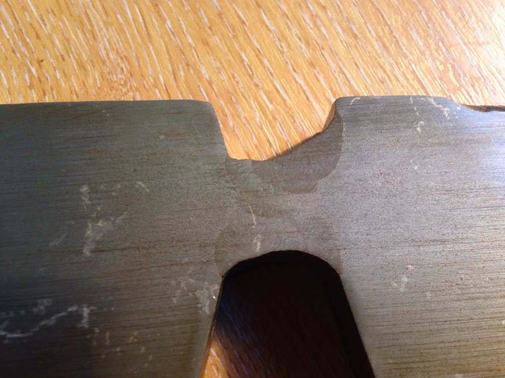

I always etch with methanol and 15% nitric acid. (Do not add the acid to the methanol) always the other way round.
I will put some of my etching with this solution up so you can see
